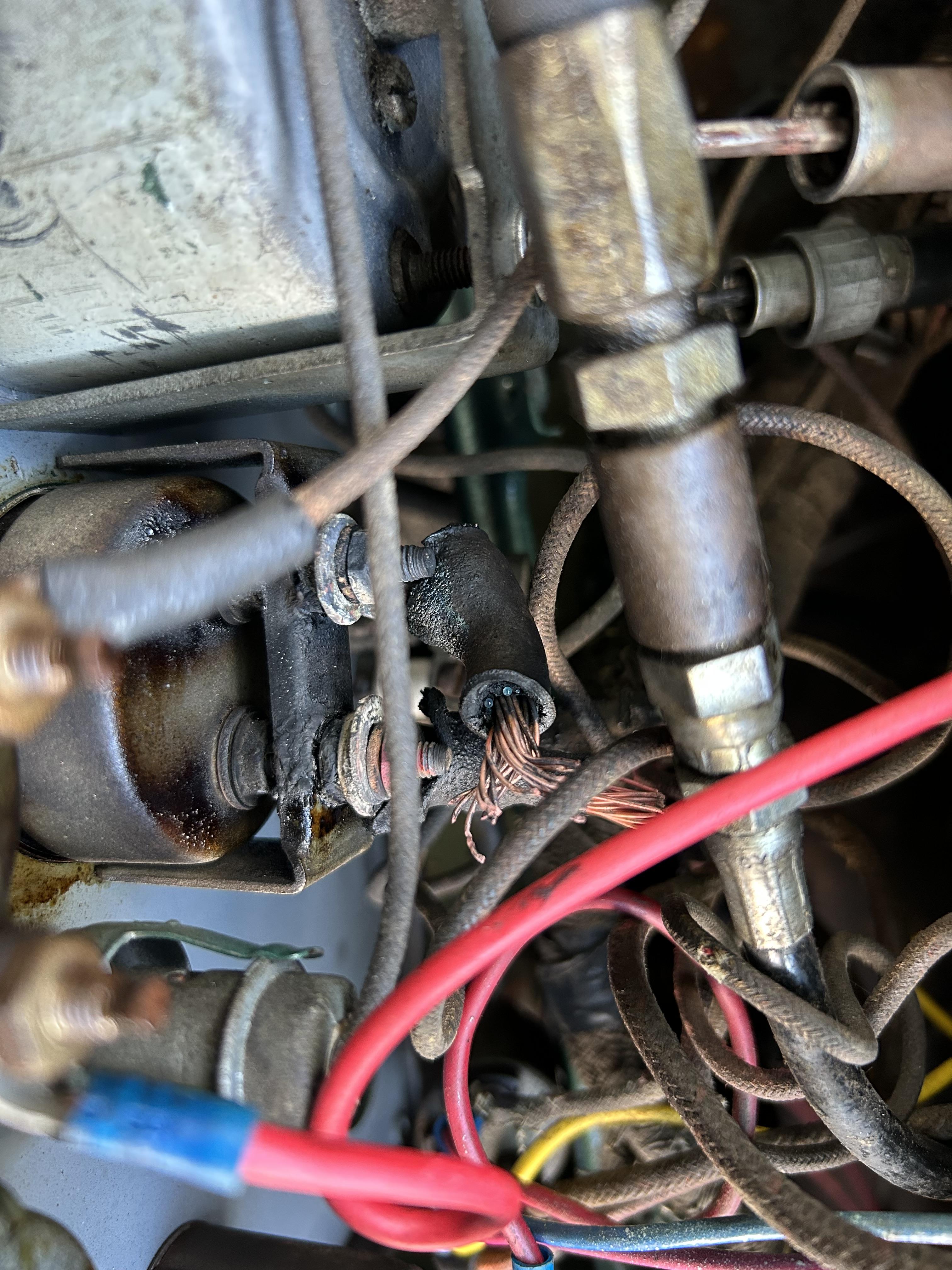

  5. The hottest spot was at the gauge it burned the wires halfway to the alt and out to the block on the firewall but not to the breaker at the back of the headlight switch so I’m thinking faulty gauge . I cut all the harness apart and only the heavy wires burned I’m only running a volt gauge now so I don’t need to go the the gauge with heavy wire then back out again I’ll just go to the breaker on the head light switch
  6. Went to Watts show this past weekend always a good time tons on trucks there a big thank you to everyone at Watts for putting on such a great show . Well on the way there I stared smelling something from the b model and I couldn’t tell exactly what it was but once the cab filled with smoke I figured I better pull over ended shutting off the batteries and ignition and got to a hardware store to get some tools pulled the dash out and found this amp gauge burned to a crisp I’m just glad it didn’t burn to the ground … think I’m just going to go with a volt gauge this time

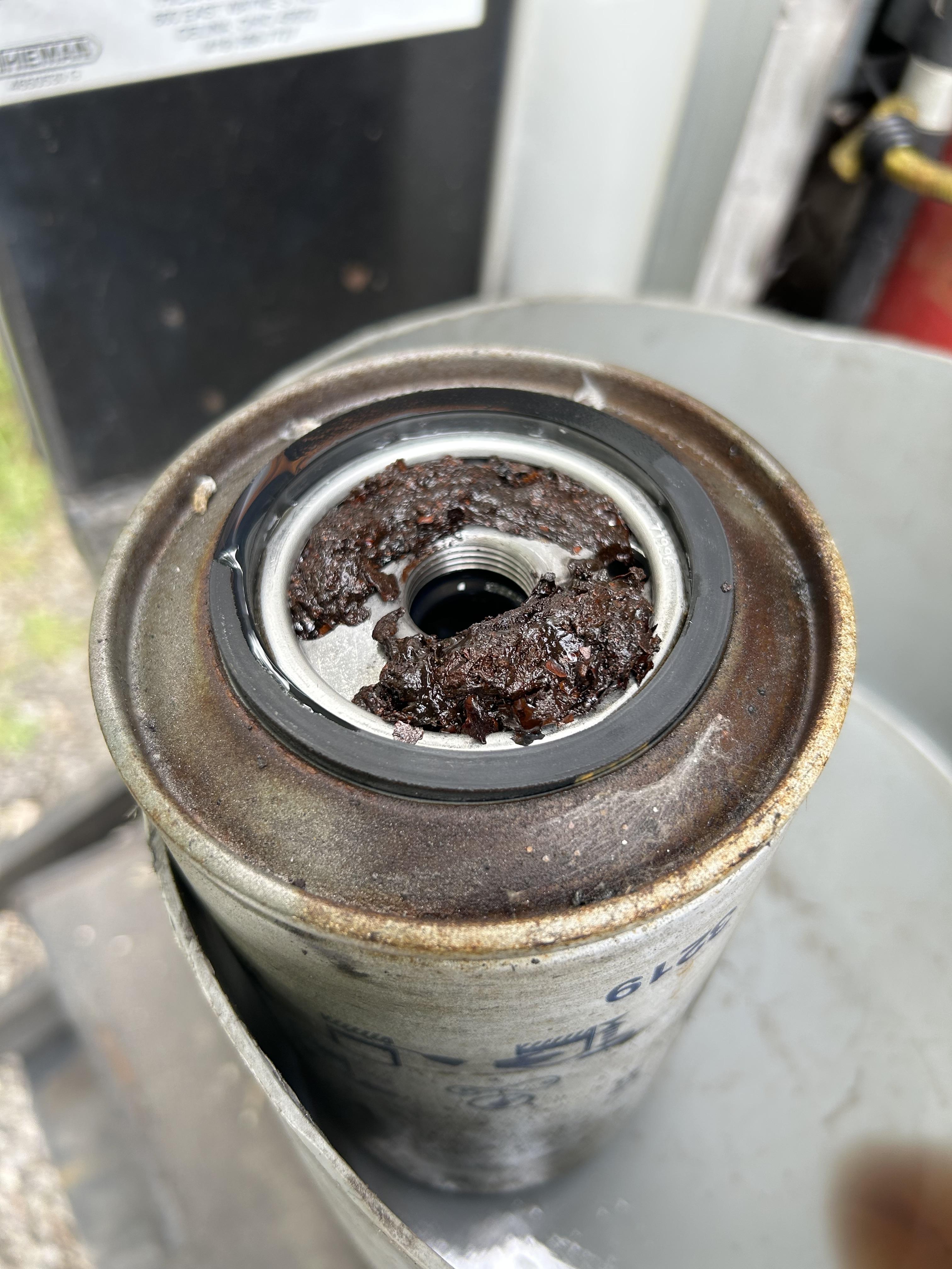

  9. I might need one the truck ran good I had washed the tank real good just must have been the loose stuff I couldn’t get it is thick and has all but one hole blocked off . The canister one looked good and clean could see clean to the bottom
  10. Doing some repairs to the mack before Watts show and I decided to change the fuel filters put them on new in 16 when I was putting the truck together should have checked them earlier how the hell was this even running

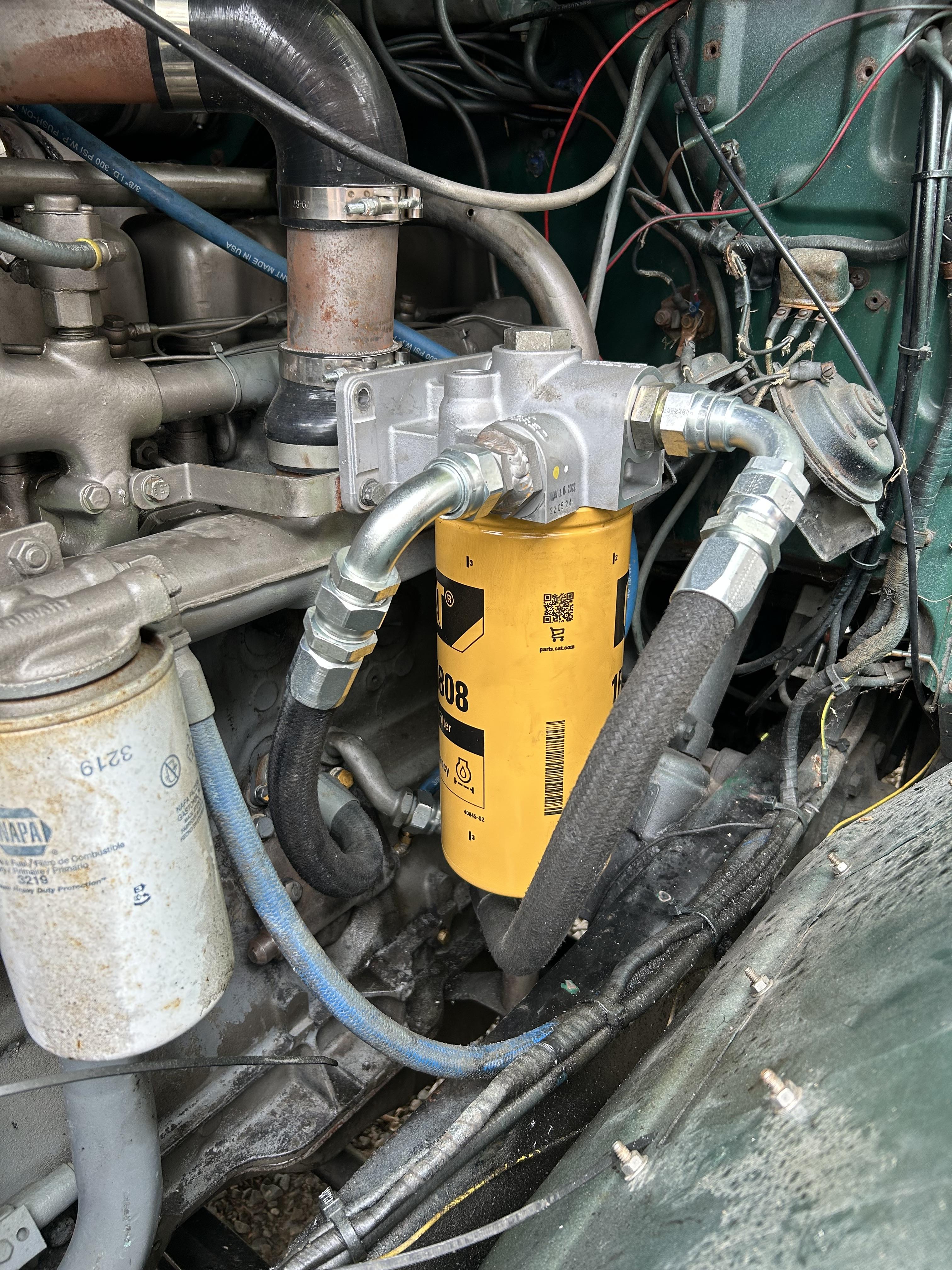

  18. DCW no I didnt I just have pump supply in and clean oil out my original by pass way the tiny line to dump back to pan this filter housing has a spring and plunger in it so if the filter plugs or oil is cold it will go around filter and still supply engine with oil I figure dirty oil is better than no oil
  19. I know it’s not original but finding original parts is getting tough so I figure if I can put new parts that are available and they work I try it out my next project is trying to find a freight liner fld or super liner axle with budd or hub pilot wheels to put under the front but I haven had much luck and what I have found is a little out of my price range for something I take to car shows
  20. Thanks mechohaulic I’m happy with it I’m just glad it has oil pressure when I start it . That hose is like that cause the pipe is round but the intake manifold port is some what oval so it distorts the rubber and it’s 2 different sizes so there is a step in the rubber there . It has the crimped together manifold not tahr cast one cause I added the turbo
