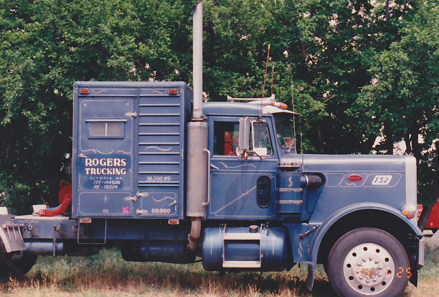

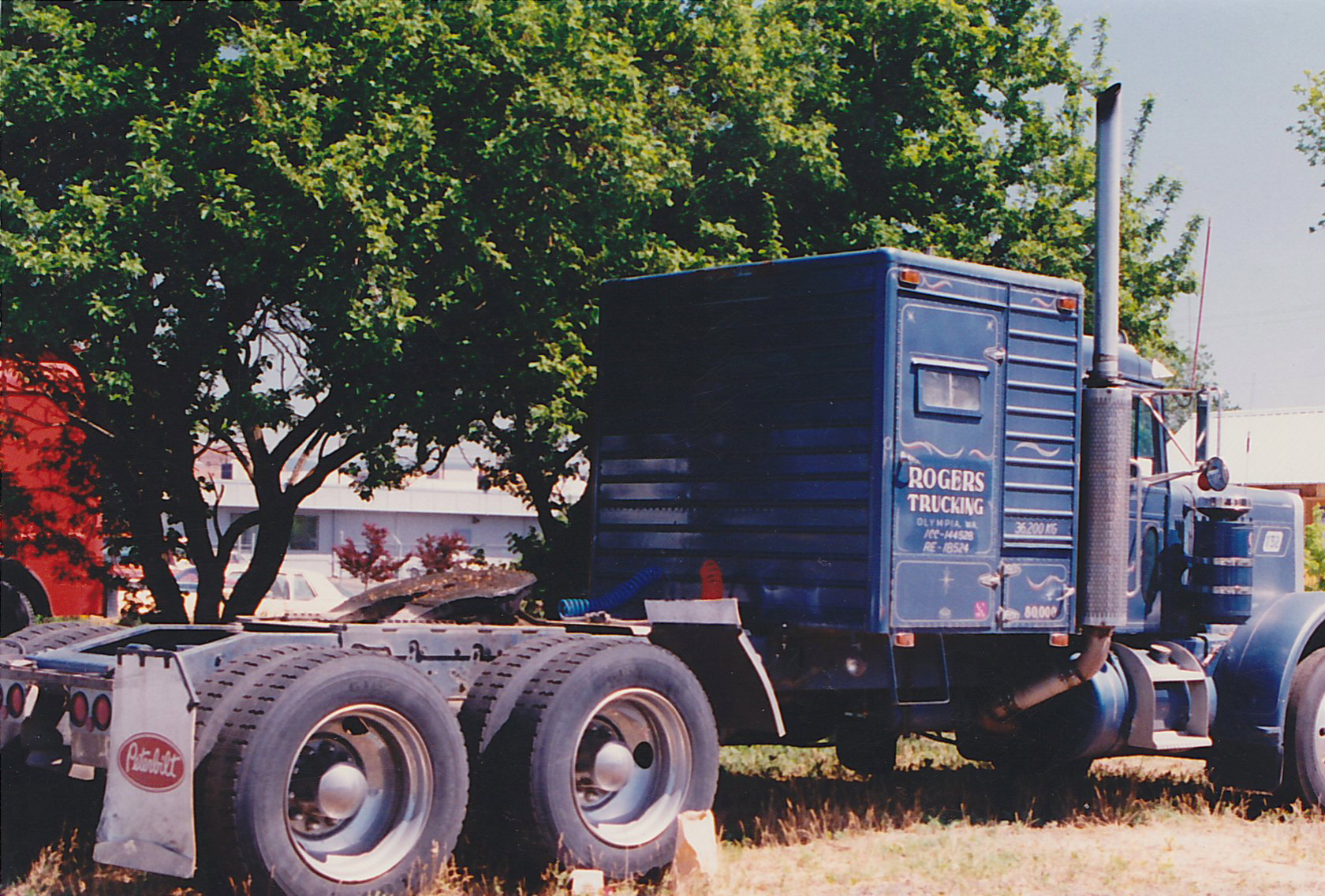

I owned this back in the late 80's early 90's. 1966 tilt hood, tilt hoods came out in Oct 66. BCIII 400, RTLO15713A, SQ100's on Pete air leaf with 82 outside frame power steering. I was the second owner. I drove it for a while then put a driver in it and I went back inside the shop. It was nothing special. Truck Shop
