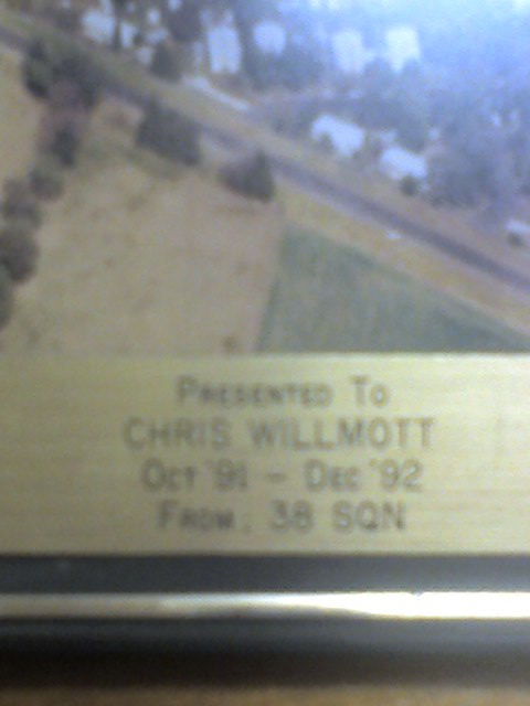

  22. We had a machine when I was in the RAAF called a pentagraph. Basically it was an oversized version of a sketch-a-graph like were around in the 70's. Every second kid had one. Except it has a motorized tool tip in it for cutting brass, steel, plastic etc. If you can find one and give them the original decal plate, they can make an exact copy out of the original material. The black with white writing type plastic plates are actually 3 layer laminated plastic, white sandwiched in between 2 layers of black. The guys made a brass plaque for my Daughters grave in Darwin with one. Very professional job. Try hunting around the yellow pages for signwriters or something similar. Guarantee if they know what they're doing you won't pick the difference between a copy and original. This is a 3" x 1" plate on a presentation plaque I got when I left the RAAF. It's actually black plastic laminated with a brass finish plastic. Anything can be pentagraphed though. Sorry about the clarity of the pic though, only had my phone to use.
