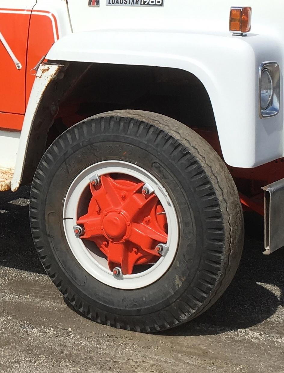

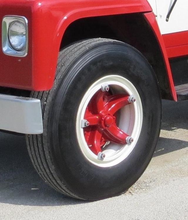

  1. I didn't have to go to far to round up pics Rob. I just had to walk out back . lol Normally I would take tube tires off and replace with tubeless. But the old international gets about 2 mile /gal . And our gas is about $ 5.25 gal now. So the ol binder won't be going far . So I left the 10.00 - 20s on . To bad someone wouldn't build an electric truck . lol I didn't get a chance to thank keith s for sharing his build . Thanks so much Keith , Its very interesting thread.
  2. I'm not sure if this helps. Red hub is 11R22.5 with tubeless rims . Orange hubs are tube type 10.00 - 20 's My 2 cents. Everyone is giving good advice . Tubeless is the way to go. They are easier to buy and , a way easier to get someone to work on them.

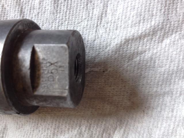

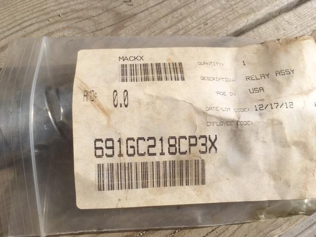

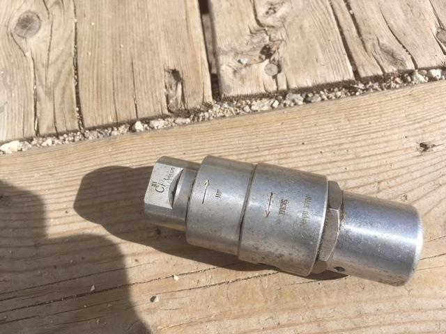

  3. Look at the number on the puff limiter relay valve. What you describe is exactly how my R models perform with a "3x" or a "CX" relay valve on. A EM6 should have a "5x" you could even put a "6x" on it. The part #'s for them are easy to decipher. 691GC218CP6X . The higher the number and X , the lower the rpm to get fuel, but the more smoke . Remember these are mack part #'s , not volvo. I have done a lot of experimenting with different relay valves, and found there is a big difference between them. There is lots of good info on relay valves and setting the rack limiting cylinders up on here. The first pic is a "CP5X" the second pic is a "CP6X" the third was the part # for a "3X"

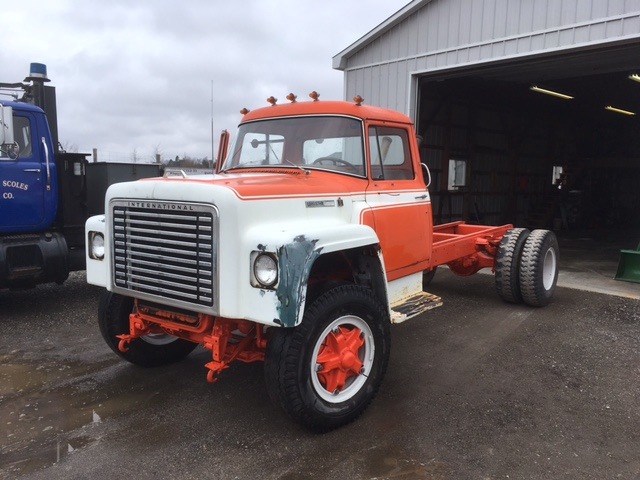

  5. I have been working on my loadstar Sundance and wanted to share some of my progress . After a tune up , the MV404 runs like a sewing machine . I fixed the hood, painted the frame , polished the original paint of the cab . I put a new rad in it , cleaned the interior. I still have to clean up/ fix the running boards and quarter fenders. they are pretty rusty. I am going to clean up and paint the original flat bed and reinstall .

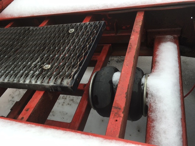

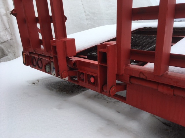

  8. Here is a short video Rob. I think you are 100 % right about the grease zerks. I always thought they should be there . I have seen them on newer trailers. But like you said , they are usually broke or not used . I also think the teflon would be good for the slide. If everything was lubricated ,or able to slide easy , and a pressure regulator put in,. I'm sure it would be easy to find the sweet spot for the amount of air to make it work smoother. (I have a new pressure regulator for this on my bench. Been there for 2 years) lol, my problem is I have too many projects , and too little time . https://www.youtube.com/watch?v=3rg7cQP0KaQ

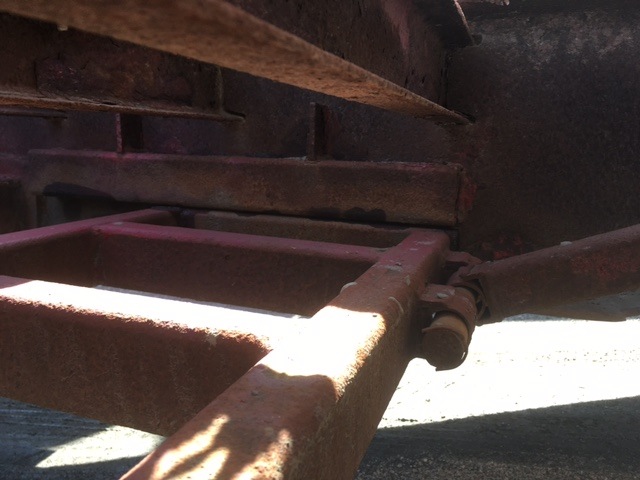

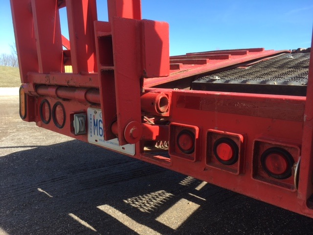

  9. Its no problem getting some video for you Rob. I will get it for you later today. You mentioned the small gap between the hinge pins and the rotating sleeves. When I got the trailer the ramps didn't work very well. The hinge pins were sloppy and things would just bind up . I find the less play there is , the more energy goes to raising the ramps . I've never had any trouble since i tightened things up. To your point of greasing the slide. I actually don't grease it . You will notice no deck boards above it. That way I can wash it regularly. The grease just attracts a lot of dust and crap. For the video I put a bit of lubricant on it. So you can see how easily it can move. With no lubricant you need to give it a little help. (equivalent to lifting 20 or 30 pounds). The reason I like to" help"it , you will see that when the ramps go up . They go fast. If someone was close to them, they could easily get hurt . It actually works really good because the ramps come off the ground. I clean all the dirt off the ramps , then give them a bit of help , then they stand up nicely. My R688st has a 350 4V with an 8LL trans and 4:42 rears . I'm the second owner. Its the original paint on it.

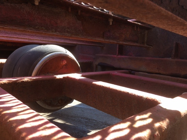

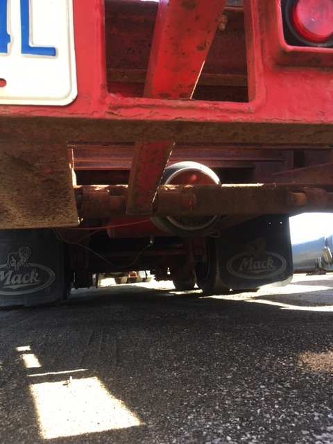

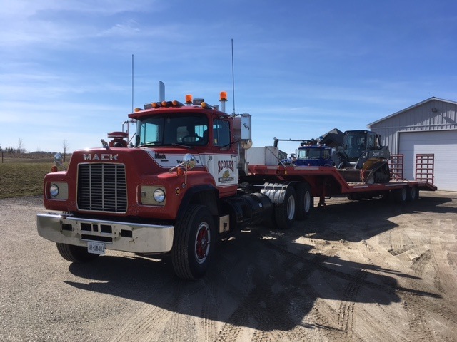

  10. Here some pics for you Rob. It's just a rectangle made from square tubing , sitting in a channel. Has 2 push rods (I will call them ) connected to the bottom of the ramps. I have the air spring # in the shop if you like . Its just a firestone air bag. And if you would like some measurements, I can get them for you. I can't seem to download a video directly. If your really interested I can download something to youtube for you to see. And I have to include a pic of my truck …………………Just because I like it so much.

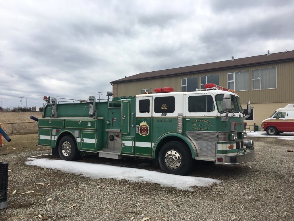

  13. I'm not sure if I got this wrong. A friend sent me this pic of a truck not to far from me ( little over an hour north of Toronto, Ontario). I think ? it says Greenwood , Delaware on the door. I thought we had members from that part of the world. I wanted to share the pic ,in case someone knows the truck and would like to know where it ever went. It has a detroit motor and a standard transmission. I didn't think a standard would be very common . I was told it hasn't moved in years and doesn't run . A fire truck lover is going to try to resurrect it . You can also correct me if I'm wrong about the make . I thought it was a Seagrave, but I could have easily got that wrong too.

  15. I can certainly take some detailed photos for you. (when snow is gone and warms up a little) It is a simple system. Your are right , gravity puts ramps down. As you can imagine , they can come down fast . I release air slowly so they don't come down to fast.
  16. Have you considered air ramps for your project Rob ? I have air ramps that work good . If your interested, I can give you measurements and pics. I have noticed that the new trailers have 2 air bags now , not the single one like mine.

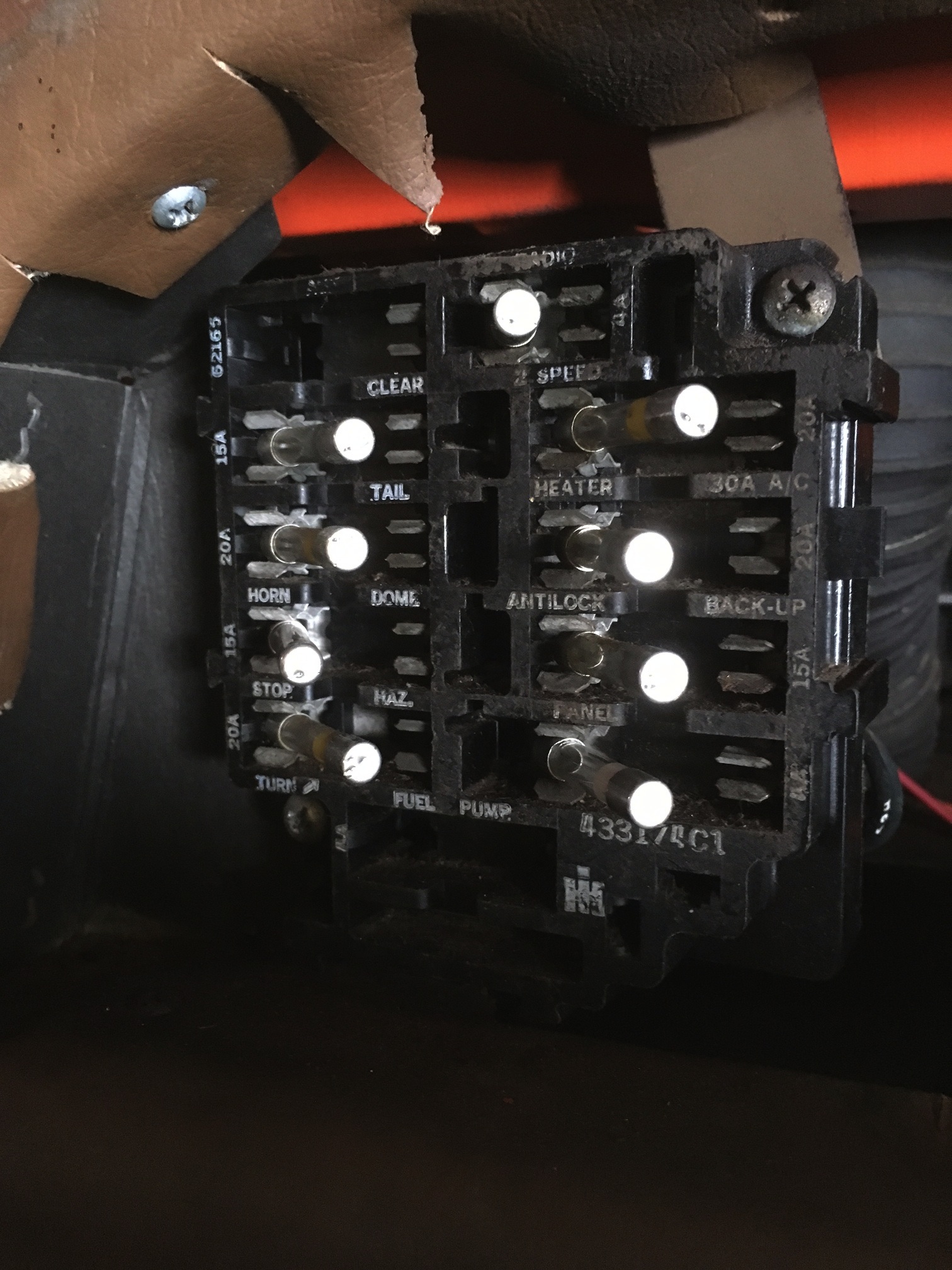

  17. Upon further investigation , there doesn't seem to be any type of fuse off of the starter. So it seems that the protection is from fusible link wiring . Thanks guys

  20. I would say it is around 14 gauge . Everything works fine. Do you think I should leave things alone? Make sure I'm up to date on my fire insurance. lol Or would a fusible link be a good idea on the power line into the headlight switch ?
  21. Thanks for the reply Rob. I had the headlight switch out, it doesn't have the fuse . It appears that the wiring has never been molested with . So maybe it is fuseible link wiring , like you say .
  22. I've been working on my '76 Loadstar, and curiosity has got the best of me. The fuse panel does not have a spot for headlights. Thinking there has to be some kind of protection against a short , I took out all the fuses. With all the fuses out the headlights still work. I looked all over for relays . Under dash and on firewall. Can't find anything. Am I missing something obvious ? I thought I would try the minds here because I know there is lots of binder knowledge here as well. Thanks in advance
