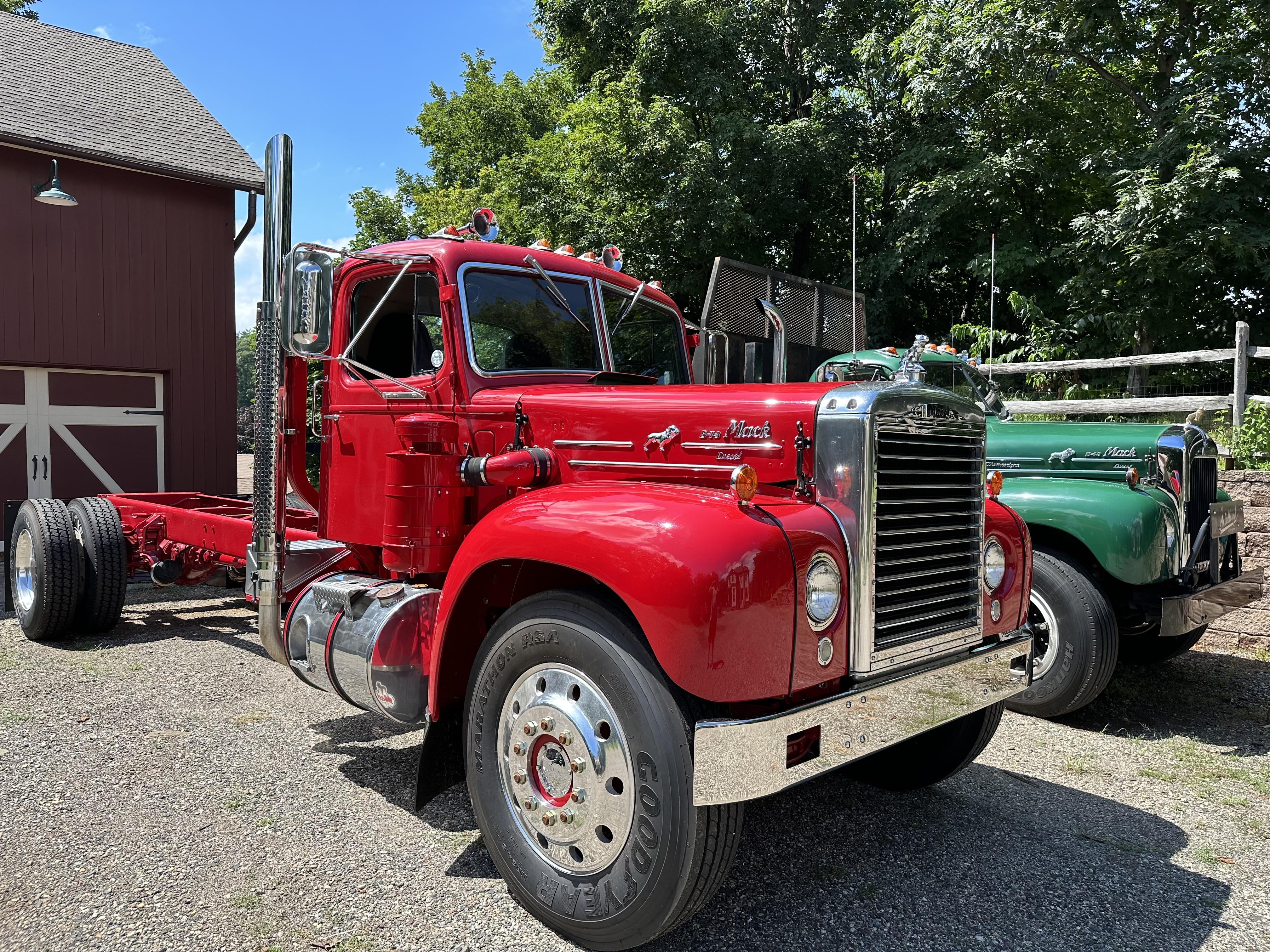

Tail lights are done. I just need to finish the deck lights and add a light for the plate. Took it out for a test drive for the first time since adding the deck on. Completely different ride with the extra weight. Smooth, no hopping around over bumps. Just a few more things to do and I should be onto the deck wood next week, the last big thing to do to it and some small stuff to finish. I added a side shot to the post, quite the long truck, now!! -
