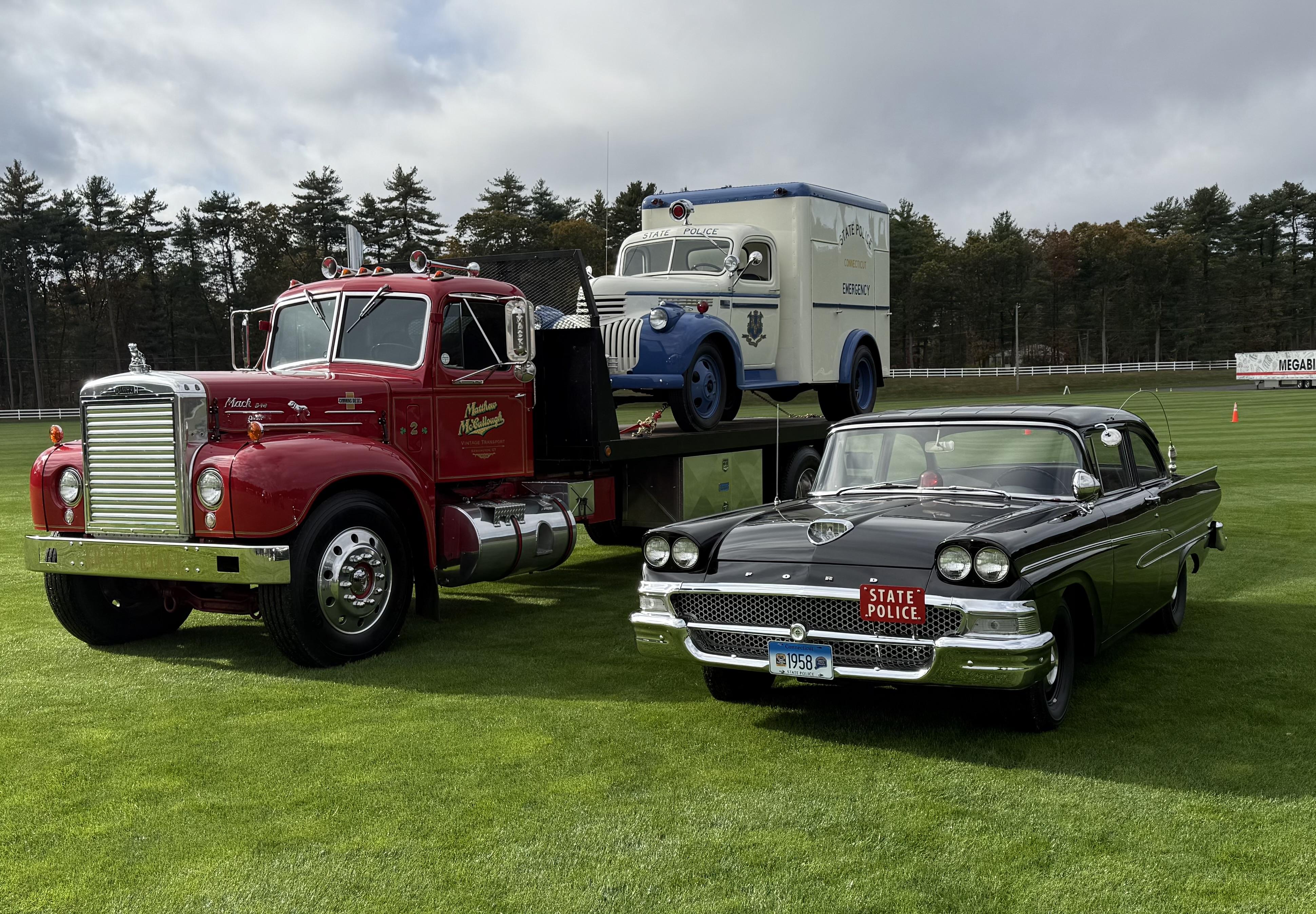

I like the original look, but I always intend to drive my trucks. Sometimes very far from home. Reliability, safety and comfort are big considerations. Tires/rims(radials, 22.5/24.5 sizes), maxi brakes, air ride or spring ride seats, spin-on filters. I've built them to do what I need them to do and to go places and haul my other cars to events and tours. I try to make them nice, but as they're going to get used, they're not perfect. Upgrades to electrical systems like alternators and 12V starters are all geared for repairs on the road, just in case. Getting stranded away from home is a concern, so I try to update things that are common over the counter parts. I also carry some spares with me that might be hard to get, water pumps, small parts, things that might be hard to get on the road. I'm not big on a lot of chrome, but I do add some and try to keep them close to period looking.
