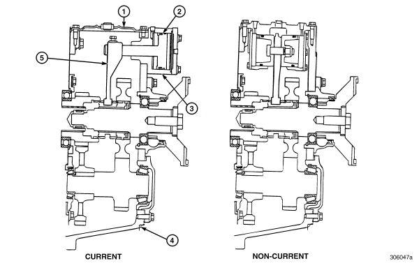

Maxville Truck replied to sully66's topic in Engine and Transmission
I don't know for sure... however I do know that their has been some updated shift cylinder "kits" for those transmissions, If you give your Vin to your local Mack dealer they should be able to determine if your cylinder could be upgraded, That back cover is pretty easy to remove and put back on.. and pretty easy to repair. just orings inside. we had one get sticky pulled it off took it apart it had rust , I guess from system moisture.. the rust had accumulated, and tore the orings up, I cleaned it up nice, installed new orings and a little grease, Problem solved. -
T2060 Will Not Select High In 85 R686
Is this the long or short back box? If you have the long rear box then you have a plain "tin" cover on the rear box with the shift cylinder sticking out the rear top of the rear box.... parallel with the drive shaft. the short rear box has the shift cylinder built into the underside of the top cover. My guess is you have the long rear box with the neutral shift out air switch in the cab. for a multispeed rear PTO. what " may" be going on is it is hanging in the neutral position because of bad o rings or corrosion in the air shift cylinder. -
