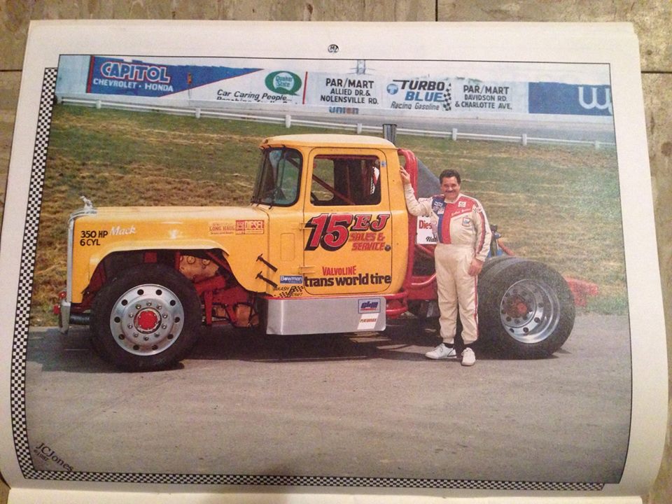

  3. When he went to the single axle he was running a 2 stroke drip monster.

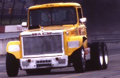

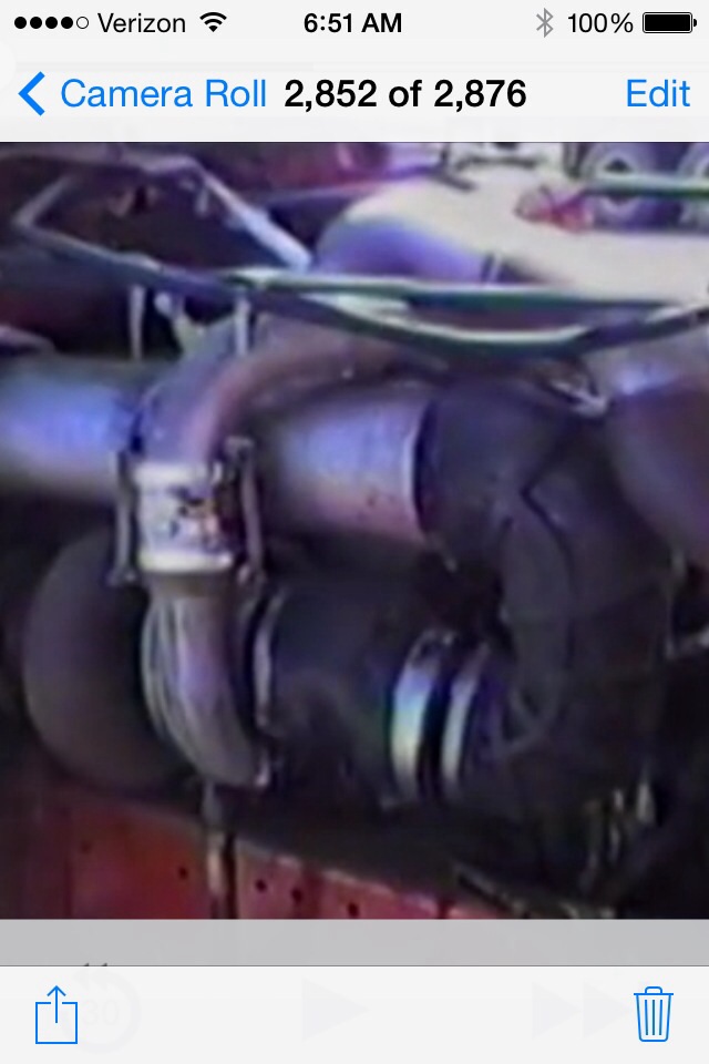

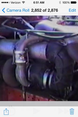

  4. Only pic I can find of EJ Utly twin turbo e7

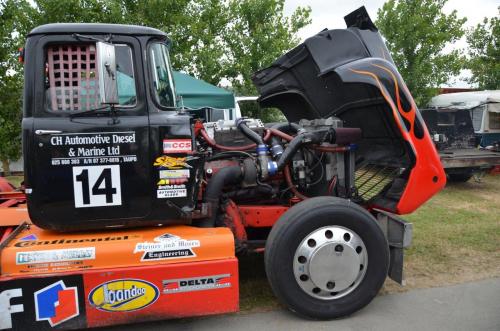

  6. On the race truck there is a air cleaner on both sides twin turbo
  7. That truck is in the New Zealand super truck race series.
