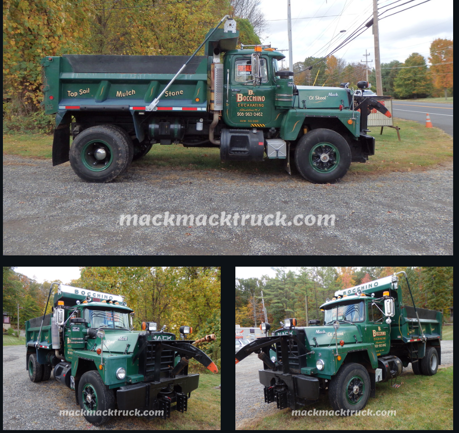

  7. Is this the one that we followed along as it was built? https://www.overdriveonline.com/custom-rigs/article/15042831/longtime-diesel-mechanic-builds-oneofakind-1960-mack-truck
  8. Here is another one on Mickey Delia's website. https://mackmacktruck.com/mack-pictures.html

  16. I figured as much. I don't do Facebook. Wife does. She contacted the seller and sent me the stuff. I had no way of knowing if it worked or not. Seller would not tell us where the truck could be seen. When I run across something that is only accessible through, Facebook, I generally just keep right on moving. I watched the startup video. It sounded a little rough initially, but smoothed out. Well, as smooth as a V8 diesel gets. I'm betting it's an R615, with the normally-aspirated V8 in it. Looks like a Duplex from what I can see on the shift plate. Light rear springs (no overloads). Does look like a double-reduction carrier. Frame does not appear to have had a 5th wheel on it, unless I am missing something. I can't tell WHAT it has been used for. I would love to have had that single-axle chassis when I had my ST. Would have put that light, single rear under mine.
  17. Got some response. Had one video of it starting and running. Posting what I got. Might work, might not. https://www.facebook.com/marketplace/item/1208157969832910/
  18. I have only seen a handful of steel-nosed R model over here. I think they are more common down under. The only ones I remember were from the oil field industry. Suppose that's why some folks called them "oil field fenders"? NEVER saw a single-axle set up that way. I gotta say, I like it! Would love to see it after somebody like Matt Pfahl or Mickey Delia got their hands on it.
