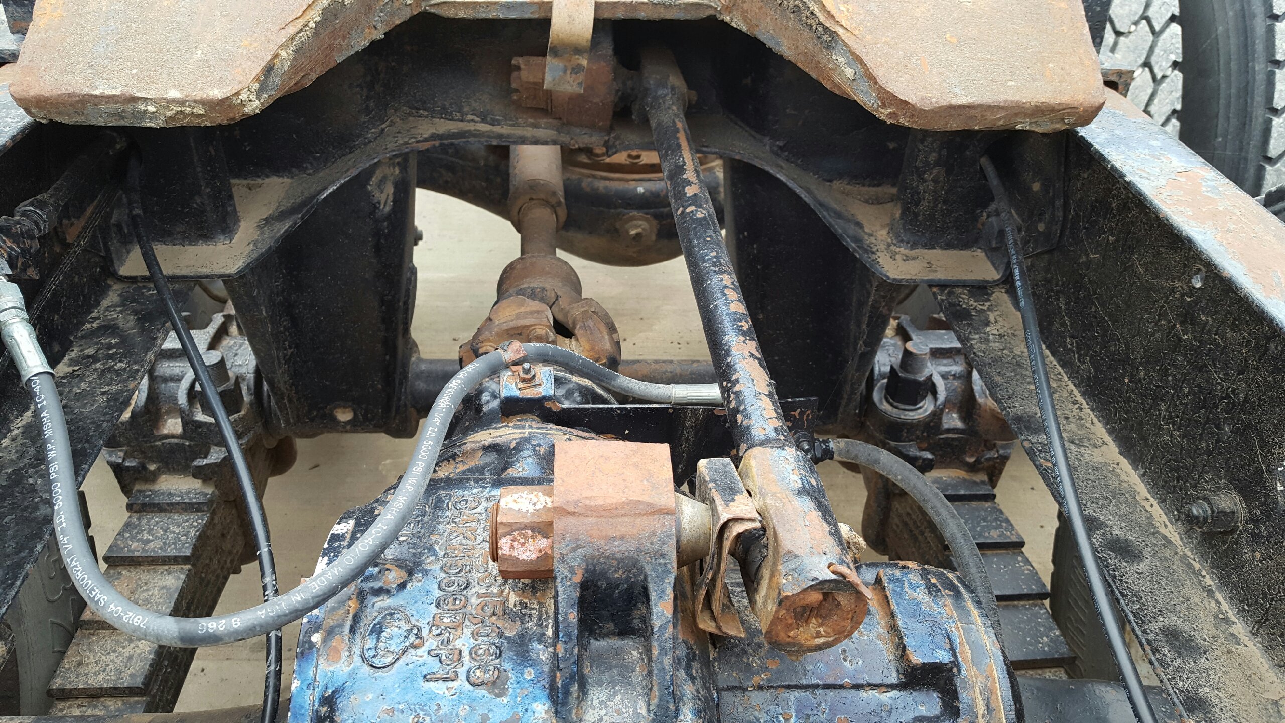

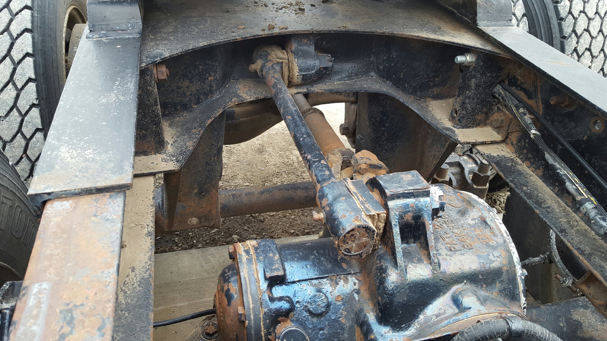

1967 Mack R 685 torque rods
They look like 1RY312 series torque rods. When you contacted Watts Mack at 1-888-304-6225 with your model and serial number about new studs, seats, springs and 95RU32 rubber boots, what did they say?
Using your model and serial number, Watts can reference your truck's 3QK rear suspension arrangement and see the torque rod's component break down.

The truck pulls up in the Mack system but everything but the trunion bushings is NLA.
And the serviceable 1RY torque rods don't supercede to a non-serviceable torque rod, per the current Volvo Group Mack brand parts system.

The front Torque Rod is 17QF323P5 /1RY312P5   24 1/8th center to center
The rear Torque Rod is 17QF323P6 / 1RY312P6     28 3/8 center to center

I have got them here from weldon supply and they are two parts that use a tube that you slide the ends up in and weld to the length you need.
Are the axle mounts tapered like new ones or are they straight?  I tried Stengel and they asked me that question.  I know on the other trucks that I have done the torque rod ends were tapered not sure how they would work if the ones I have are not tapered.
They are tapered studs. I would think, from that link, once you confirm the stud size having removed them, they can help you.
