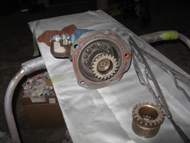

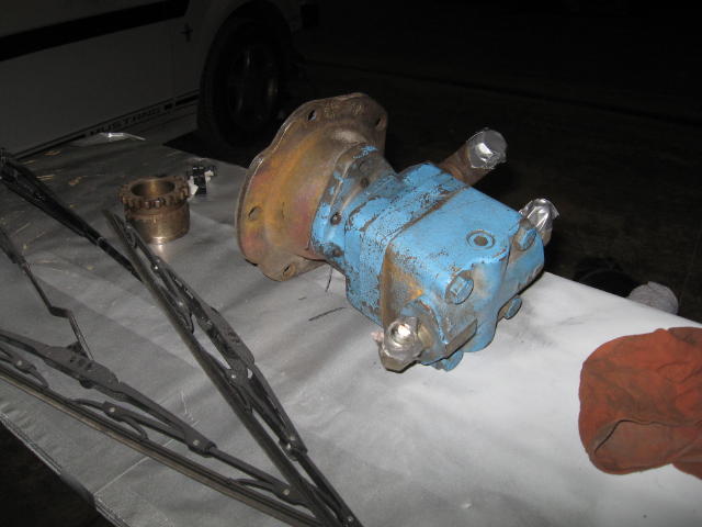

I acquired this p/s pump from a guy with a blown 8V-92 for my 12V-71 transplant. I'm getting very close to the actual fitment process now as I've got nearly all little parts needed. I had a direct drive pump with a self contained reservoir attached to it, and space being a real premium at the firewall, could not use it. This pump uses a remote reservoir and should fit nicely driven from the left camshaft viewed from flywheel end of engine. There is also no room to direct drive the air compressor, so it will be mounted on top of the engine, and belt driven also.

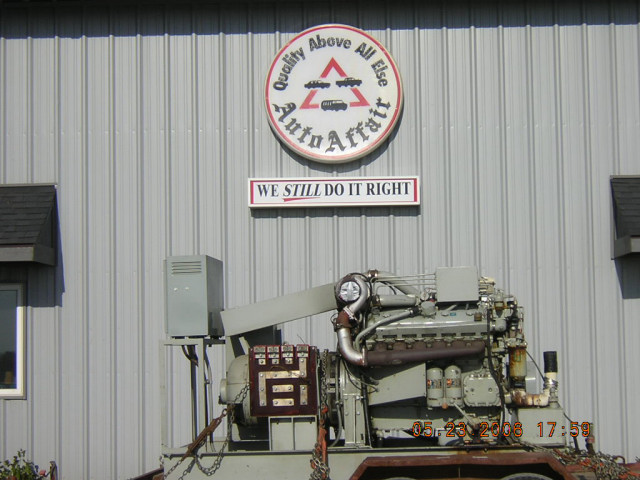

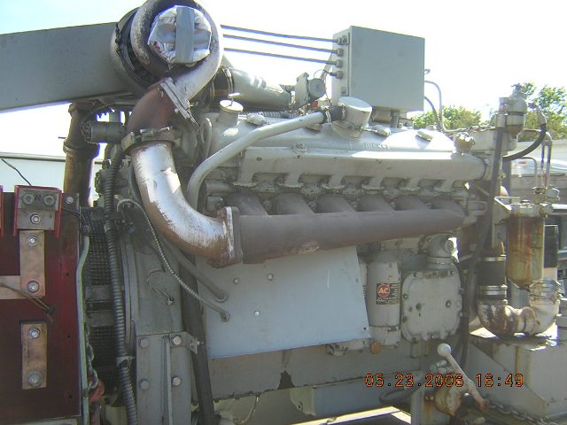

Here's a couple photos of the genset in front of my shop when I brought it home. The 12V is now replaced with an 8V and the 12V has an SAE #1 flywheel housing installed. I think it can be seen about the orientation of the turbochargers to the flywheel housing parting flange in the photos. May have to move the engine and transmission a bit forward in the chassis to make it fit/function correctly. Won't really know that until everything is ready for "dry fit".
