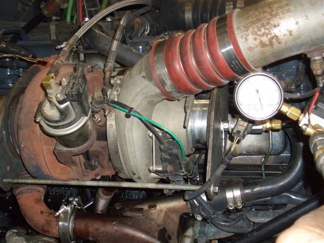

Below is the tool we use to check THE WHOLE engine for boost / exhast leaks and other wierd and wonderfull failers ,turbos passing exhast gas into the base
boost bypass valve failers egr coolers leaking into coolant all can be tested in one operation with this tool on ANYONES engine for the most part,
we built this as I said before ,doing the best with what we had avilable. we use it almost daily.

Not to toot our own horn but that is why we built the boost plates in the picture I tests the Whole engine charge air system. that leak would have showed it self in an instant and probably more of them!another fairly comon leak on these engines is the inlet and exshast gaskets.
