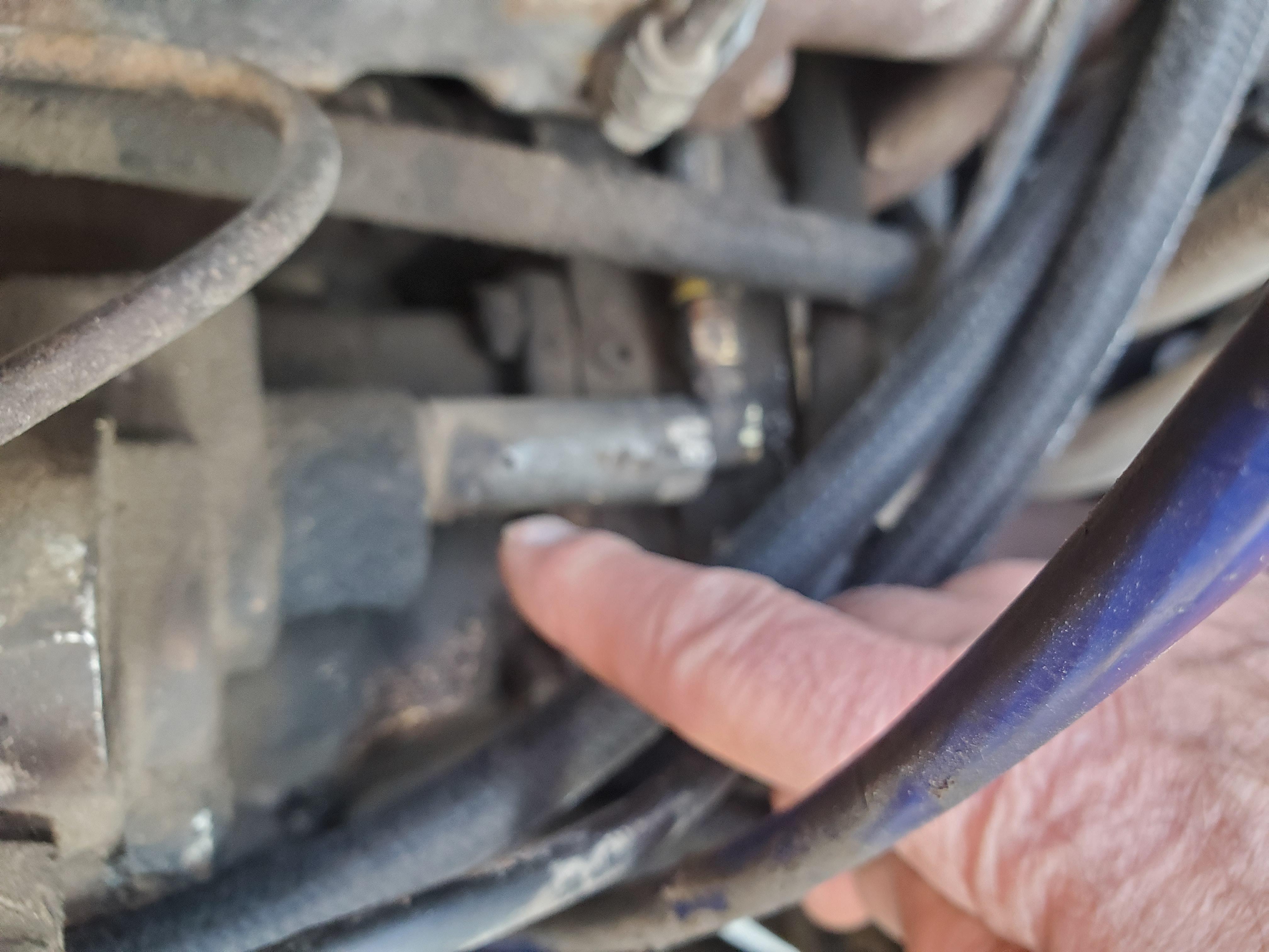

I csn try and look at it when I get to the truck tonite.  Not sure how I would tell.  What should I be looking for as far as the difference.  Like I have stated I'm not really a heavy diesel mechanic.  I can take a pic and upload it
