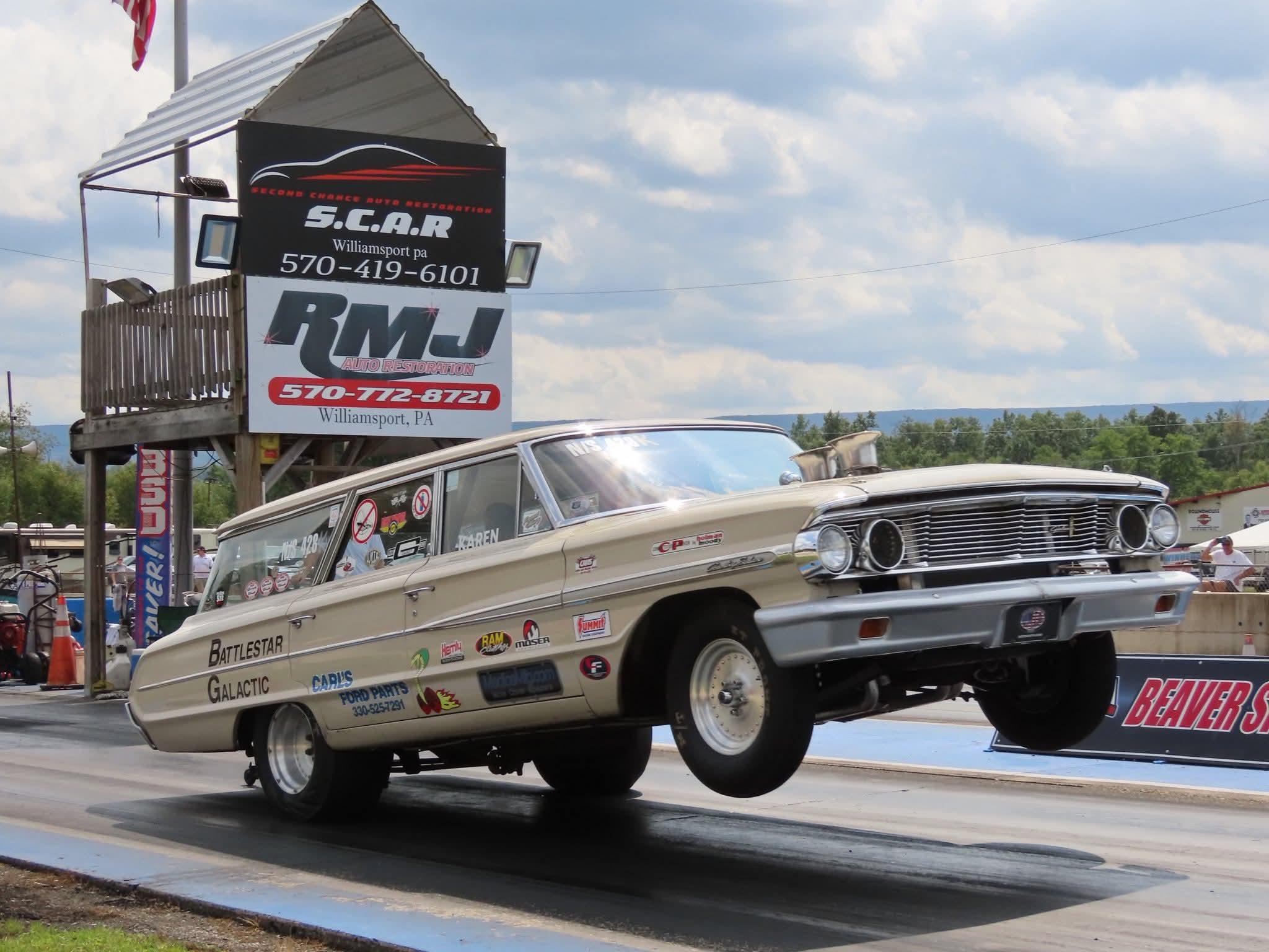

Went over to Beaver Springs last Thurs for the annual FE Reunion.  I won the Gamblers race on Friday.  Yay.  Didn't fair as well in the big race on Saturday.  Had a great time overall.  Saw lots of old friends, met some new ones.
