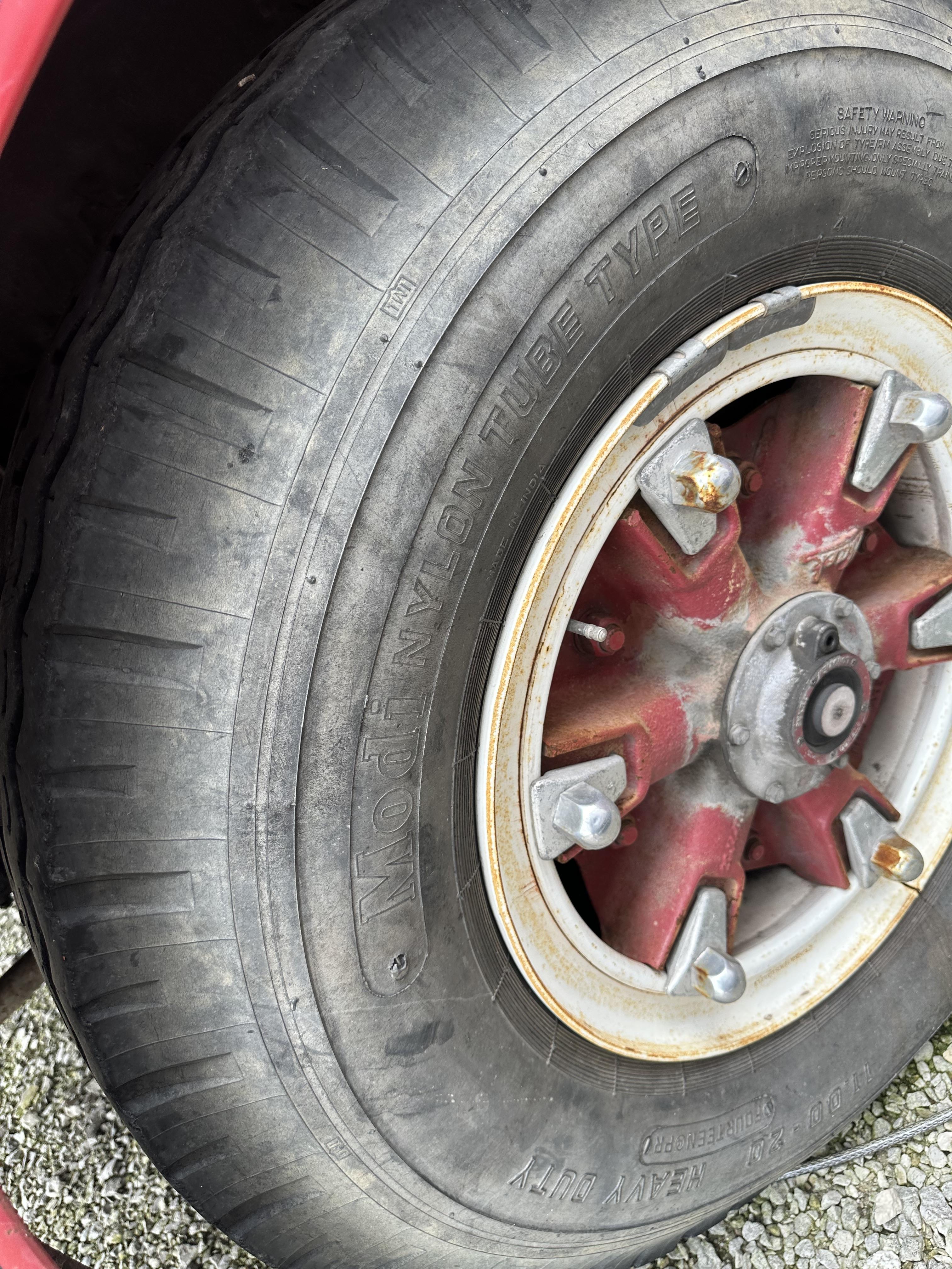

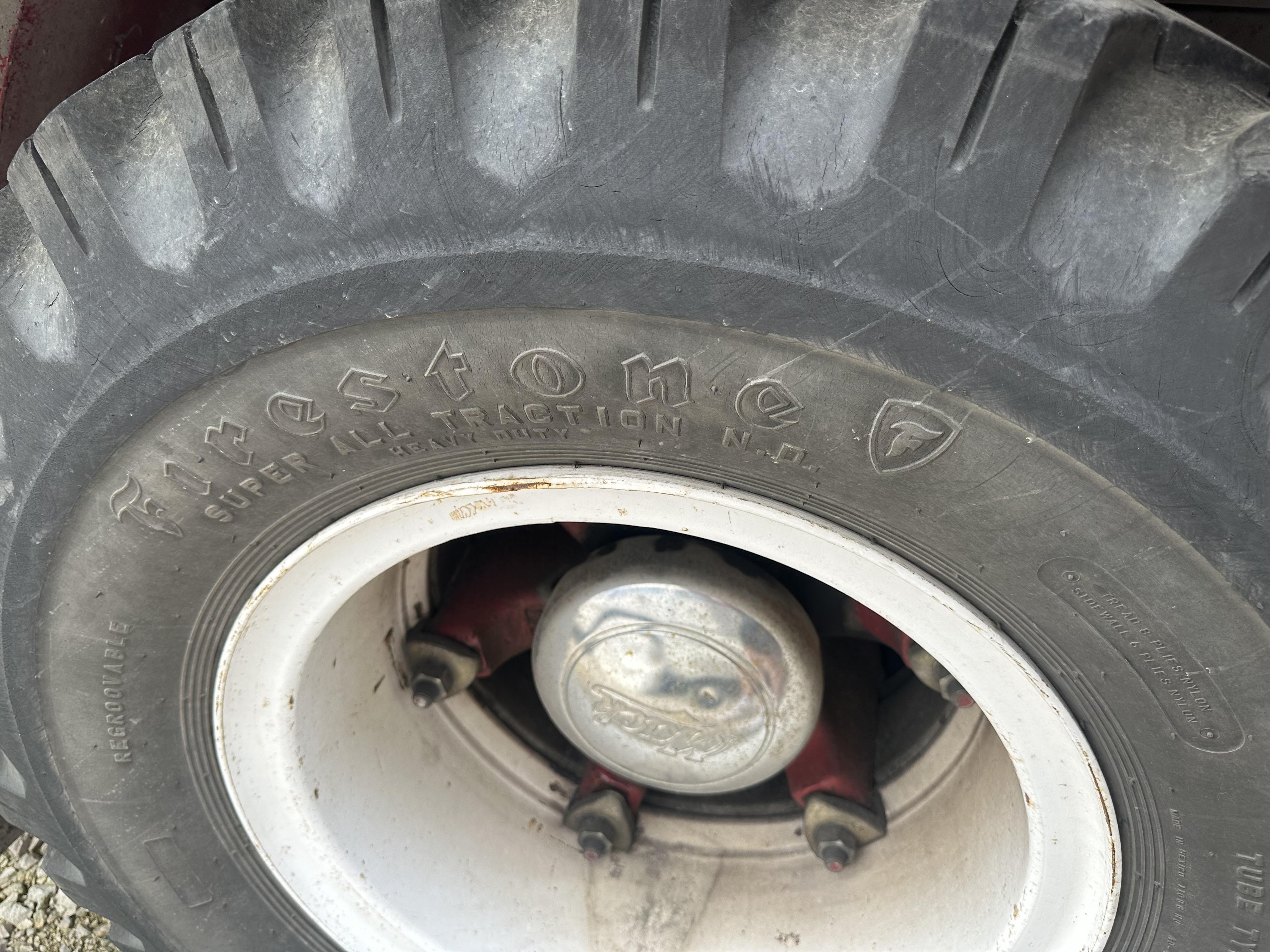

The biggest thing I want to get sorted a the current moment are the wheels and tires. Like most other Mack apparatus at this time, it has 20 inch Daytons which now sport a very outdated and hard to find tire size. All of them are currently 11.00-20. Tread is getting low and they are starting hairline to crack. Searching around me for used options brings up a lot of old and worn out tires that I wouldn't feel safe putting on this rig.
Through my research it seems as though I can have a shop swap out the 20 inch rims to 22.5 inch rims while keeping the cast spoke center, opening myself up to more tires and going tubeless as well.
Anything I'm missing here information-wise? Is it as "easy" as swapping for the 22.5 inch rims and finding 11.00-22.5 tires?
Thanks for any help, this style of wheel is completely new to me as our modern apparatus don't sport Daytons (obviously).
IMG_7067.thumb.jpg.0df1c77362f1588f1c30377db6b404a4.jpgIMG_7061.thumb.jpg.c191f7d407b0bee1b33c28241be9d1b1.jpg
12x 22.5 would give you the same tire size (circumference, load and rev/mile) as 11.00 x20)  Likely need 9" width rim to run that size.  11x 22.5 would be one step down in size and load capacity.

Again, when changing from tube type to tubeless, you add one to the "size" so 11 tube type becomes a 12 tubeless and you add 2.5 to the rim diameter. So a 11x 20 becomes 12 x 22.5 to remain the same.
 20" spokes can have 20" tube type (flat based) rims or 22.5 tubeless drop center rims.

I found a shop near me that keeps the 22.5 inch Dayton rims 8.25 width in stock and they should be getting more in about 2 weeks. I found a chart online that says a 12x22.5 tire is approved for mounting on a 8.25 width rim, but I'm curious why you think it would need to be a 9 to fit. Don't want to get the wrong rim and not be able to keep the same tire "size".
Thanks for all your help on this thread.
8.25 rims are generally limited to 7k lbs, so if you want the full weight capacity of the tire size, you need the wider rim.  Most often tires have a "spec" rim size and "acceptable" rim size which is often 1 size narrower or wider than the spec rim. So if you aren't going to load the rim above its limit, then 8.25 is fine if it is shown as an acceptable rim.
