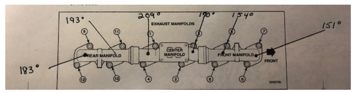

I used temp gun and attached are the temps at engine idle.  It's obvious the front cylinders are significantly lower.  I was initially thinking it could be an injector, but wondering if I should lift the front valve cover just for a visual inspection.   Just looking for some guidance.

No and probably won’t  attempt it . I am trying  to get a feel for what or how to diagnose the problem . I just hate taking it In with no clue ? Im sure it involves the two front cylinders , thinking it may be odd for 2 injectors to croak at the same time . Just don’t want to start experimenting without some knowledgeable advice . I know these engines are computer controlled , wasn’t sure about loosening injector lines or other manual testing methods  ! Thinking I will lift valve cover on front and take a look for loose rockers on the two cylinders that are in the 150 degree range. What’s your thoughts ?
I'd pull valve cover. Never know what you'll see, broken rocker arm shafts, broken valve stem....

after recovery from surgery i was able to get on checking on my issue with my skip in my aset engine ! I will not take credit for the repair , but with your comments and my mobile mechanic  he set out to go through a valve train adjustment ! that all went well until we rotated the engine back through to double check everything .at this point he said the rear cylinder adj. was out of adj, bad . as he continued inspecting  , he found that someone had tighten up the rocker cradle with an impact gun ! Broken and loose bolts had caused my valve adj  on rear  cylinder to be my  issue ! Many thanks to all who contributed input on my issue ! I have had 100% success on every issue i have had using this site (BMT) and its helpful followers
Wouldn't hurt to have him replace all the rocker bolts! they are torque sensitive !
