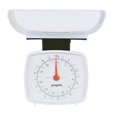

It doesn't have to be very far forward of the center,  maybe only a inch or so
It depends on the local laws a weight limits on axles
Should be a full load on the steer when you have full weight on the drives
This will vary on wheel base and laws etc
You should be able to get it pretty much spot on first go
Weigh just the steer axle no load
Weigh just the drives no load
Get some old style kitchen scales and a piece of say 2 x 1 wood long enough to measure your wheel base at scale you choose, maybe 1 inch equals 1 foot
Then two kitchen scales, something like this
Maybe use a 1 - 200 scale as in
1 pound on the scales equals 200 pounds in the real world
One scale is drive axle center the other is steer axle
Put the 2 x 1 on top with scaled wheel base to match the measurements on the stick and center these marks in the middle of each scale
Load these up to match the tare weight
From the gross weight your allowed to carry you subtract the tare
Scale this weight to the same ratio as tare weight
Then place this on the stick and move it along until the weight is in the ratio from steer to drive axles
This is your king pin location
This was how things were done before computers and trucks run at maximum weight
By doing this you can't over load the steer but always have plenty of weight to make the truck handle properly
