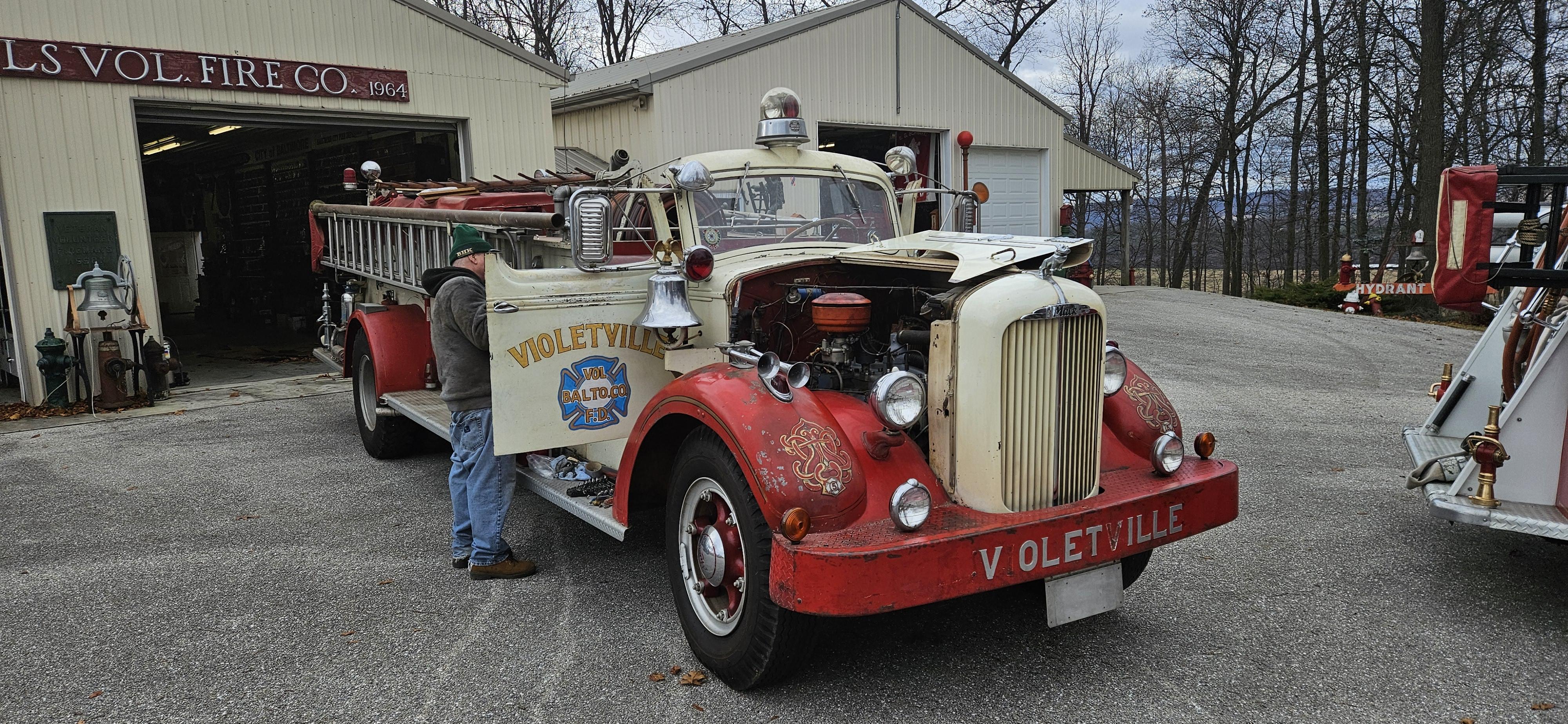

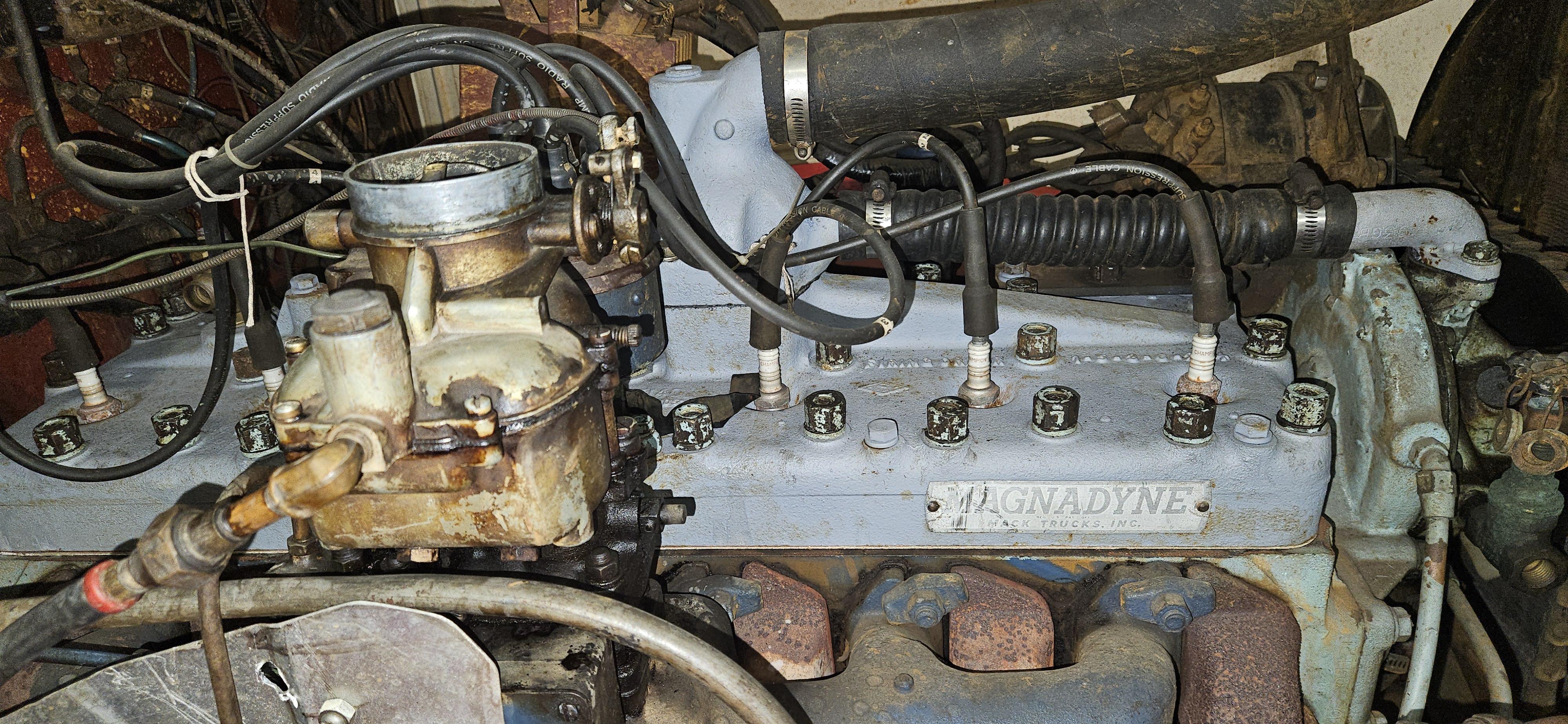

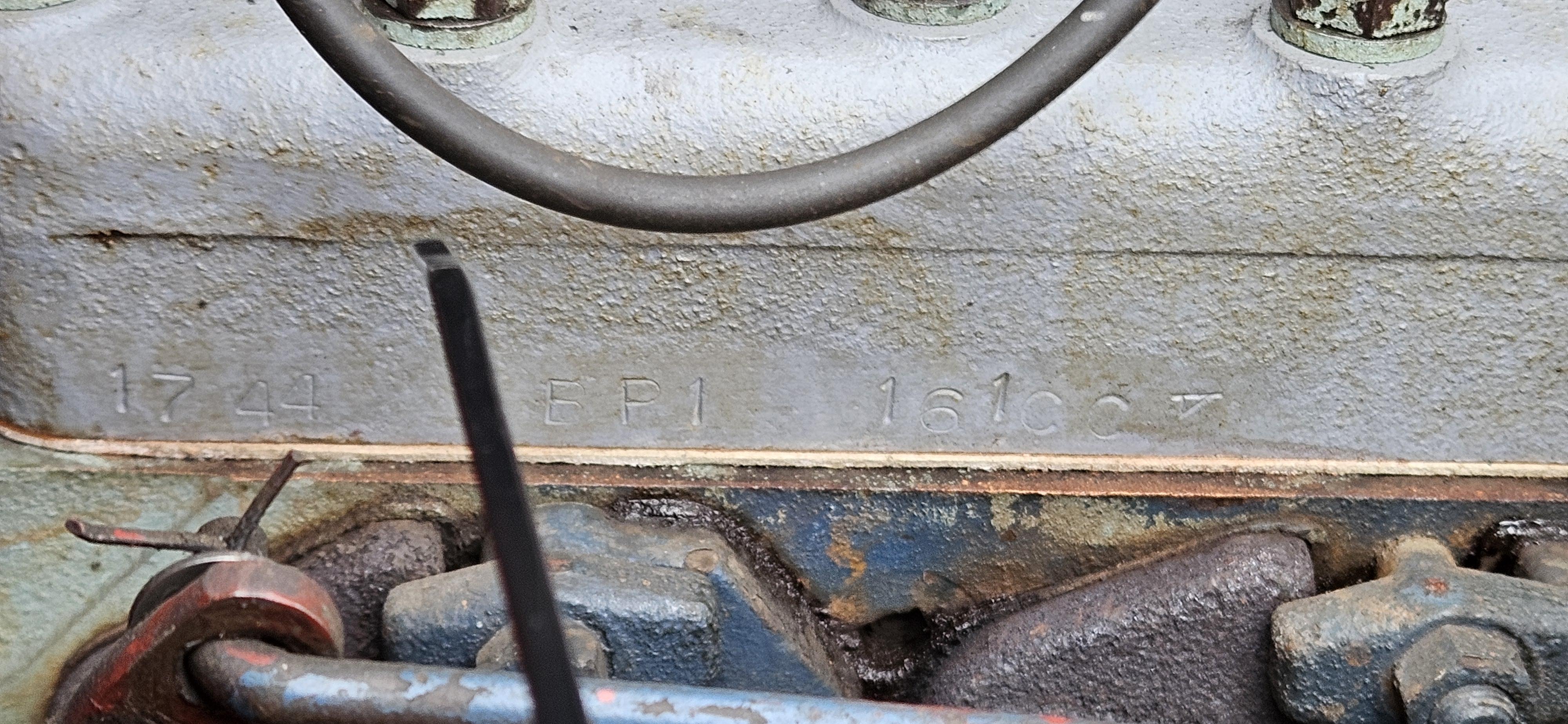

Helping a friend with an antique fire engine. I can not tell what size this Magnadyne engine is, attached are photos of the block stamping.  We can not get it to idle with the choke off. Will only run with half choke or with a 1/4 or more throttle. Had the carb rebuilt. Going to do the ignition system next. Slowly been burning out the old gas to try fresh fuel. I disconnected the vacuum line first thinking a leak but that did nothing. Sprayed down the intake manifold with carb cleaner to listen for an engine change but nothing. Only adjustments I can see on the carb are the 2 idle mixture screws and that's made no difference either. As soon as you put the choke in and off the throttle it dies.
Any thoughts on what else I maybe missing.? What is the device between the carb and the manifold, I assume some type of governor?

Years ago I had a Diamond T with a Hercules engine that had a large Zenith carb with a governor between it and the manifold. It had your same symptoms. I ended up hollowing out the governor and blocking all the vacuum holes and ports. It was then just a spacer. It ran fine after that. One other thing to check is the fuel pressure.
Far outside my expertise, but we have an old Oliver white tractor/forklift that we replaced the carb on a couple years ago and just hooked the governor back up a couple months ago. Man, it idles so much smoother now that it self regulates it's idle speed. I would look into your governor mechanism if all else checks out.
