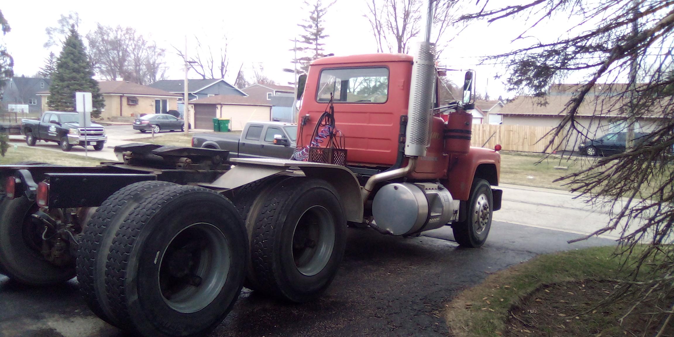

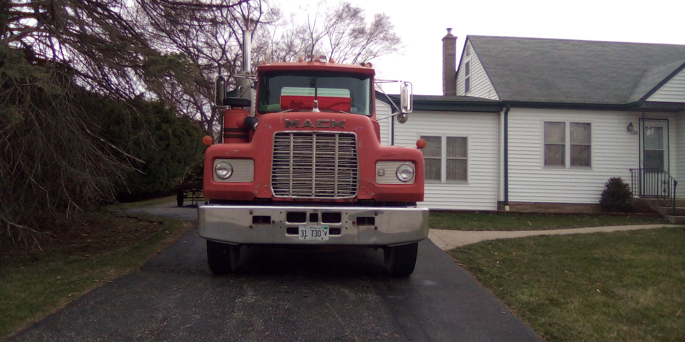

Hello all,  Need some help with my 1988 R688ST
The passenger door wont open from inside or outside.  When I push outside button it just goes in, feels like its not pressing on anything, inside feels like it is attached to something, push down but no luck lift up can hear what sounds like it is locking. Key works outside and I can hear it locking and unlocking, there is also some resistance like it is definitely doing something. Tried pushing handle and had someone pulling outside while i also pushed out and nothing. Checked to make sure no one tack welded door shut and found nothing, seen that bs door rattle fix before smh 🤷‍♂️🤦‍♂️
Any thoughts on cause, or suggestions on how to pop door open without taking panel off from inside with door shut?
Would much rather get it open and then remove panel for repair
