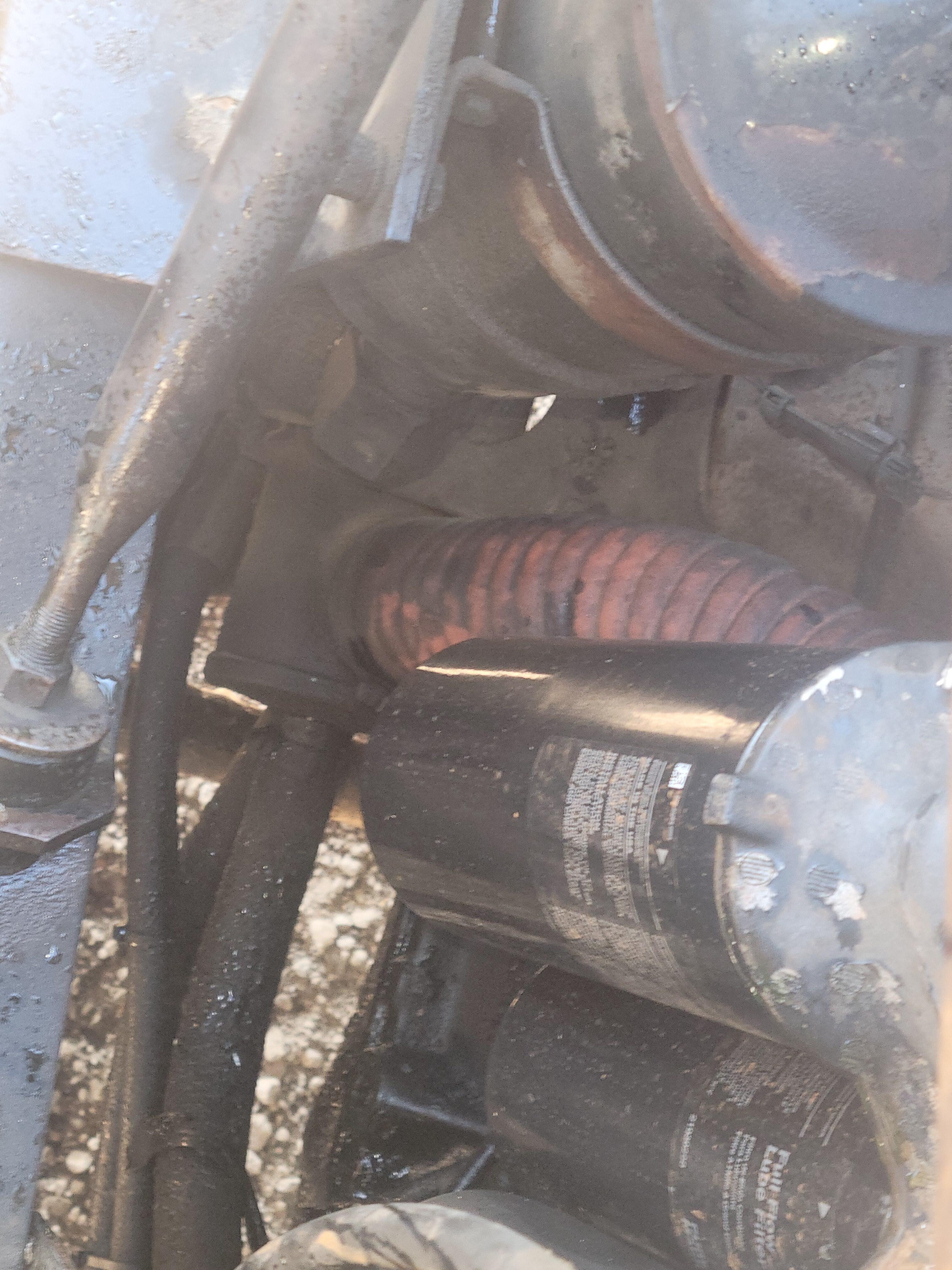

ok guys I have a 2000 rd688 e7 . I changed the water and antifreeze bout yr or 2 back .
checked it now it's rusty so I open the drain on the oil cooler nothing comes out
so I pull the thermostat housing and the water is bubbling like crazy ..why I have no idea the truck is cold ..
any help would be appreciated
I have a video but can't seem to load its to large I guess
So nothing came out drain but system was full, right?
So is the drain plugged with snot from inside the cooling system?
Seen systems with enough crud in them to block an inch line, so radiator cores would be definitely blocked.
Which would cause the pump to cavitate, creating air bubbles in the system.
Wrong mix of coolant/ anti freeze can react with each other, as well as poor quality/ hard water can cause corrosion/ rust in system.
Just something to think about.
took belts off no bubbles
took drain out of the bottom of the cooler no water comes out of there even refilled it with drain ran it still nothing comes out

Don't want to take work away from Joey But ! Mike did you pull that fitting right out don't just take the wing nut out pull the whole fitting! I have had those pugged solid with corruption! Do this first before getting carried away!

No bubbles with belt off sways toward pump cavitation from blockage/ foreign matter in system, as does nothing coming out drain on cooler.
Nothing that couldn't be fixed by pulling a few hoses and back flushing. Also some good cooling system cleaners out there worth a look at. Worst case pull the radiator and have it rodded .

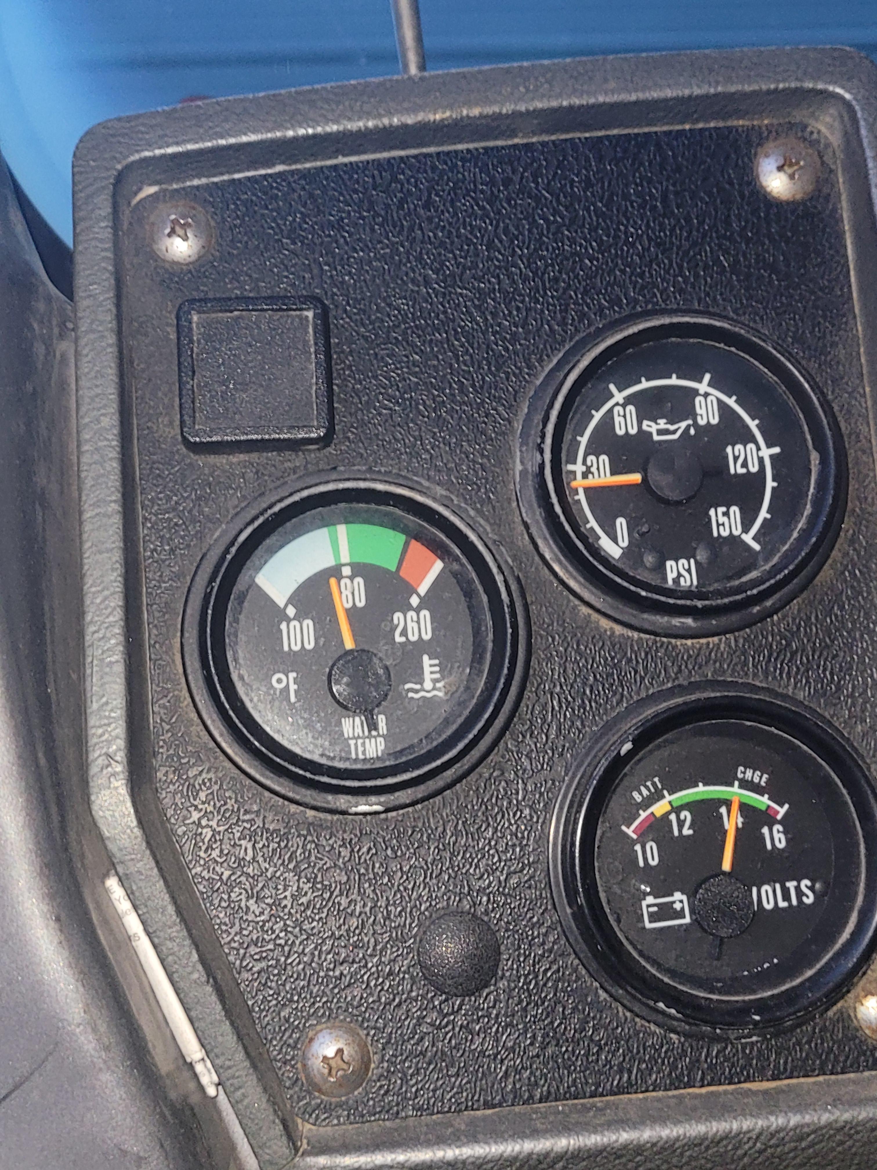

ok guys got everything apart
took all hoses off from reservoir tank took hoses from top bottom of radiator
took hose from side of motor to transmission cooler
flushed everything out with water
put all hoses back on filled it with cascade let it run til it was blowing hot heat inside around 150 temp on gauge
now I open reservoir cap the water is still cold I can put my finger in the water not hot at all
I'm thinking of changing out the thermostat
what do you guys think
I figured try the cheapest part first
or should I just do water pump and thermostat at the same time
thanks guys you'll been a great help

Stat first 150 to cold! How long are you running it?  need to get it hot!
1 hour ago, Moparmike said:
ran it about 45 minutes to a hr
I open the cap and put my finger in there at that temperature not hot at all
Can you work its ass? Running at an idle  is not the greatest!
