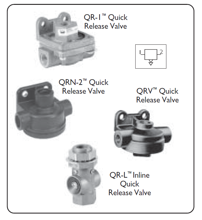

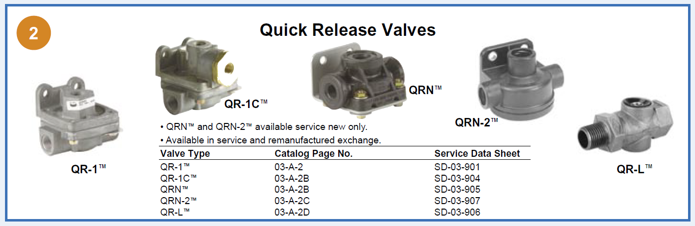

Well I got all the air lines cleaned out and it makes 120 psi, but I’ve got a new problem. When pressing down on the brake pedal, there is air shooting out of what looks to be an exhaust for the air brakes. There are two of them but only one is spewing air. I can provide a picture if needed.
It may be a quick release valve I hate it when I find a quick release valve that someone put in to split the brake line down to the service brakes they can stick open while driving and then you have no brakes there should just be a T there, quick release valves are more suitable for the parking brake if equipped with the bigger double brake chambers
Ok so what do I need to do to fix it?
Quick release is a small box with a 1" hole in the bottom that releases air pressure when you let off the brakes to "quickly" release the brakes.  They are mounted right at the axle with the two air lines going to the cans (There two, one for service, one for parking brakes).   They do fail, and like you mention, it will leak air on application instead of release.  The front axle brakes will have a similar item.  It is what gives that air Woosh sound when you release the brakes.
