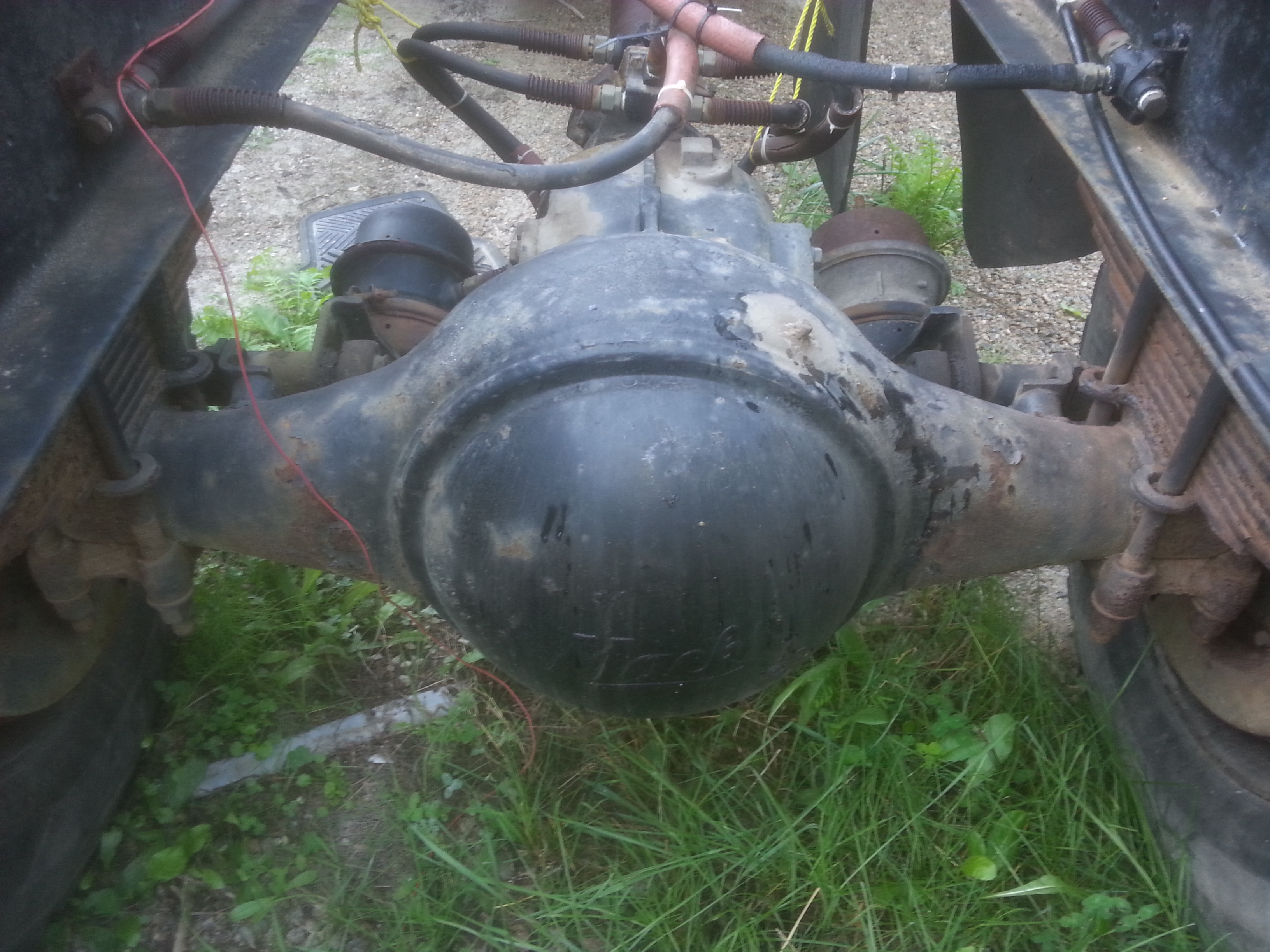

Hi.
Im working on a single axle R with a RAD529C and a CRD1171 Carrier.   Do we like these axles?  Is there anything to look out for in regards to problems?  According to the build sheet and some info I found online, the CRD1171 is some sort of power divider.   How does that work in a single axle?
Thanks
Definitely never seen one of these
And as for power divider that was mentioned back at the beginning
I can see a housing that looks a bit like one there but as to how it would on a single drive ??
No idea at all
My first thoughts were a bit like LSD but I cant see how that would work f from the housing out the front
The banjo housing looks a little like a normal top mount Mack housing turned 90 degrees
No idea if that is the case
I assume that it is double reduction  ?

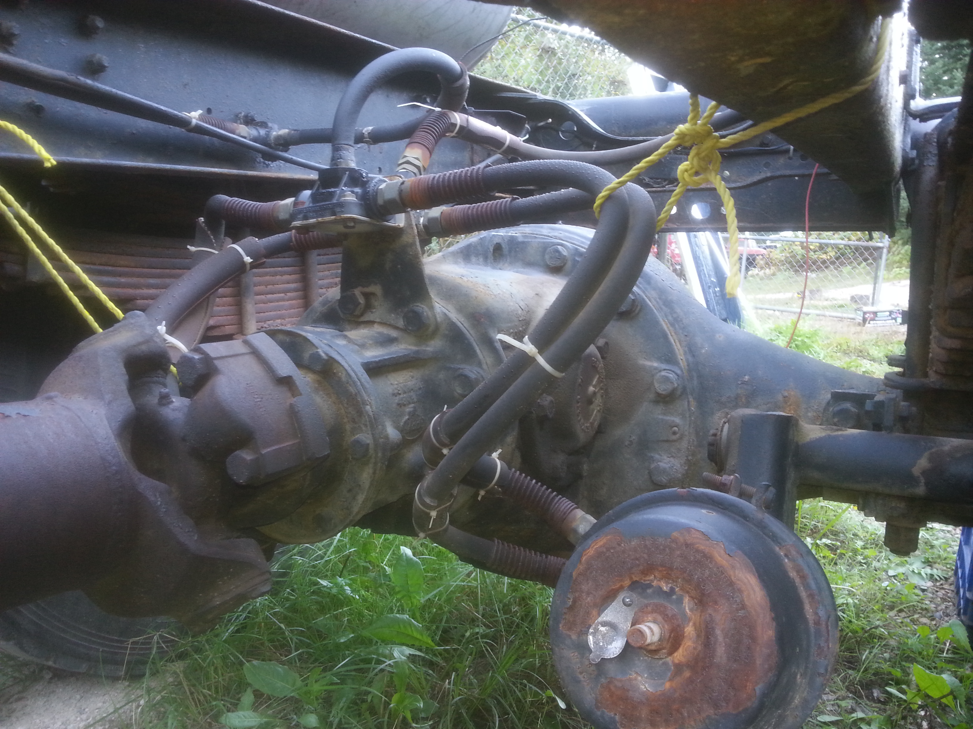

what year is the 'R' model? I havent found a manual for that rear end yet..  Mack E-Media, didnt help..  I would love to see it up close to get a better understanding of how it works..  I wouls say itsa locking diff. over a power divider, since its a single 'x'...   jojo

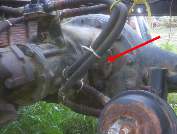

That does look to be a double-reduction axle.  You can see the caps for the cross-shaft in the lower picture he sent (see below).  I have never heard of any issues with these.  They are, as mentioned above, not that much different from the standard Mack tandem axle, just rotated 90°.
Power Divider makes no sense whatsoever in a single axle, UNLESS they put in something similar to the inter-axle Power Divider as a limited slip unit?  Instead of biasing power to the front or rear axle, it would do so to the LH or RH axle?  Just guessing on that, though.  Basically would be like a gear type limited slip unit.  Maybe somebody smarter than me can shed some light on that.

Yes I do believe that the "power divider" description in the build sheet might be reference to a LSD type axle, shifting power from side to side instead of axle to axle.   After checking oil levels I will drive the truck over some loose ground with no weight in the back and see if both wheels have a tendency to put power to the ground instead of just one wheel.
