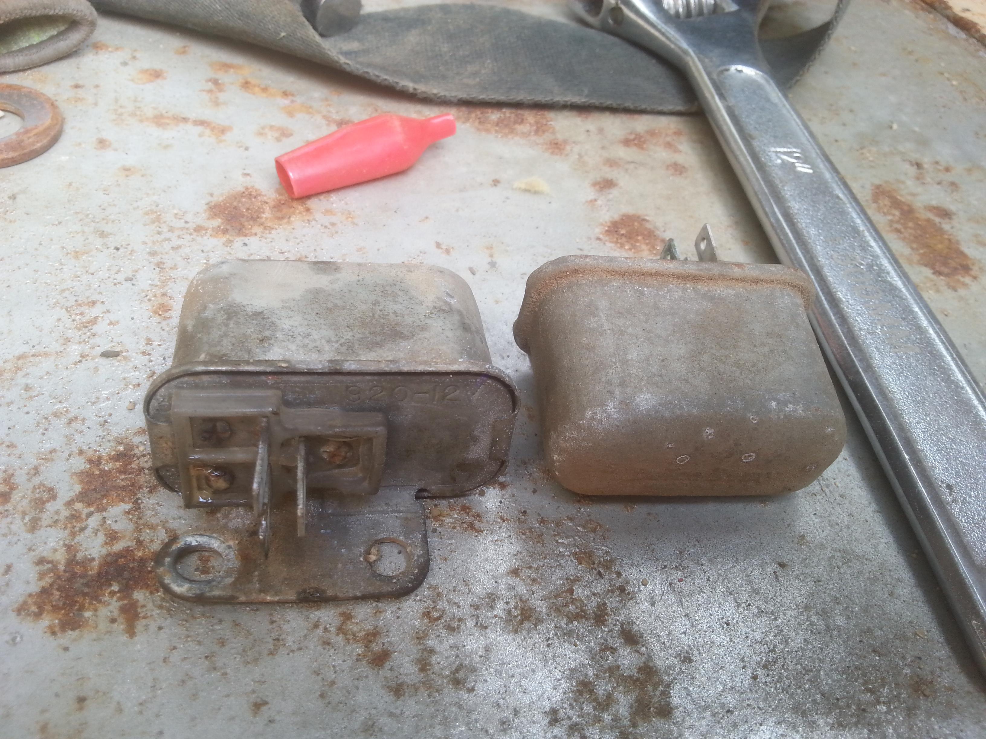

I'm suspect of this unit, mounted above the drivers side kick panel area.  (this is a picture of 2 separate ones, one off of a parts truck).   Anyone know if they have anything to do with the signal lights?
Im at a loss as to where to look next, the harness is in tact and im hoping to leave it that way so I figured i'd ask here before I pull that harness all apart and make a mess, whilst trying to solve this problem.    HOWEVER, I do not know if the signal lights were working in this truck, before biting the bullet and converting to negative ground and replacing LOTS of wiring, grounds and various things along the way in part of the restoration.   So I may have had a problem to begin with, that I do not know about.

Those look like horn relay or buzzer Buzzer often only has two terminals.
