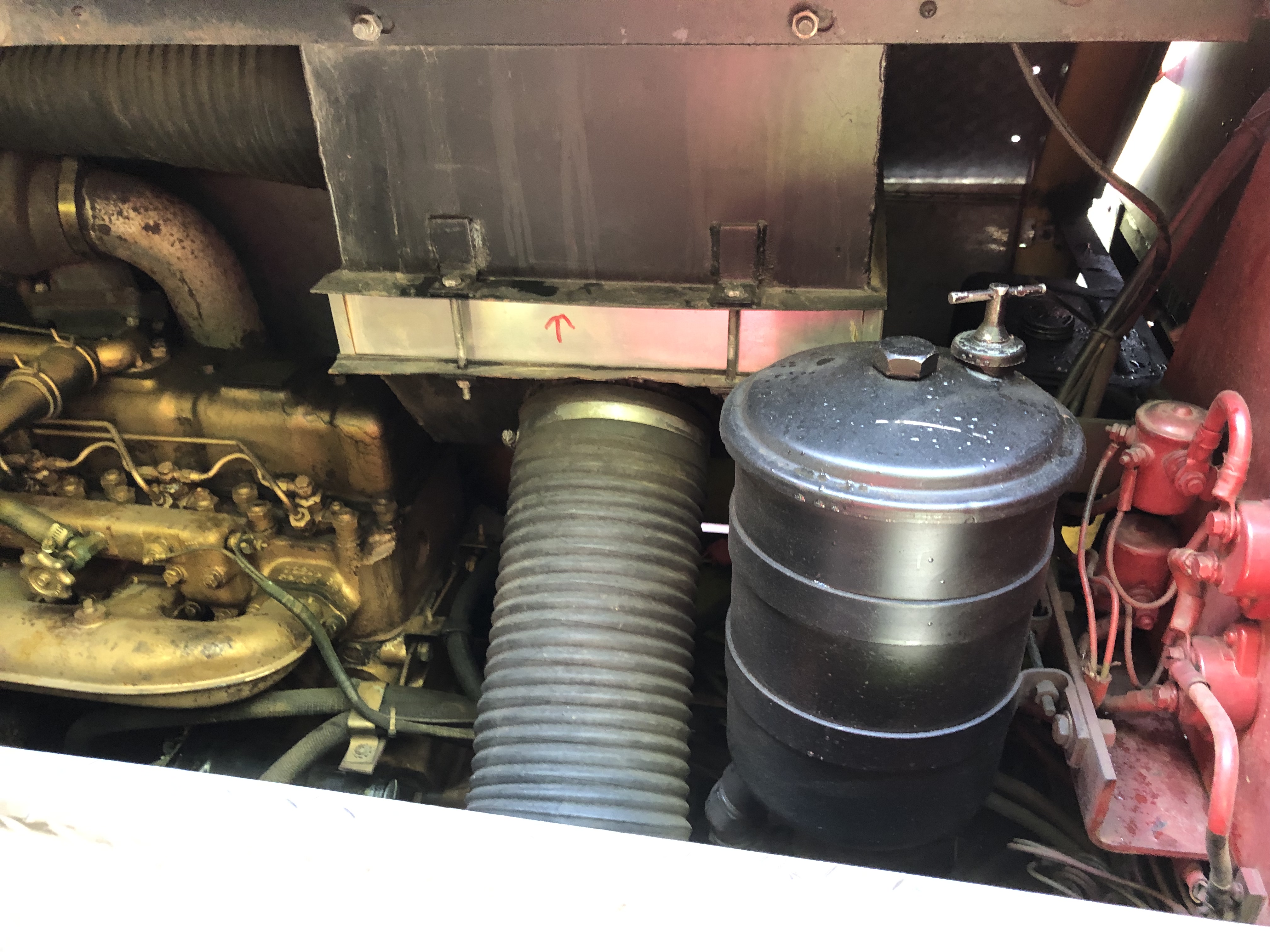

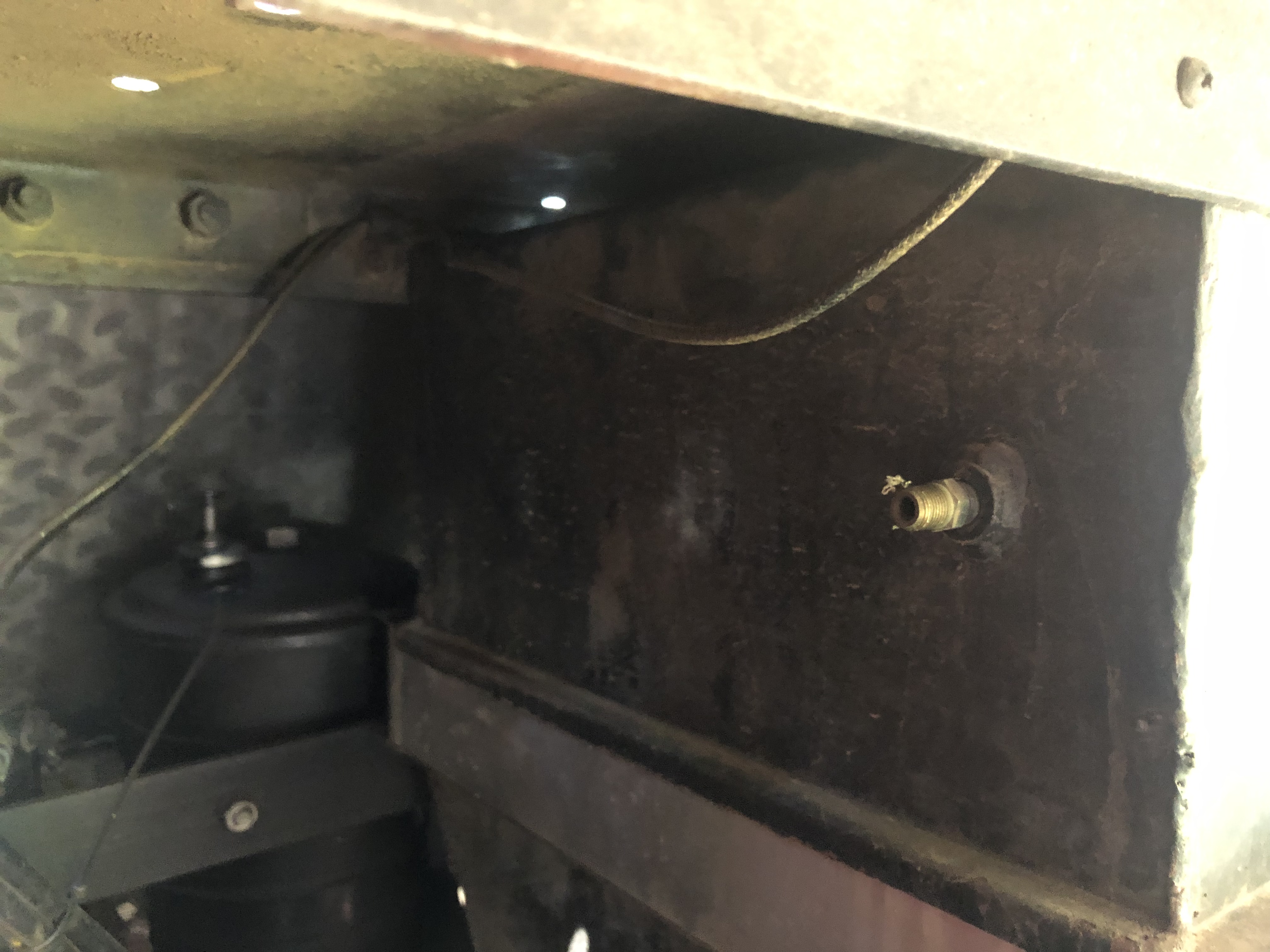

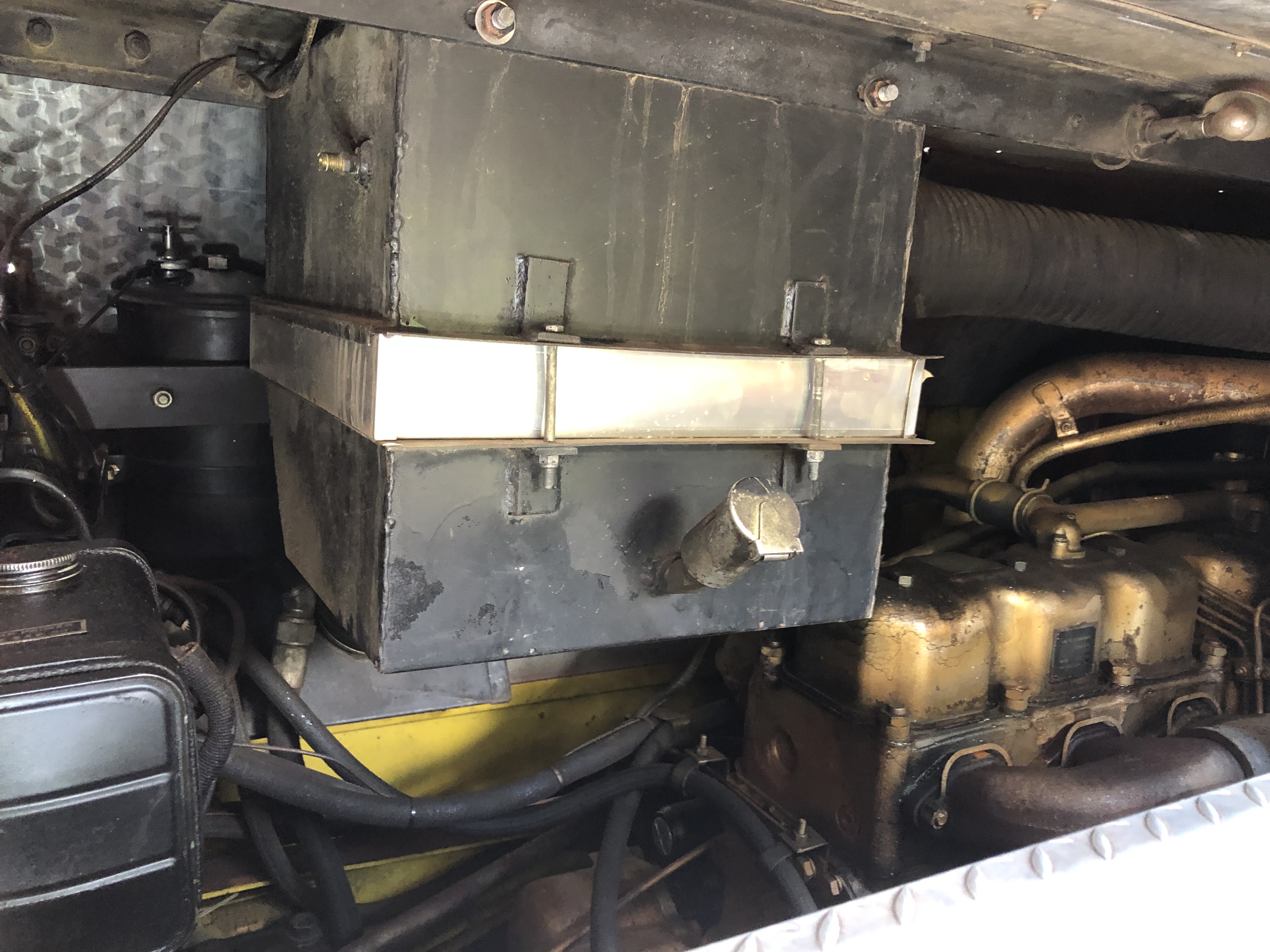

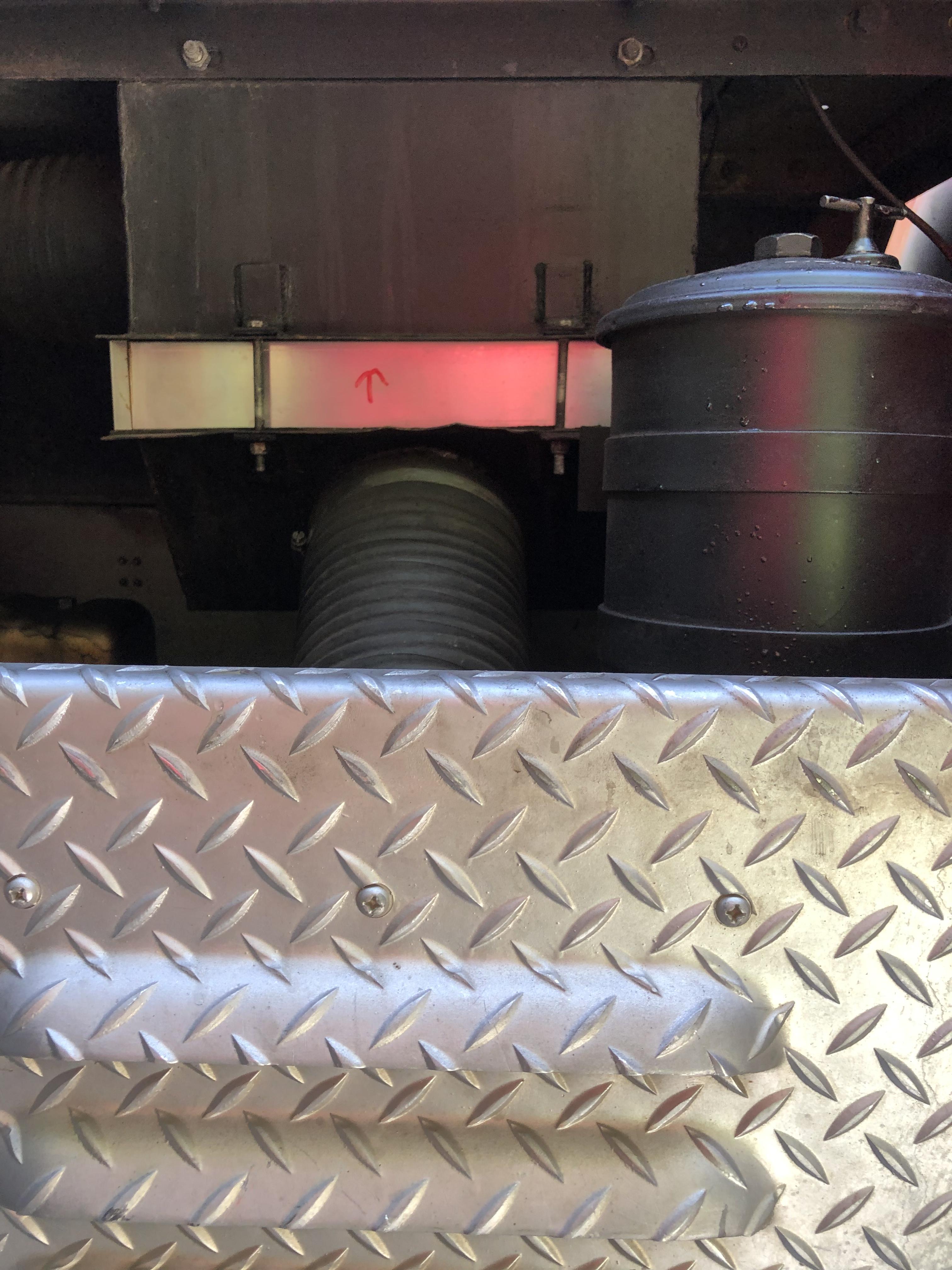

  12. Thanks to Mechaholic for pointing out the fitting for the service indicator. I missed that. I’ll have to see if I can find one. Also, the wires running on top go to two light bulbs on top of the engine. Looking down the inspection pipe, it looks like a dry media of some kind, so it probobly isn’t oil bath. Now that I have some idea of what I’m working with, I’ll take it down over the weekend and post some pictures of what I find. Thanks again for all the replies. Ed

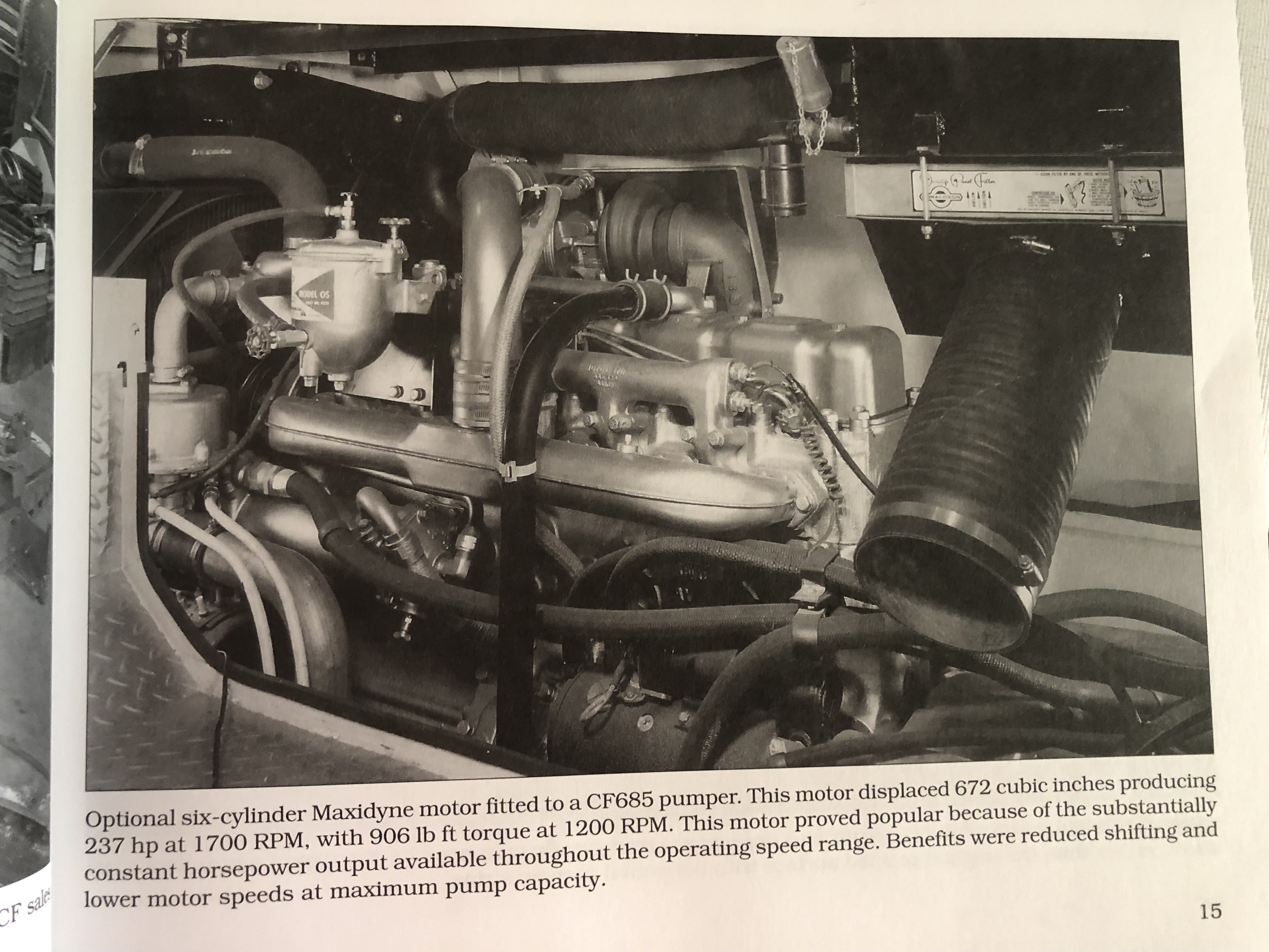

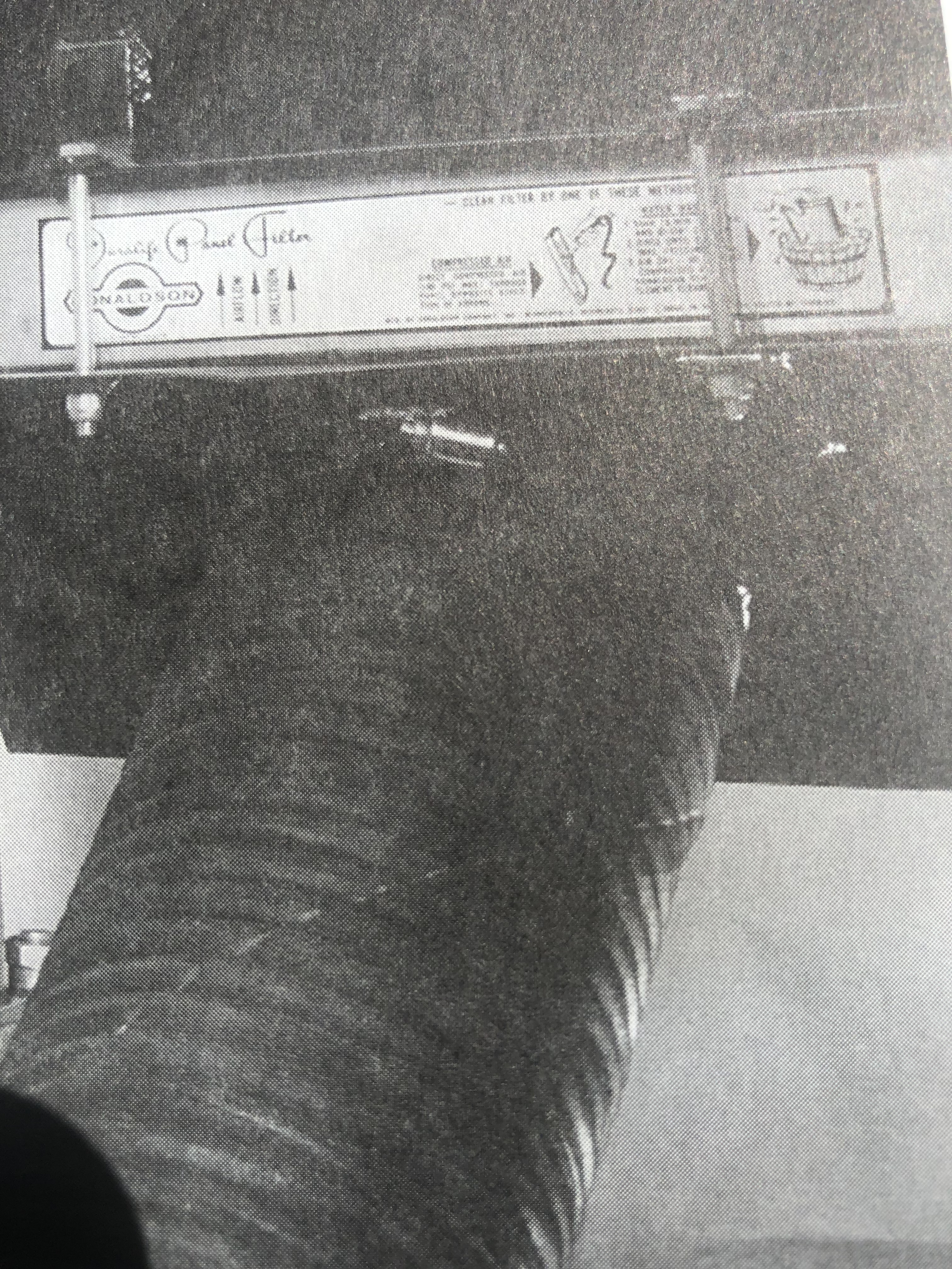

  13. God works in funny ways. I couldn’t find anything about this filter in my original service manual. I just received a book in the mail an hour ago about the Mack CF Fire Trucks in a photo archive. Lo and behold, on page 15 is a picture of a CF600 going down the assembly line with the new Maxidyne engine and what looked like the air filter I’m looking for. I looked at the picture with a magnifying glass and then enlarged it with my phone. It’s a Donaldson Duralife Panel Filter. Best I could tell it says you can blow it out with air or wash it.
  14. The air intake hose is connected to the engine cover on the drivers side. Thanks for all the replies. Ed

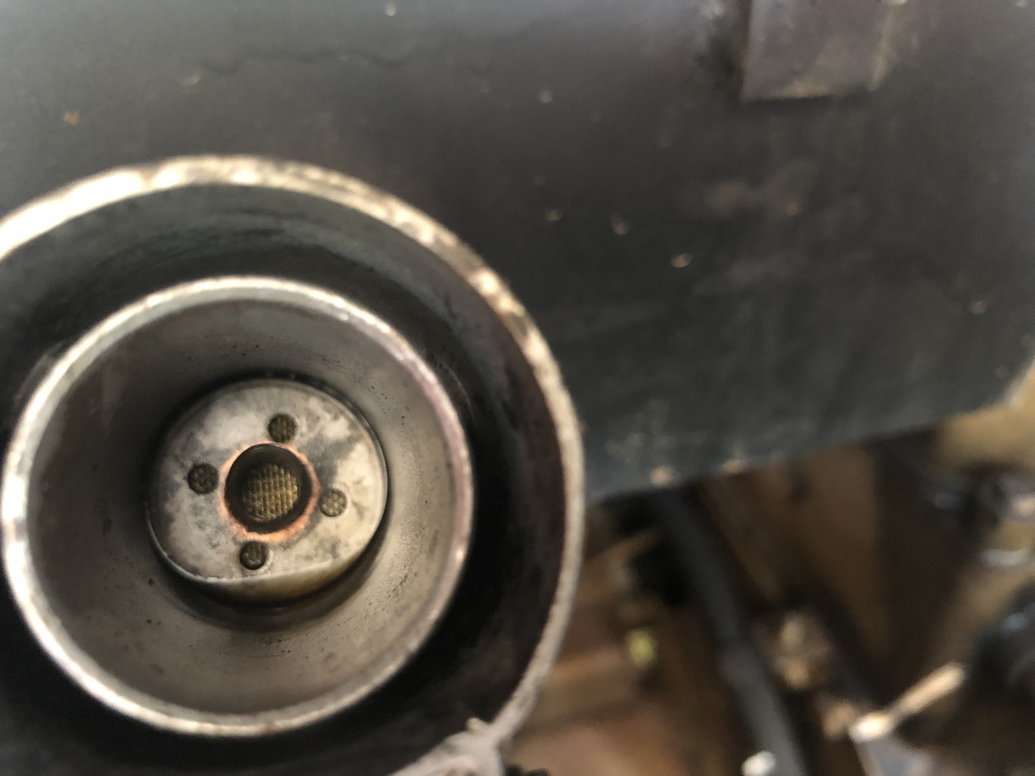

  15. It's a weird set up. Definitely smells like oil under the round flip cap. I'm trying to find some servicing info on it. I guess I'll just have to unbolt it and see what comes out.
