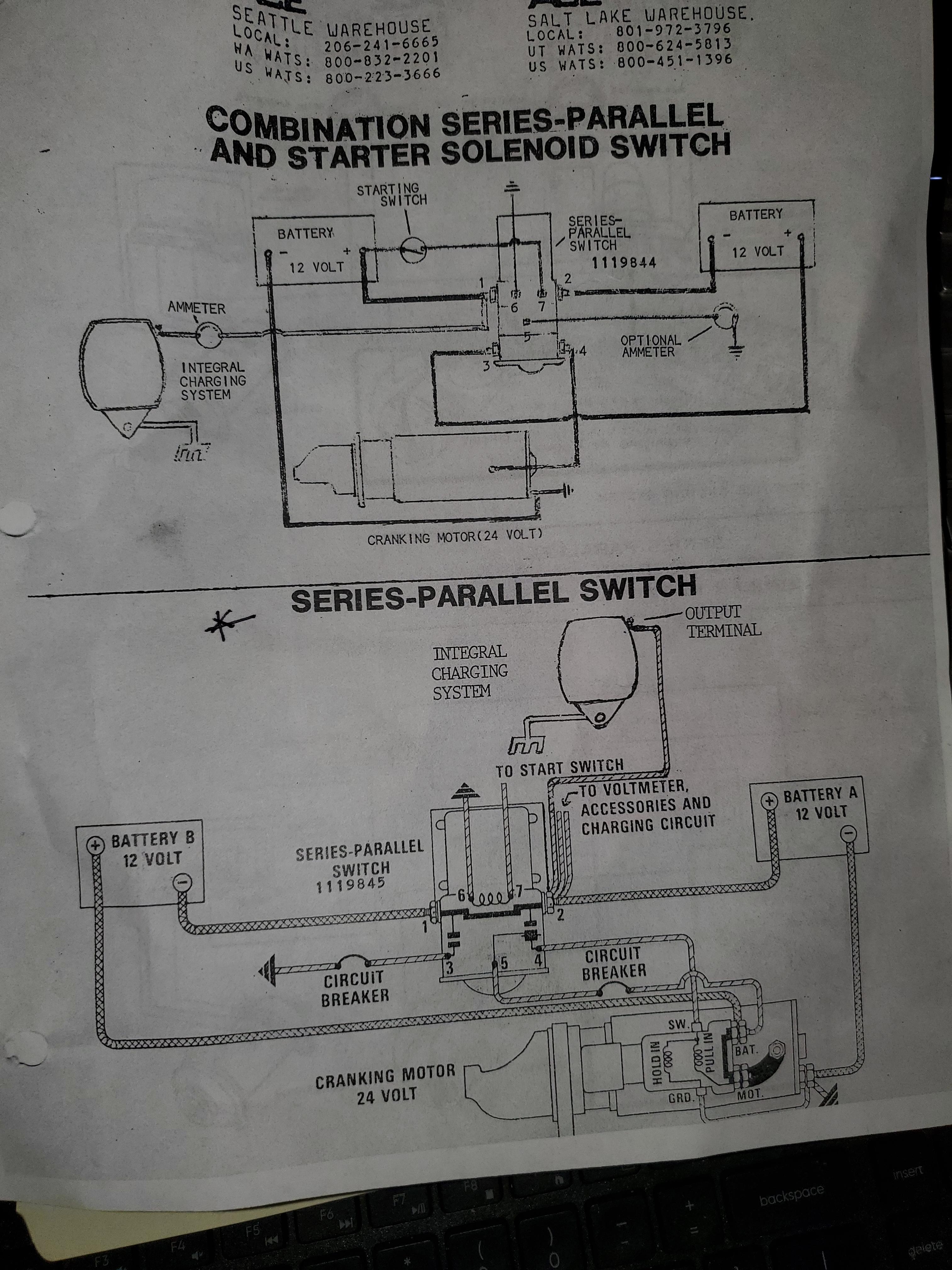

I guess one important thing to determine on this one is IF it has the 24V system.  If it does, the S/P switch would be suspect.  If it doesn't I would look at the cables.

updates are always appreciated . lets folks know their input  is being used. the lower picture has the hash mark i would assume that's your system. before purchase of SP switch, if cable replace /cleaning is an improvement; i would say continue with the cleaning cable ends first. with many parts i had , a brand new  SP switch was thrown out yrs ago = thinking no one uses these . such a mistake. bad as that sounds; you would be sick if I listed the truck load of DD parts i had that went over the bank. brand new complete liner kits etc . updates are good
