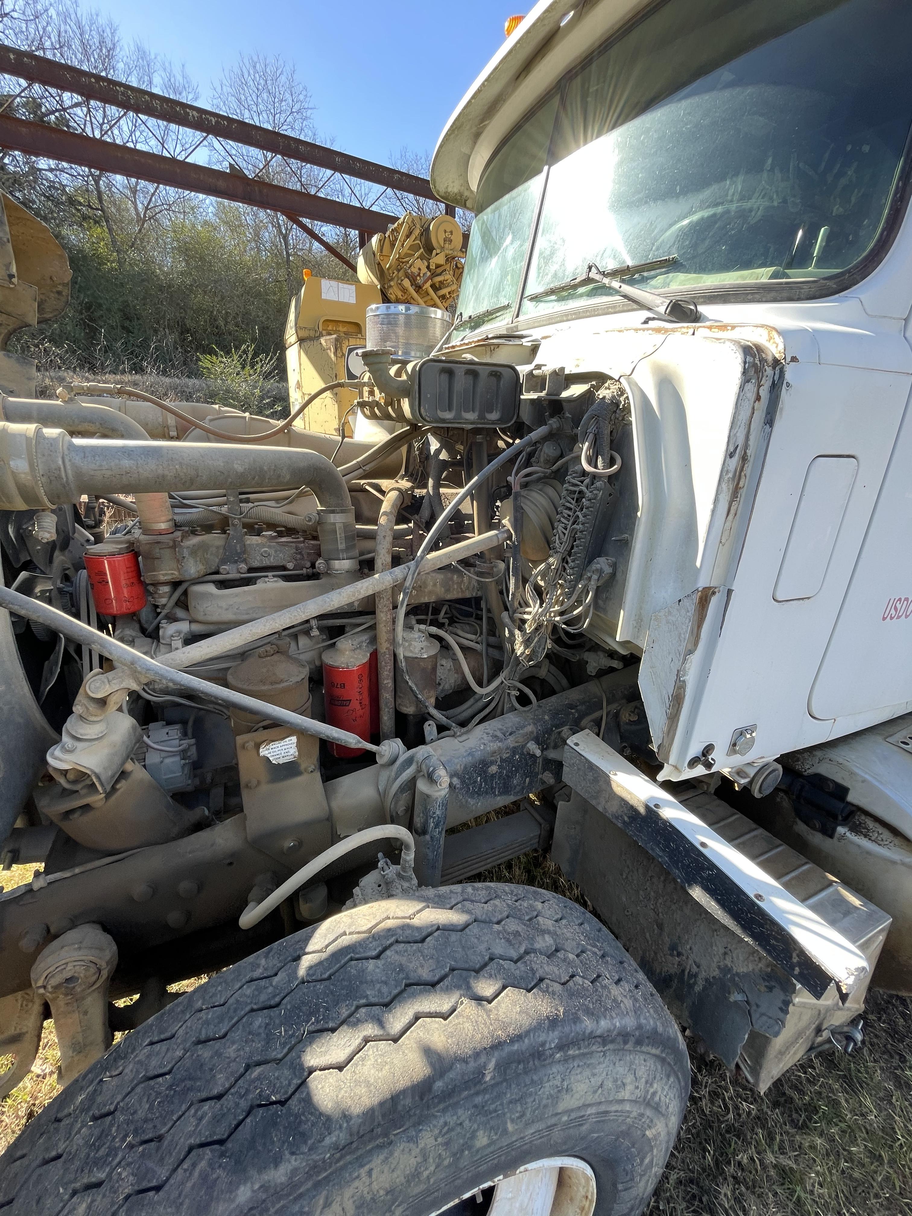

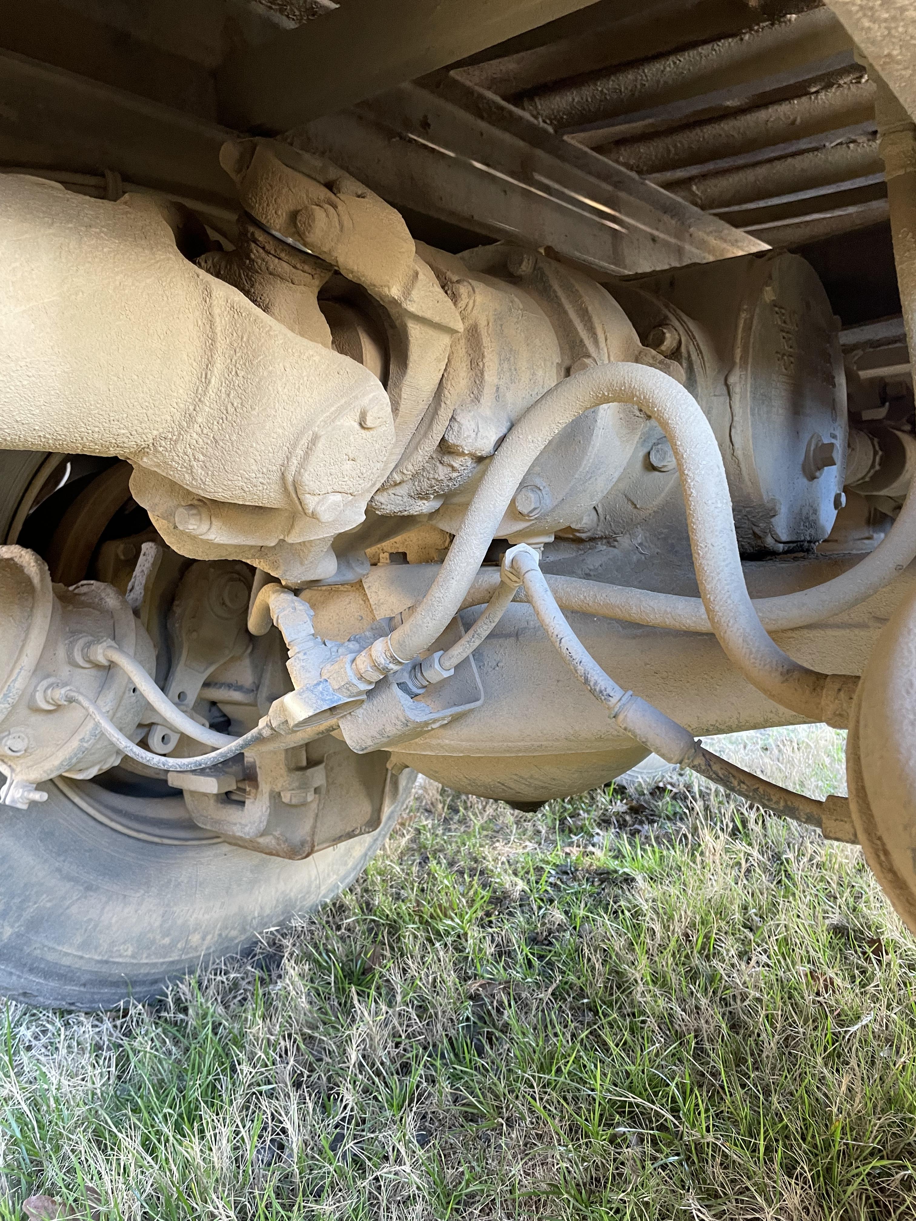

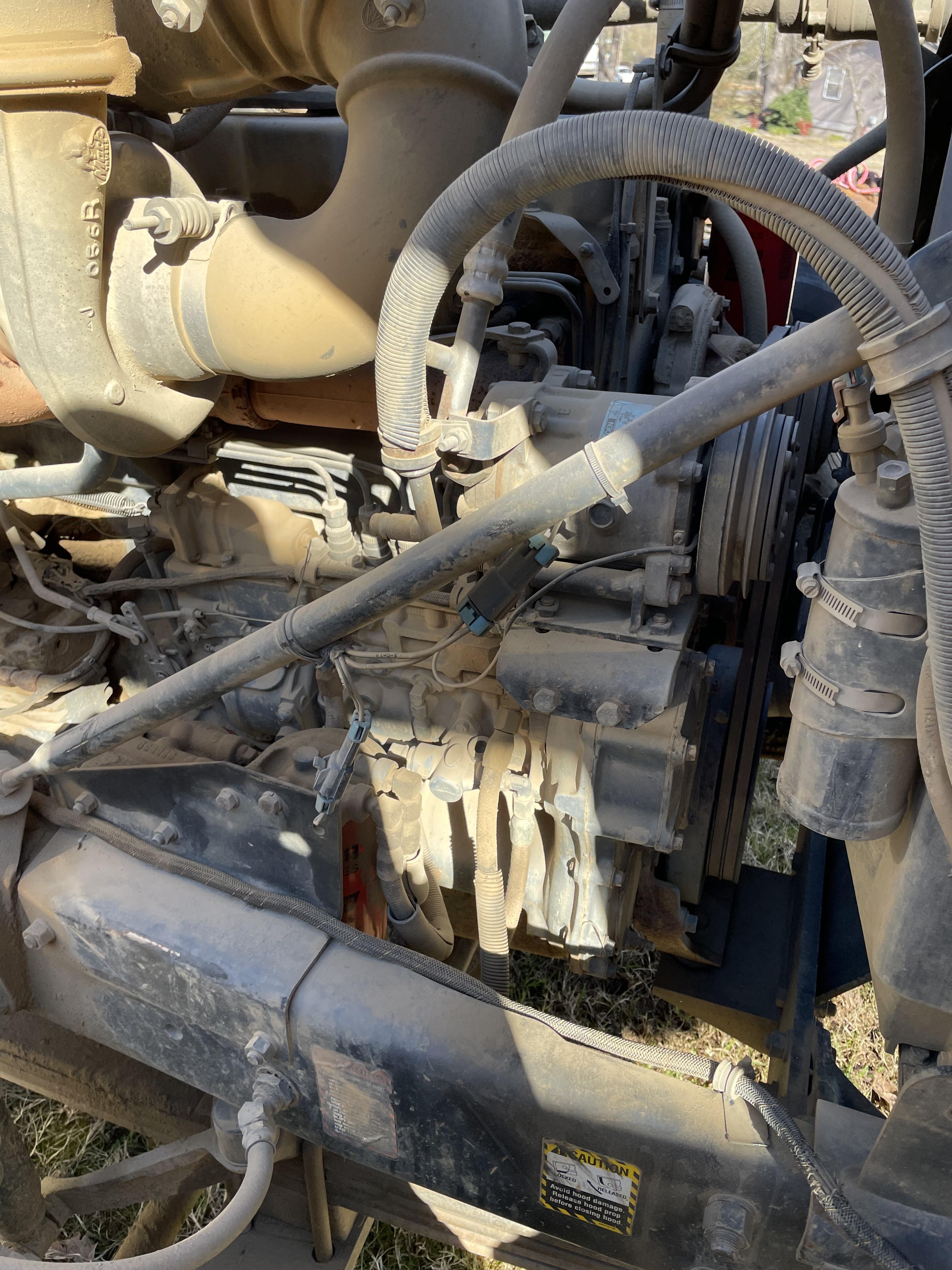

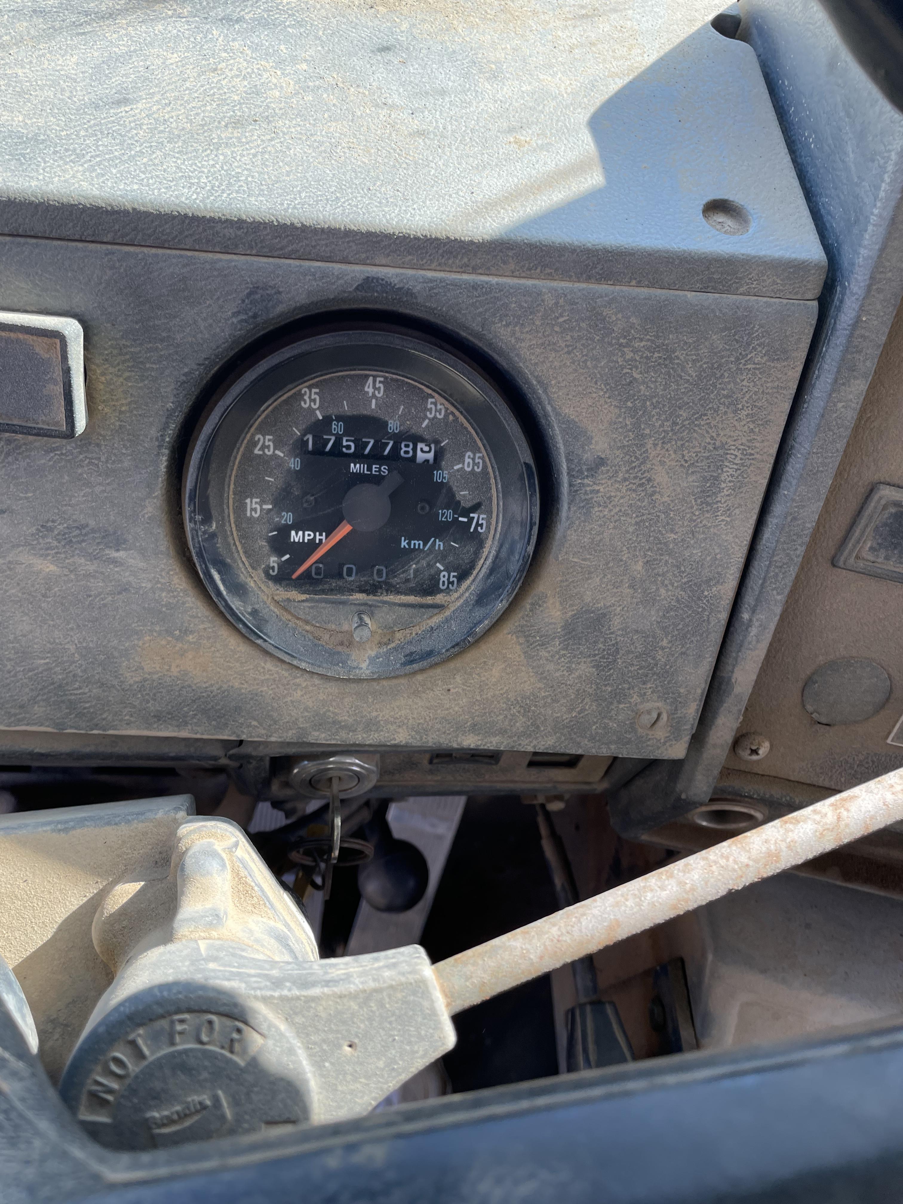

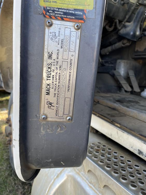

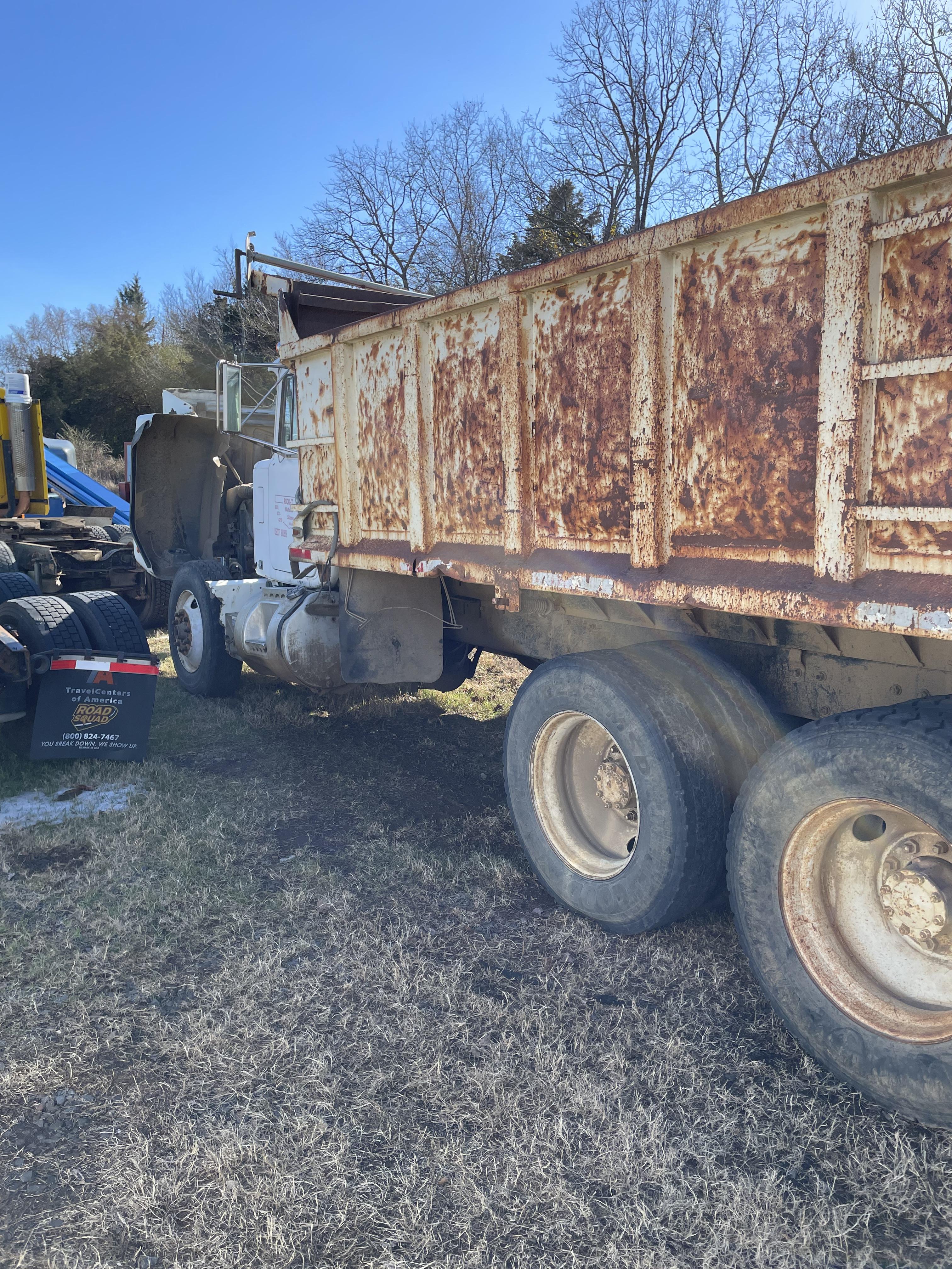

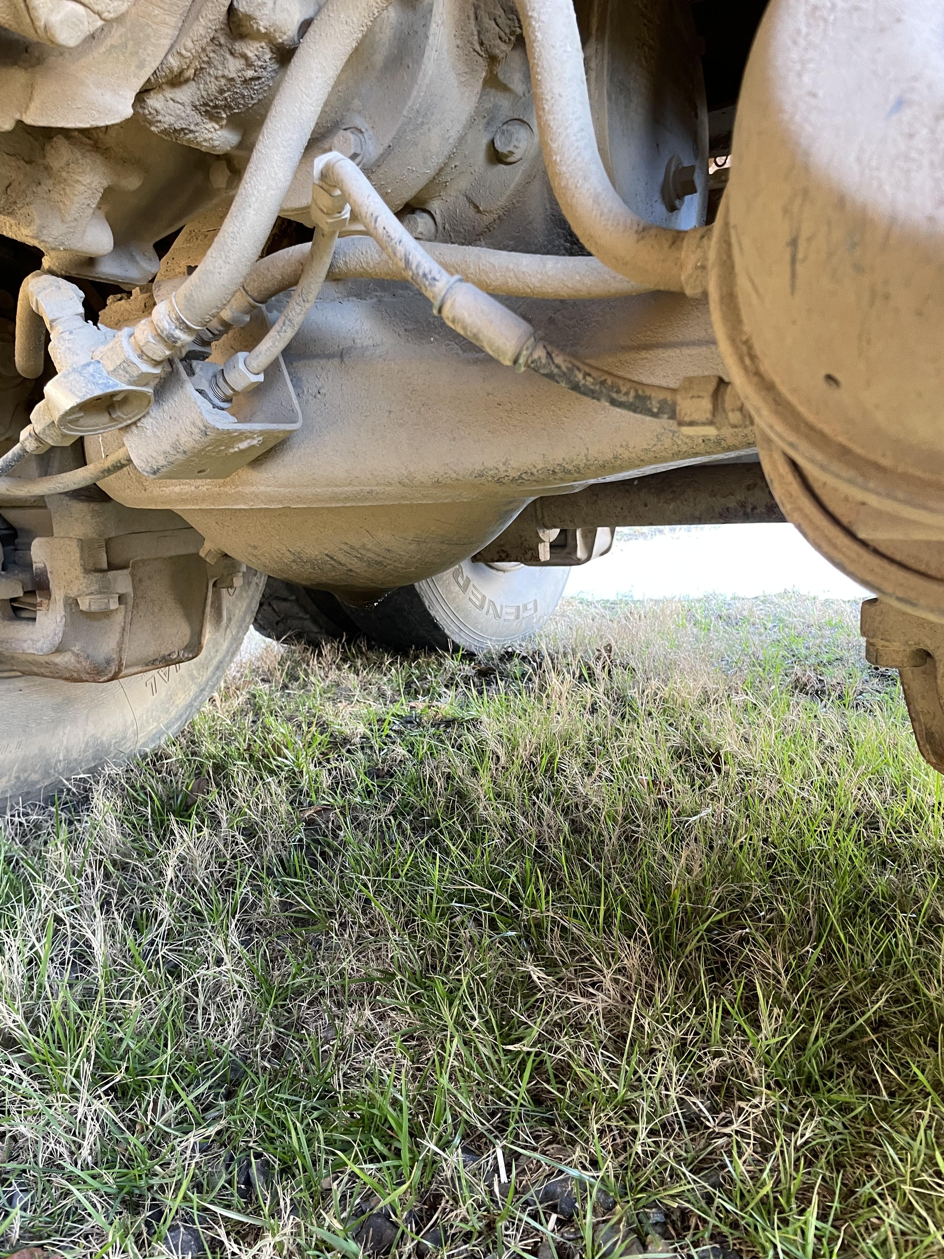

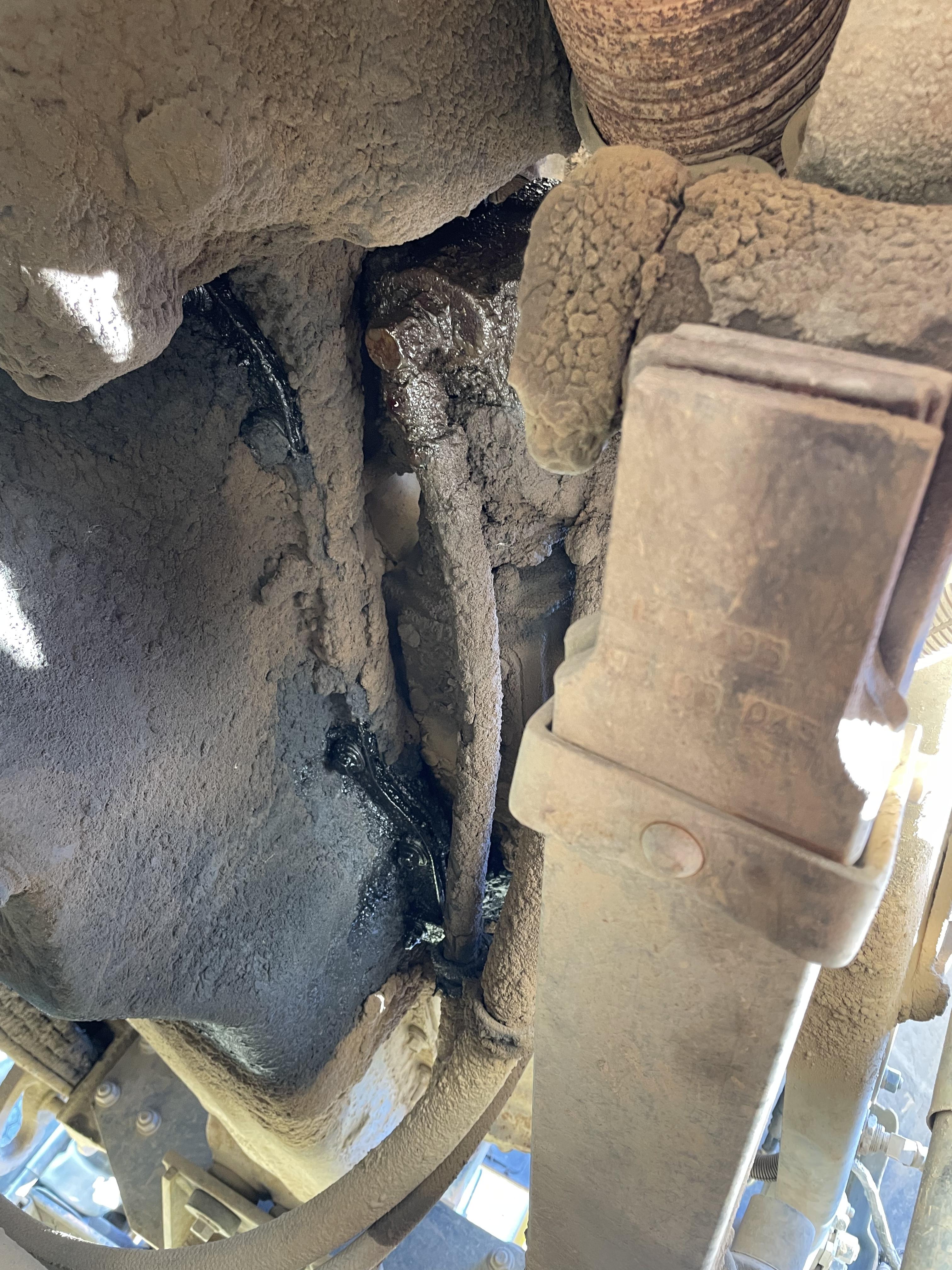

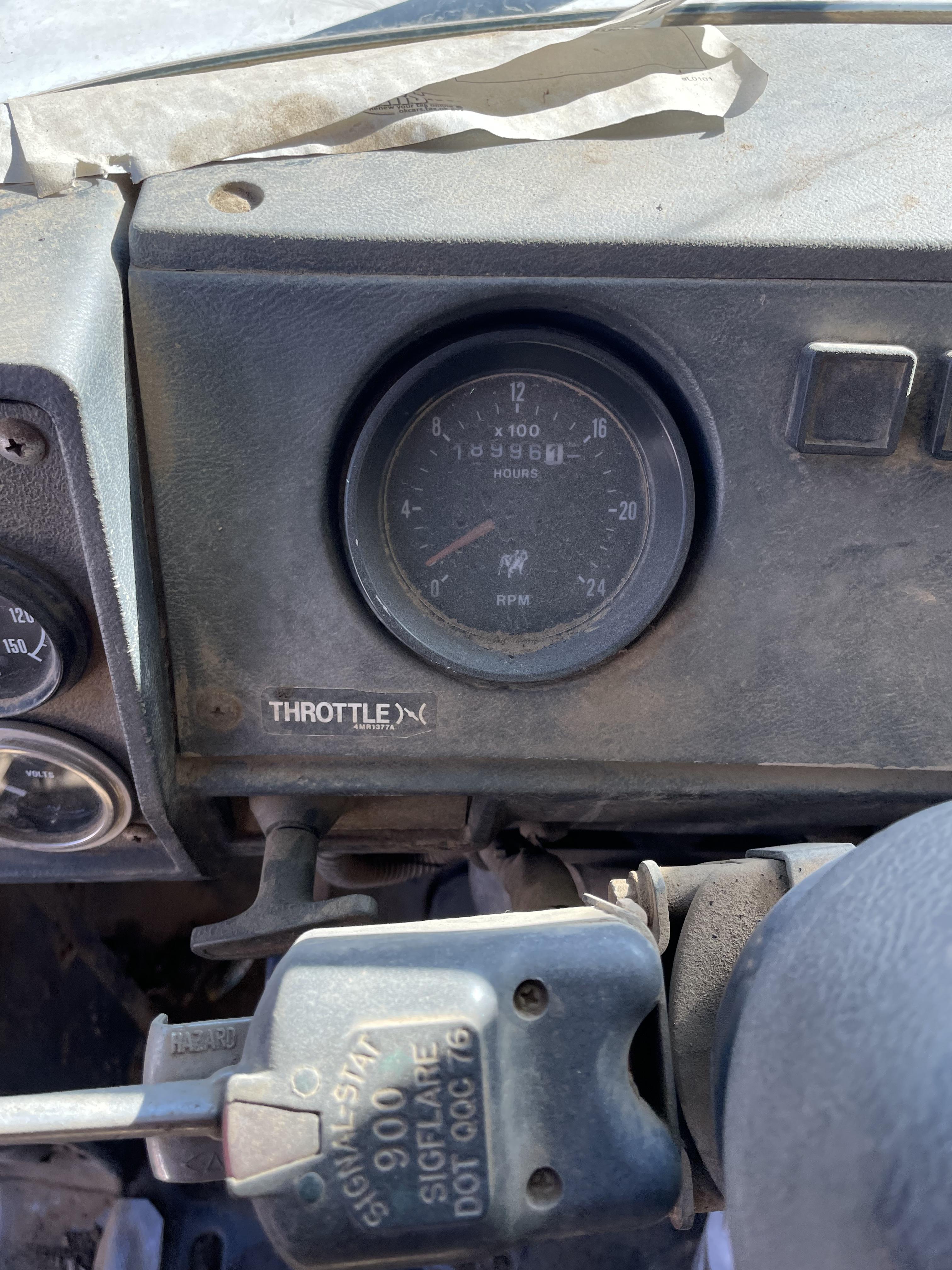

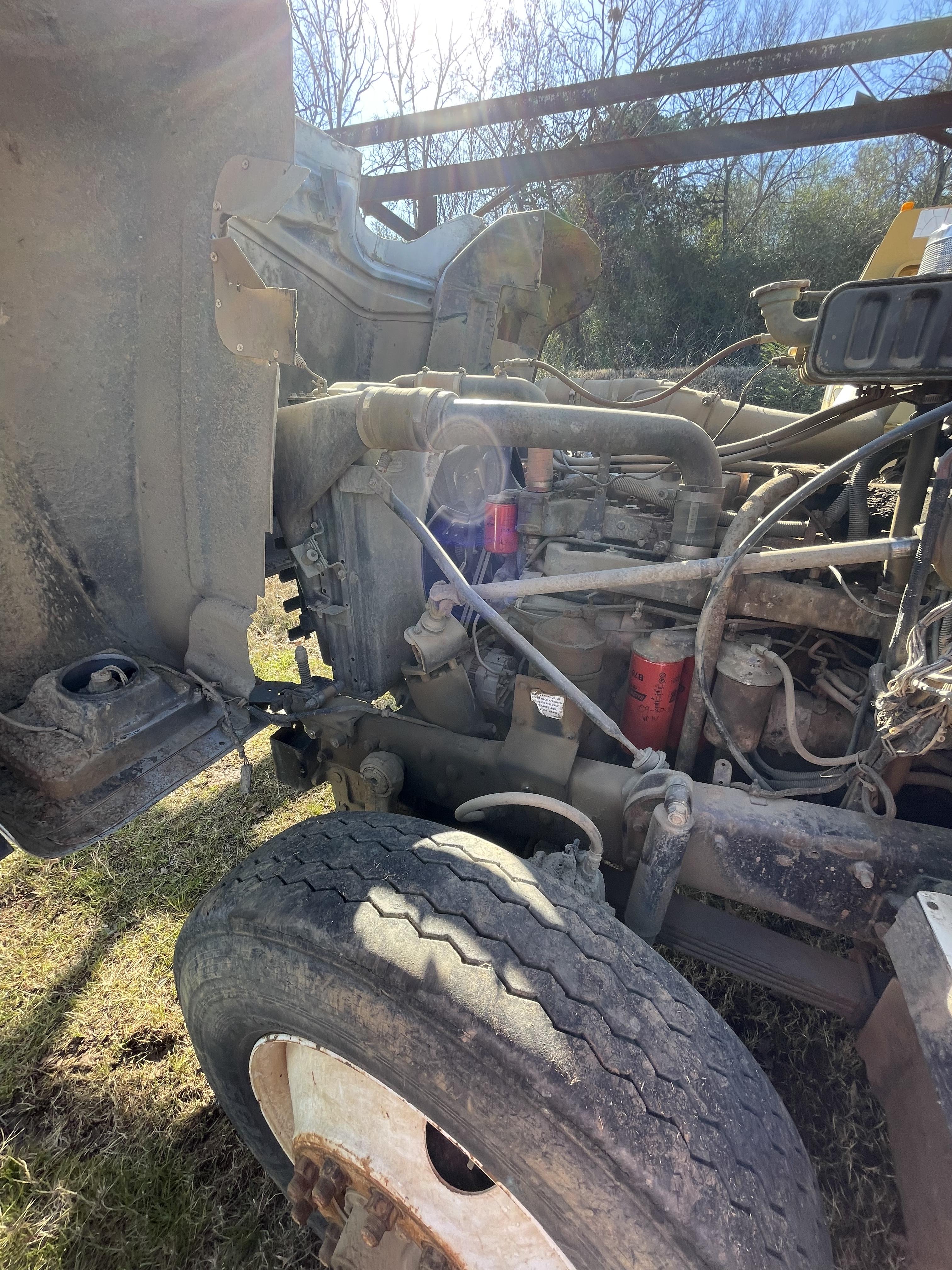

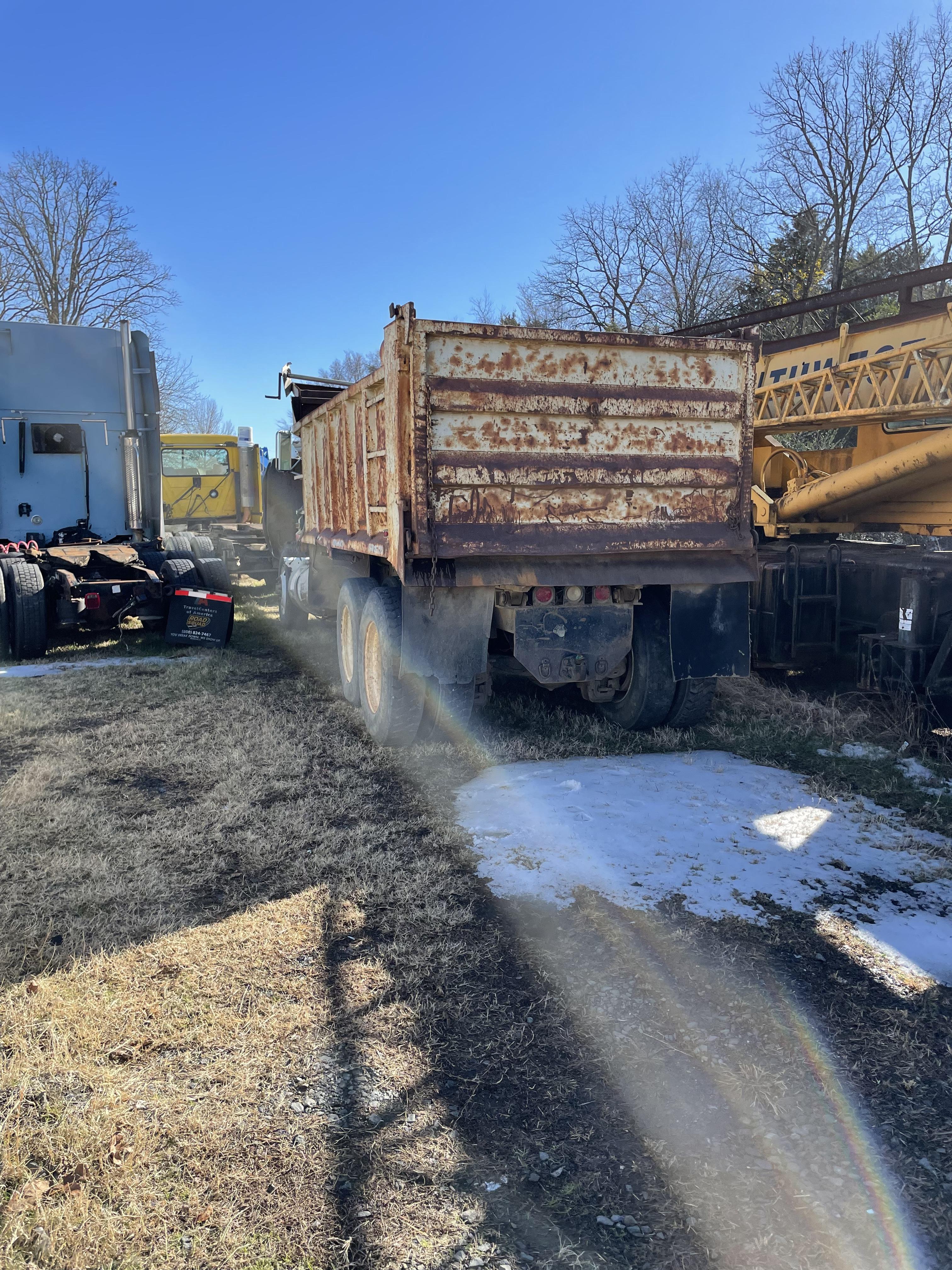

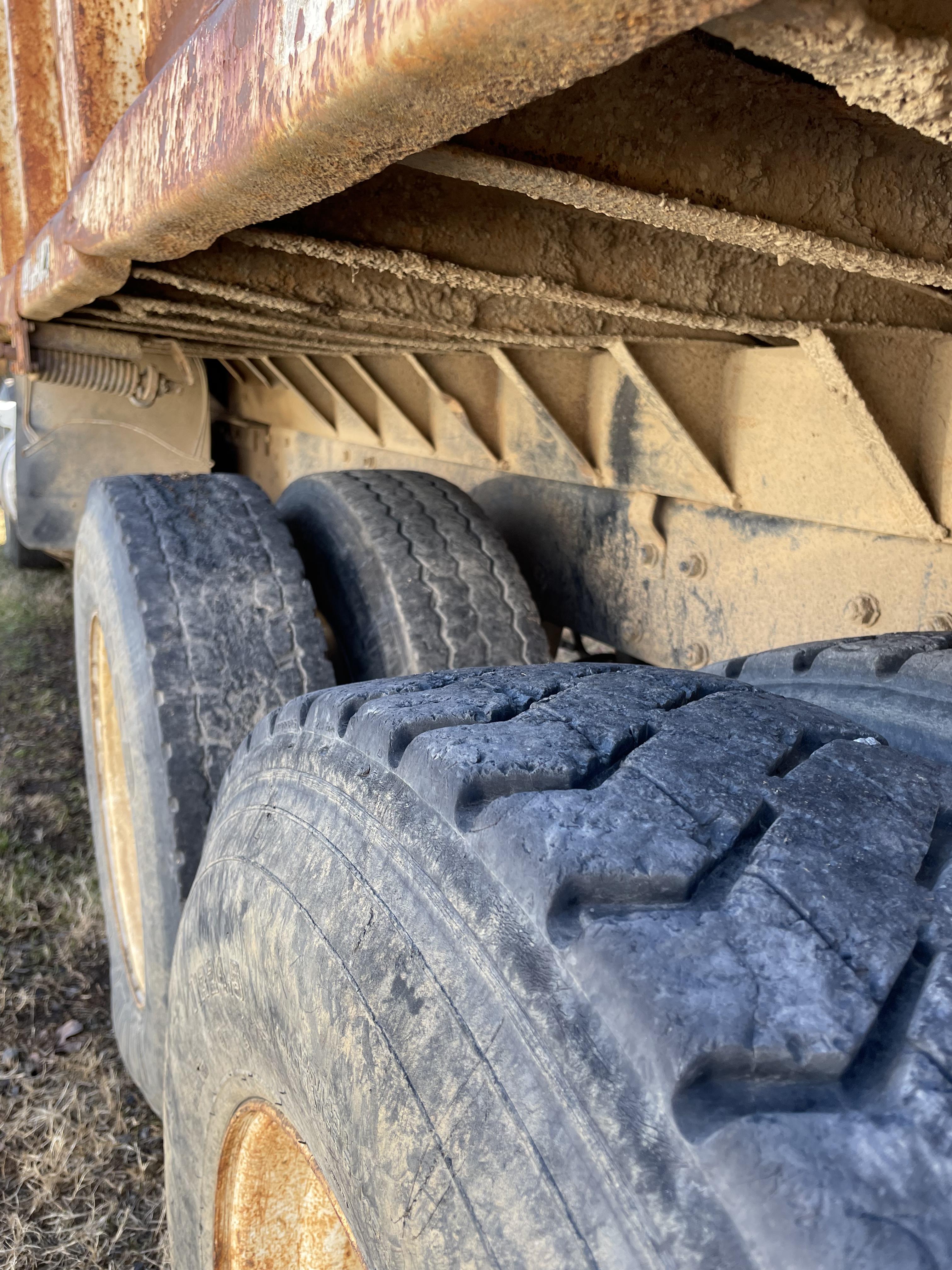

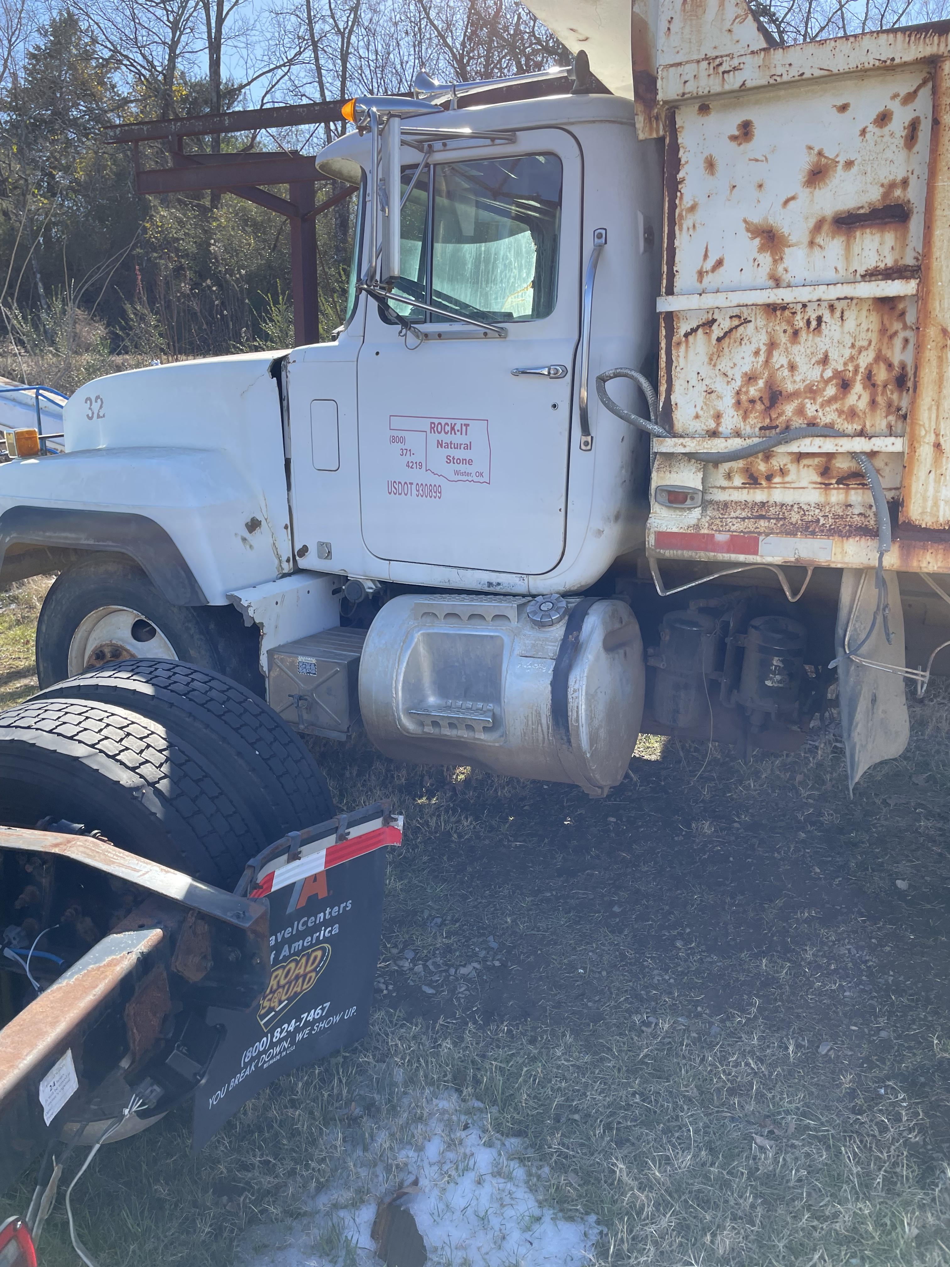

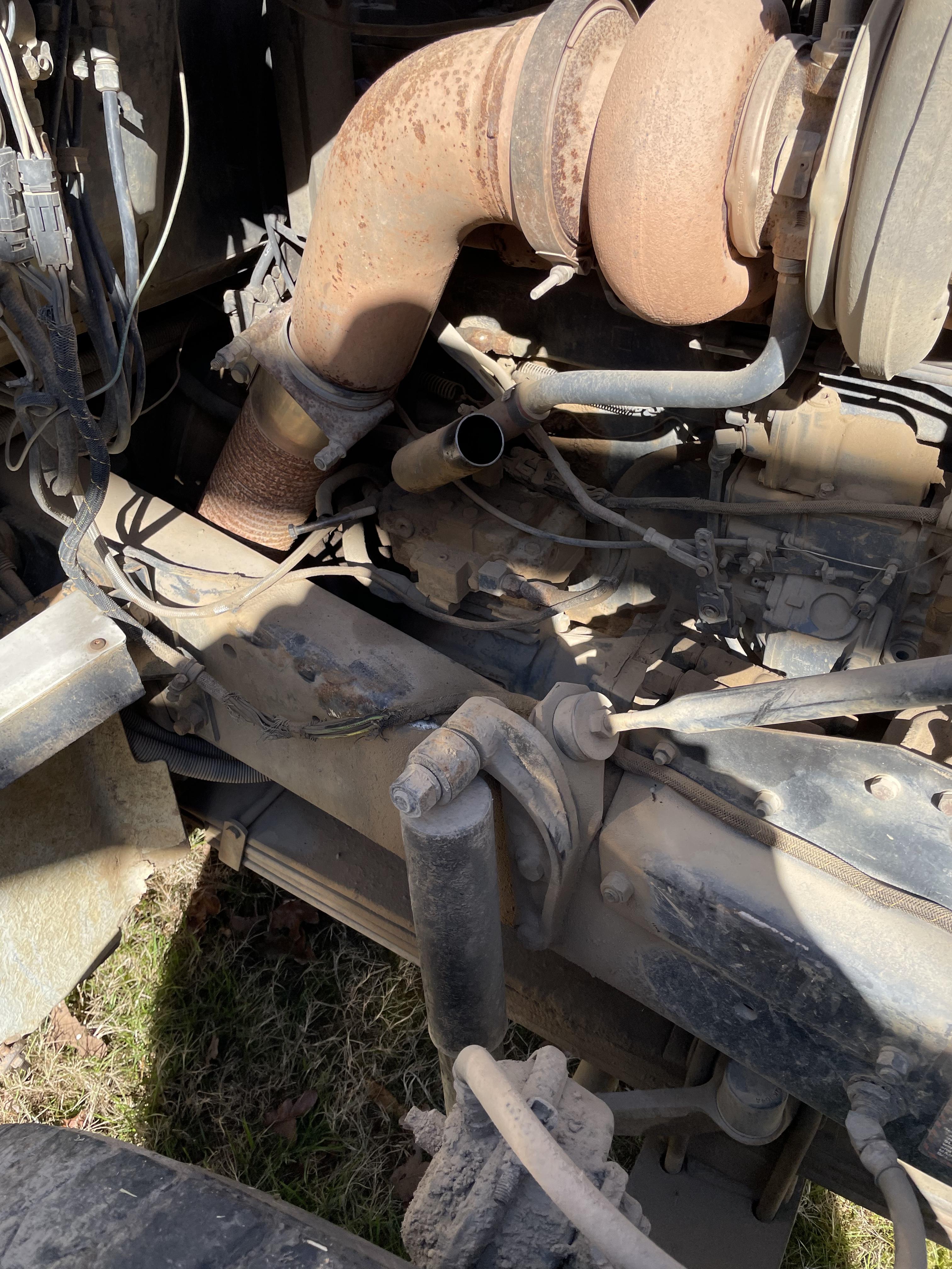

Ok I just looked at this 1995 RD 688 thats 5 miles from my house. The owner wasn’t there and Batteries were down so I wasn’t going jump it without him being there. It’s rough but can be bought for 11,000.00. I called the people that owned it (name was on side and they said it spent it’s whole life in a shell pit. It has lever controls on dump bed. Current owner says it runs and is mechanical sound. I’m going upload a lot of photos. Truck leaks at oil pan, has a leak behind filters on drivers side.
Edited by Ricky Beals
