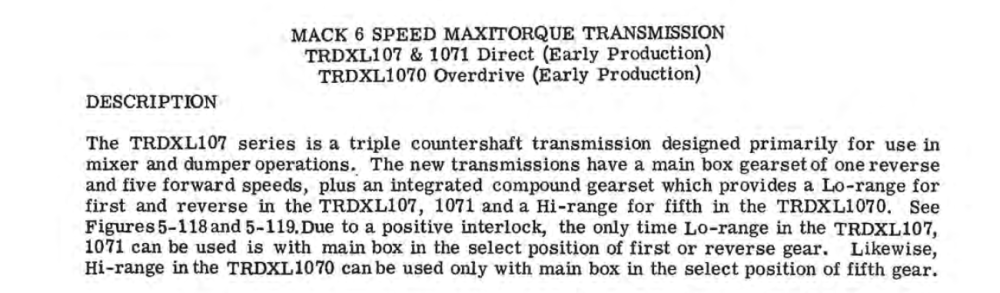

Here is some interesting info.  Apparently, there WAS a setup with OD in the rear box.  If this is the trans you have, then the OD on the compound stick can only be engaged when the main is in 5th.  But, I don't know if these had REV on the compound.  Doesn't sound like it.
I am going to dig more into the "late" production boxes, and see what they have.
Learn something new every day...

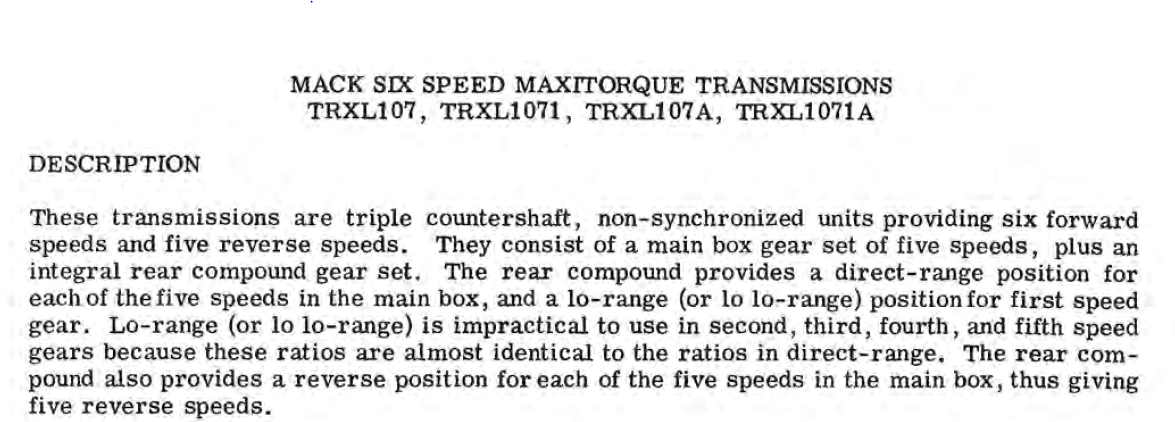

Here is some info about the later models, with REV on the compound stick.  But, I can't find anything on the OD versions (1070).  So, I don't know if they ever did one with OD AND REV both in the compound case.  But, it seems possible.  Again, the shift map plate would probably tell if it was a lo-hole or and OD setup.

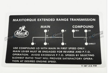

Here is the plate (off eBay) for a lo-hole model.
IF that's the original transmission and IF that's the original plate, and IF the plate is correct, and IF there was an overdrive in there, the plate would lead one to believe the overdrive was in the main box and the auxiliary was direct.
Of course, I would still spin the main box to be sure.  That's really the only way to tell for sure.  See if the output shaft turns the same as the input in 4th or 5th.

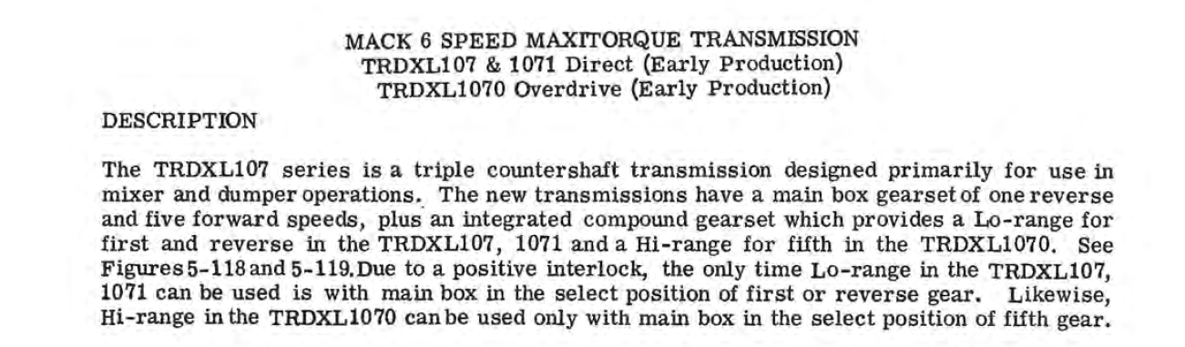

This is the real early six speed, the front box was a basic 5 speed with reverse, and the back box was a low and direct to use with the 4.17 rears, and the the overdrive had a direct and a wide overdrive to use with the slower rears that were used with the tri and quads transmissions.    terry:MackLogo:
Correct.  The "later" ones are the ones I was more familiar with, where the REV was in the compound box.  I don't think I ever saw the "early" one in person.
