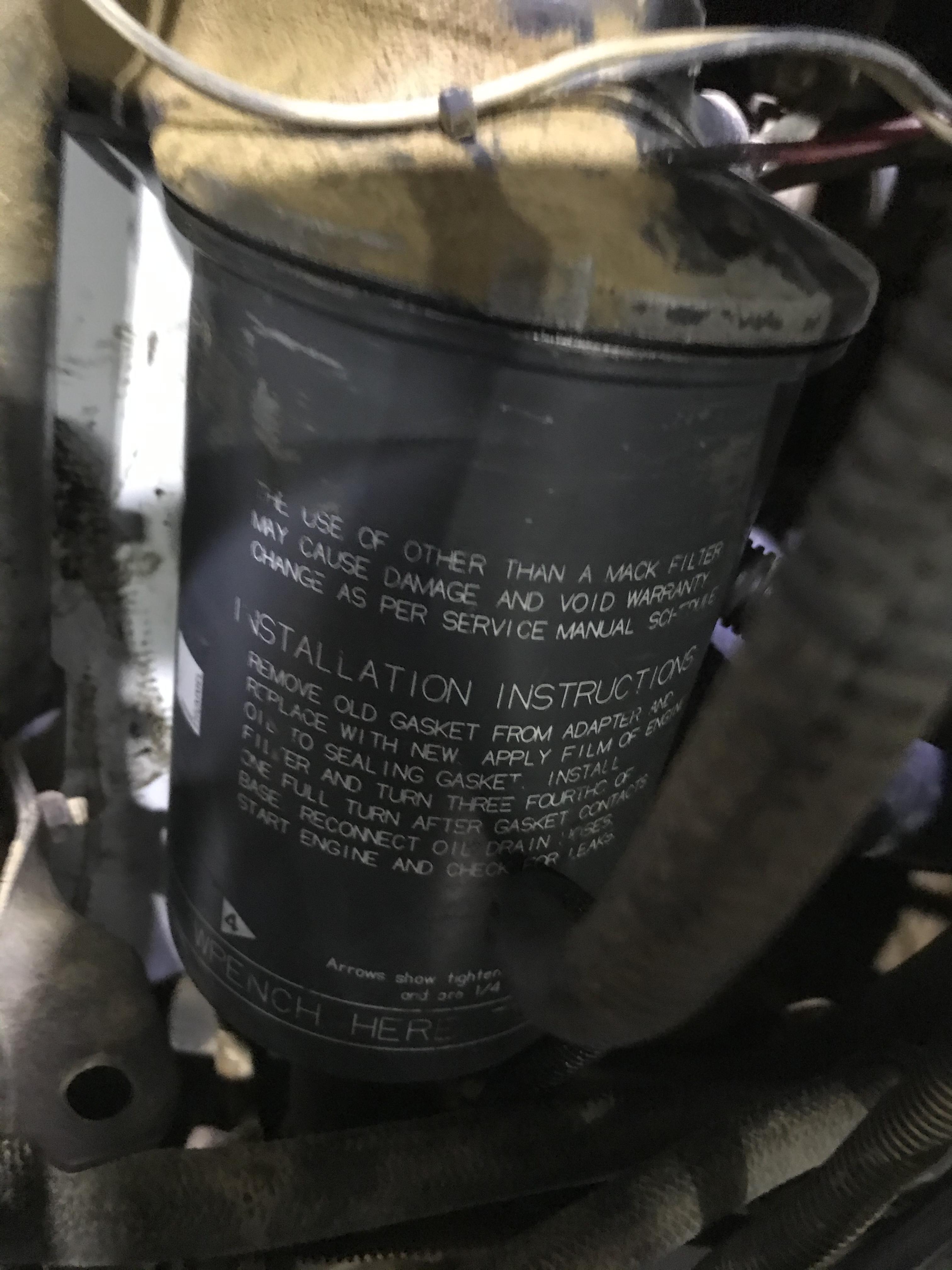

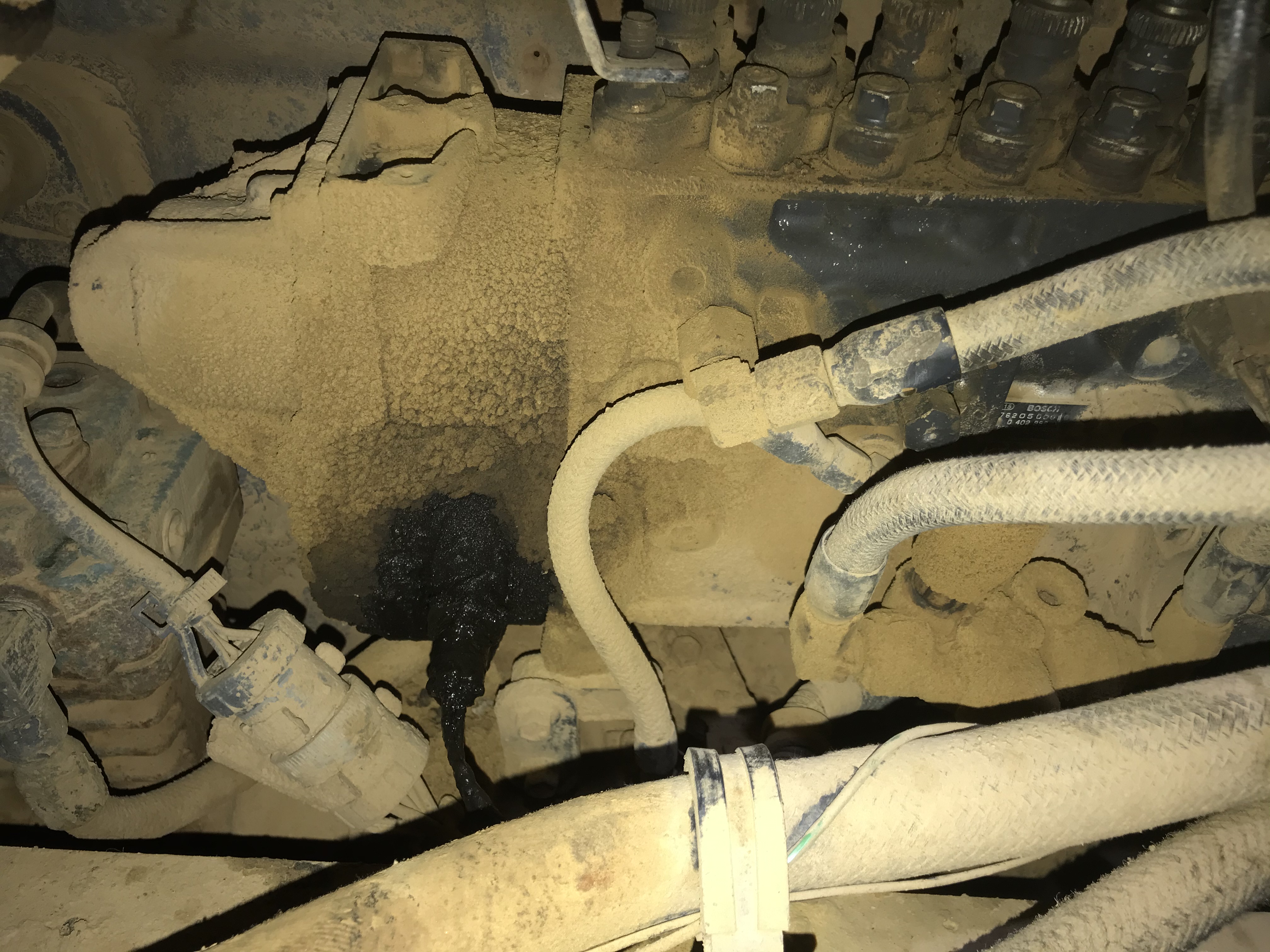

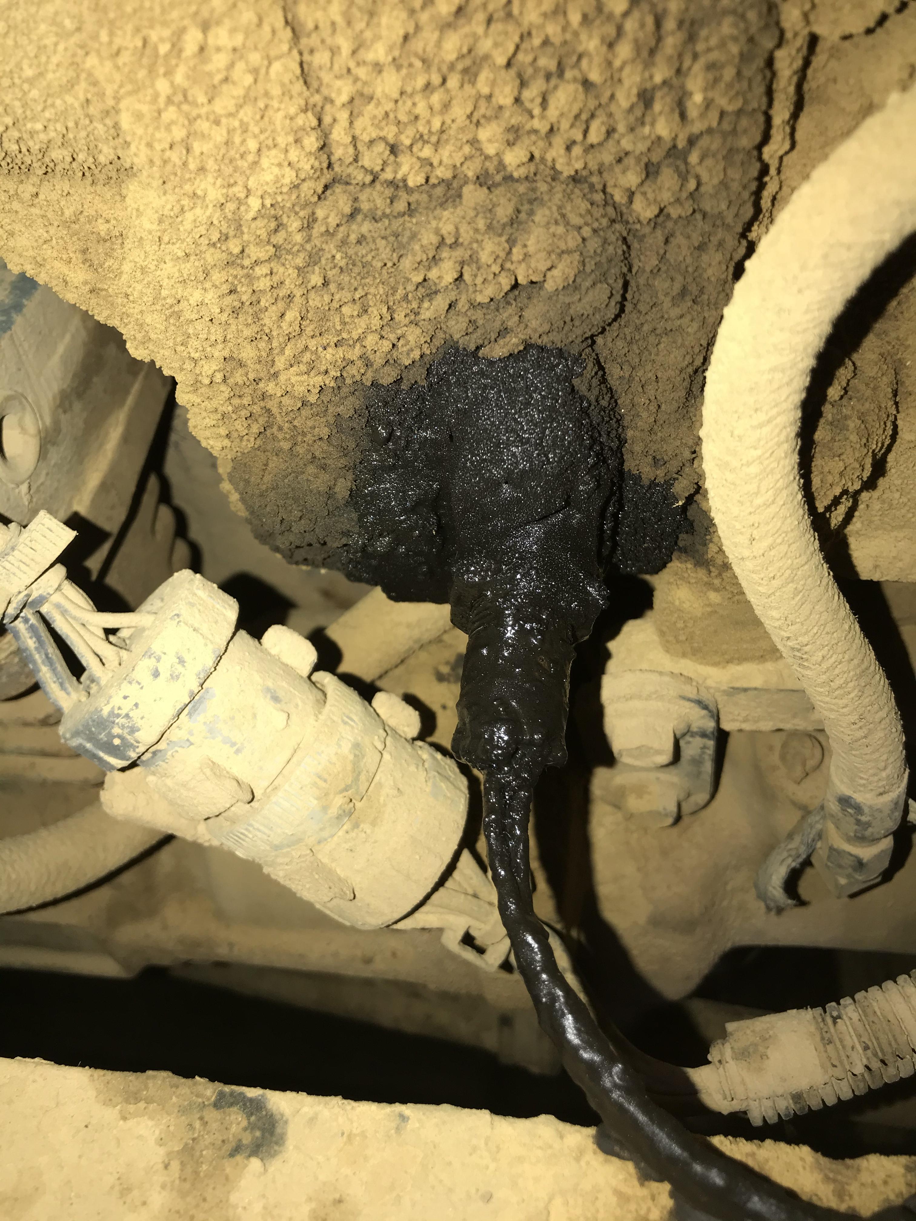

I started the truck up today after replacing fuel filters... rode the truck empty for about 45mins the “shutdown light” didn’t come on one time I drove the truck hard getting the temperature up to see would it come on and it didn’t. This was right before dark so it’s not as hot like the daytime. I have a picture of the injector pump should I replace this sensor since it’s a leak on it? The canister for my centrifugal filter is dented so it’s hitting the inside as it spins I wonder would that trigger the light and mess with oil pressure?
Yes clean the T.E.M. sensor... wash the mess off before you remove it.. Don't "F" around.... Do a good job! Pay attention to the keyway on the sensor.  The dented centrimax housing looks to be minor, when you shut the engine you should be able to hear the filter spin down, or have someone shut the truck off and you can feel it spin down, or... just change the housing...It wont effect oil pressure because it will just pump oil through it..
