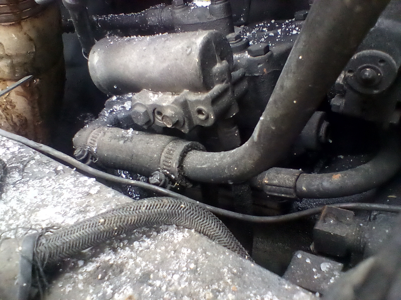

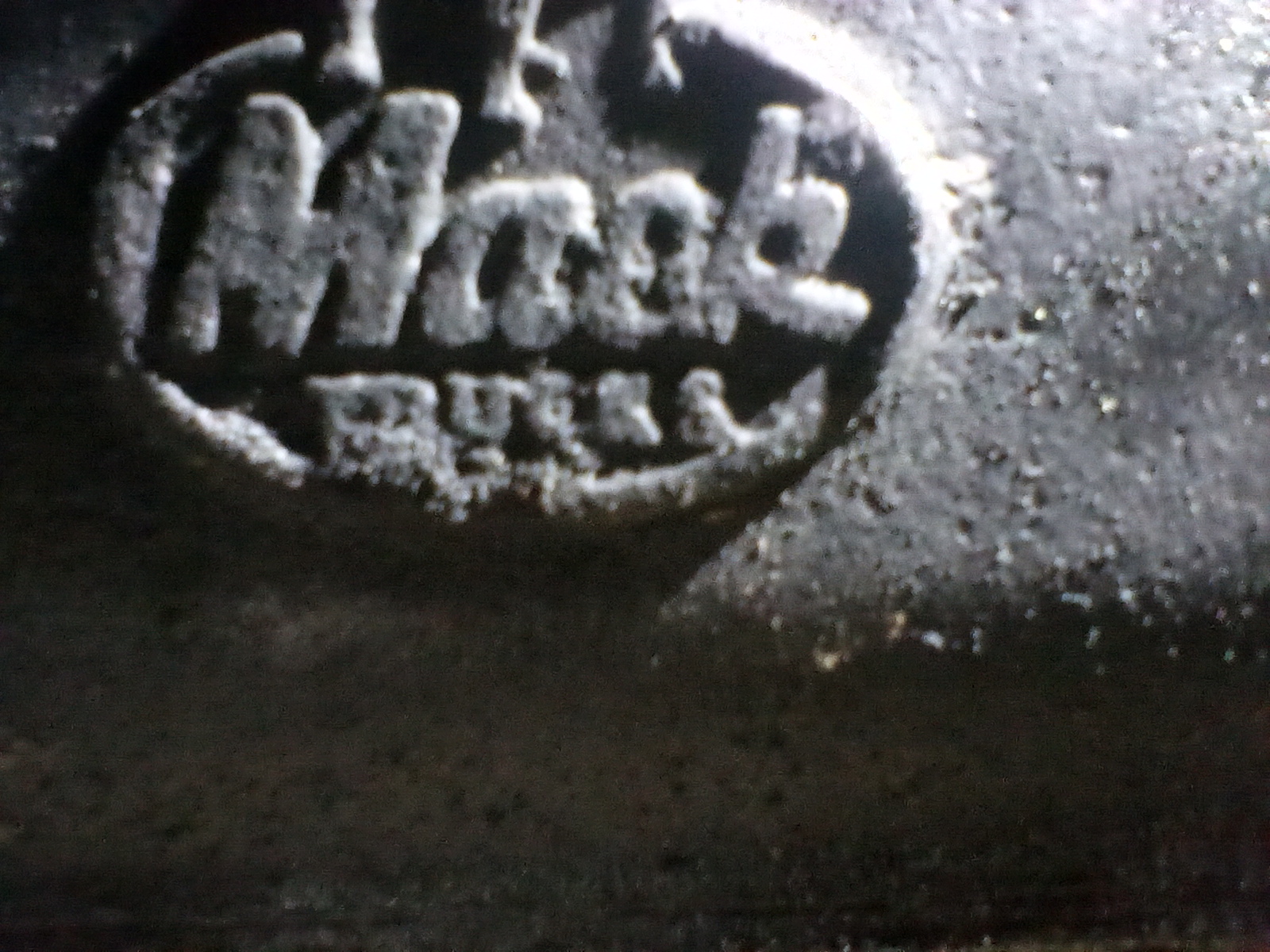

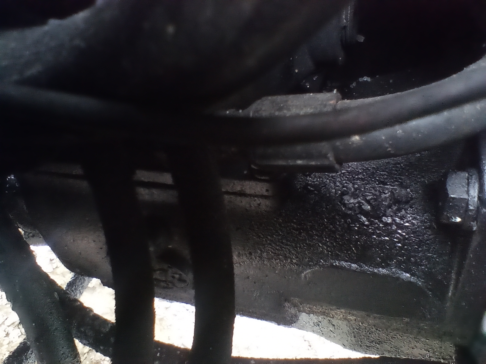

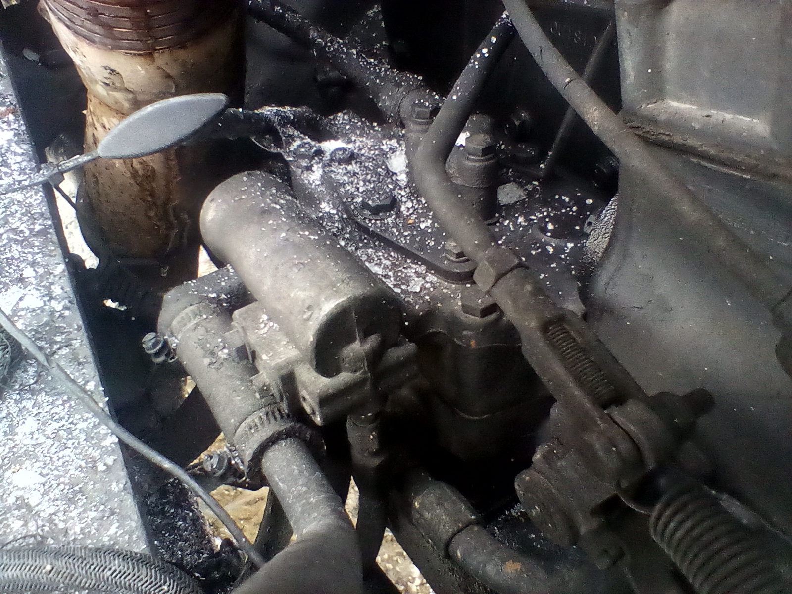

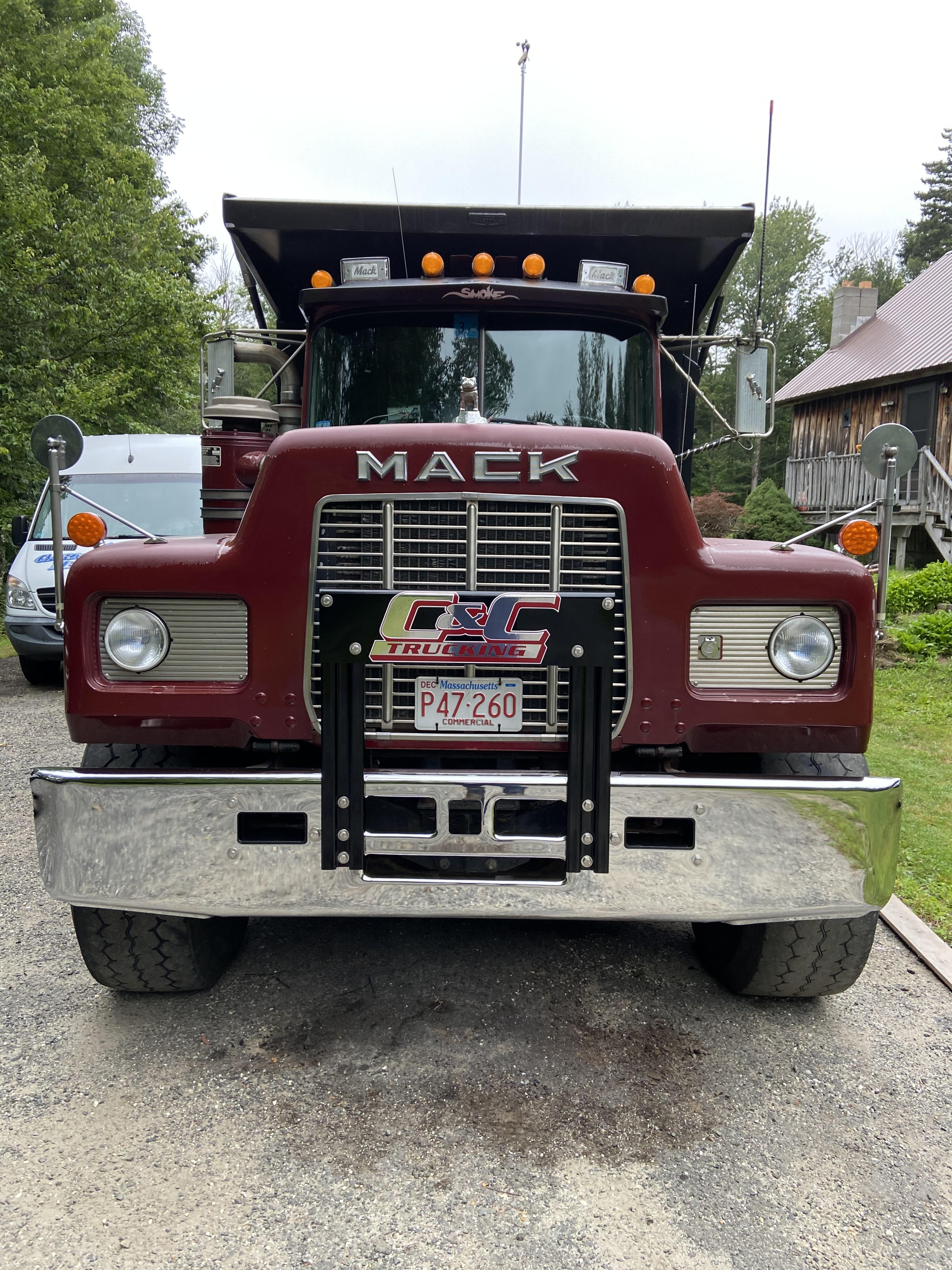

Hi, I'm needing a air compressor for my 1989 Mack, it has a E-6 350 Econodyne engine, local place I deal with that sells truck parts said they would need the number off the compressor to get the right one, but the numbers are wore off the tag can't read nothing on it. Was wondering if anyone would know what the model number is , or which compressor I would need?

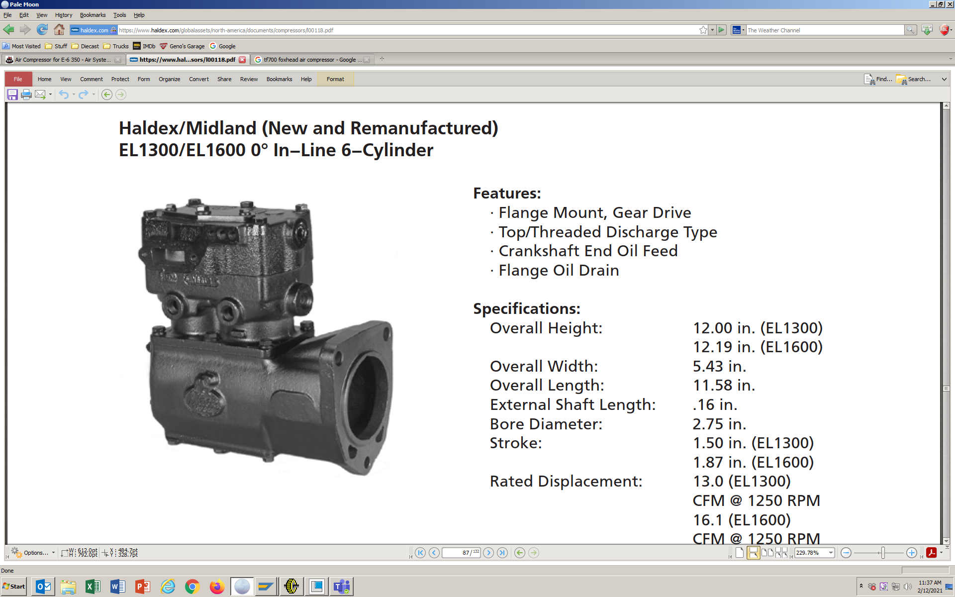

Yes, Midland. Easy to replace and I feel better than the Bendix 501 series as the unloaders for the valves can be serviced without removing the head.
EL1300 is most common in those years but they will interchange. The EL1600 is a higher displacement but the same physical size IIRC. Change your drive coupling too although the original may look perfect.

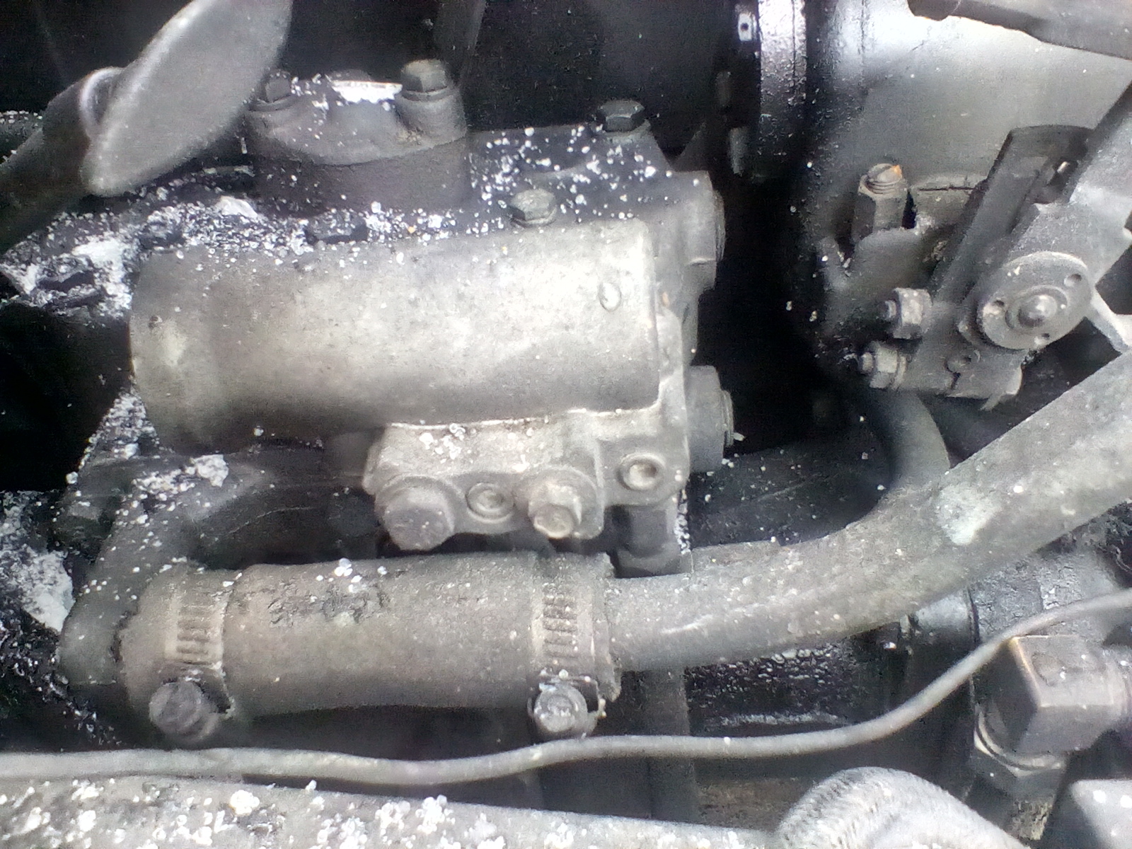

Power steering type which you look to have:
