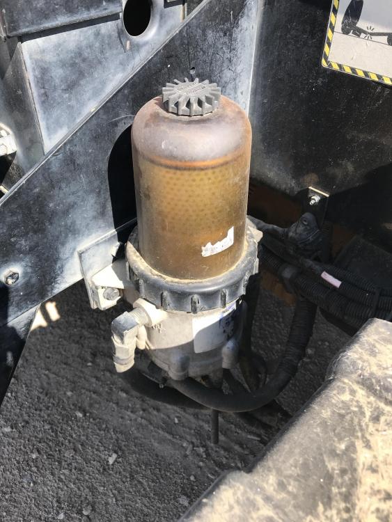

Throttle response.  I just got this MR688S out of the Postal delivery yard this morning and it limped out missing on one or two cylinders.  I took it for a test drive on a back road about a mile and it got progressively worse and now just idles with very little throttle response.  Trans was good.  Air cleaner clean.  Now, looking at clogged fuel filter/s on the drivers side of the engine.  The unit also has a DAVCO clear external filter - I don’t know what it does beyond being the first filter, then fuel goes over to the engine filters.
Any thoughts?
Thanks!

Water separator.

41 Chey -  thanks for the reply. I put myself through Mack school that day and that filter water separator was a complete locked up mess the bottom of the unit was black we cleaned it all out with brake cleaner and got it I got a new filter in truck started right up it’s been running great ever since it’s got a little air leak in the in the Davco fuel filter separator it drops down about an inch every man every two hours so we’re gonna work on that and see where the leak is it’s not a not an external leaks but other than that the trucks running great now

Miami Cossack - Thanks for the reply.  I rebuild wrecks and work on engines all the time.  OJT Mack school was cool.  I learned that the Postal guys don't do much maint beyond oil, filters, belts, etc... the truck was never cleaned, caked with dirt and grease on the suspension, engine, etc...  I'm not for pressure washing engines, but some degreaser and a bit of water from the garden hose goes a long way.  I'm steam pressure washing the undercarriage and detailing the engine this weekend.  I spent time on the Davco Filter/Separator and found some gunk in the ball check valve that was letting the reservoir drain around the filter.  She's staying full now.

Oh yeah, I forgot to mention that all the diagrams online for the Mack E-7 engine show and say that the two filters under the left/USA driver's side of the engine are Fuel Filters.  They even give a fuel filter part number for them.  I reality, they're OIL FILTERS on that tandem manifold.  Looks like all the fuel is filtered through the DAVCO Unit and that's it.
If anyone knows of other placements of secondary fuel flters on the E-7 Renault engine, please let me know.   I haven't been looking real hard after removing the two oil filters and getting them back on the engine and getting the DAVCO unit working properly with a new filter and cleaning.  It will be nice to know that I've hit every filter that's in that system and there are no other variables.
