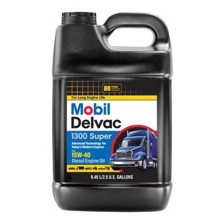

She is still wearing in but numbers look pretty good. I would like to see less iron content which is ring and liner wear but zinc, phosphorus, and calcium are up from the type oil selected I believe. I like Delvac 15W-40 in diesels myself which tends to yield a bit better numbers in my Mack engines.
Over time you will be pleased with the consistent results that oil provides. It is especially well suited to older Mack engines where ash deposits were a major sludge contributor in mechanical engines.
