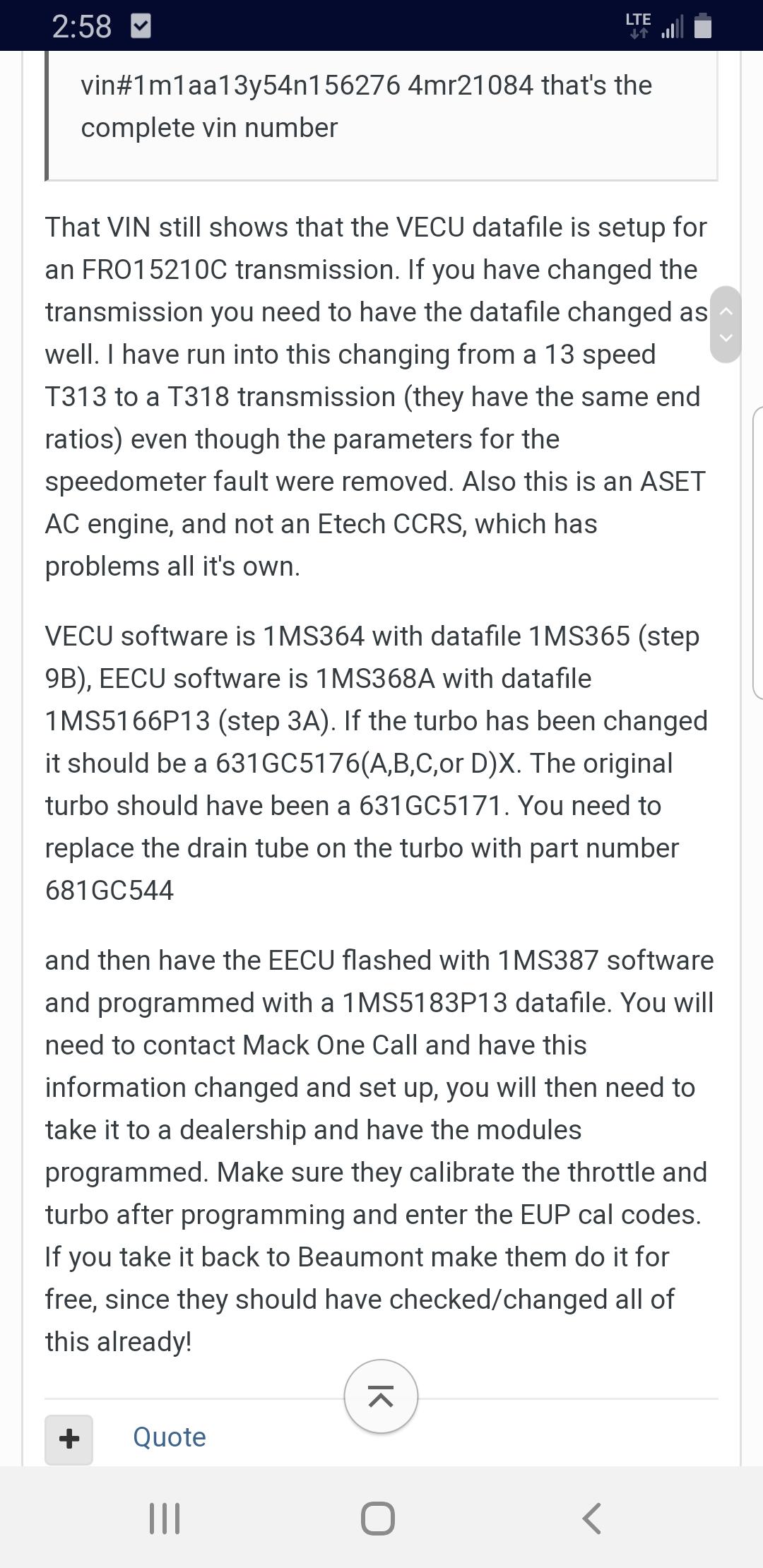

Hi guys. I have a 2005 mack vision with an aset engine, been running it on the farm for a couple years. Always thought it was a bit low on power and boost was a bit high but it worked so I just kept driving. This fall however on my way home one night I could not get up to 60mph on the highway. Since then I can only get up to highway speed empty and even then the boost is continually 25-30 psi. Loaded I cannot get up to highway speed and boost rises as high as 33ish psi. There are a few codes present.

I was reading a post from a few years ago of about an 03 model with what seems to be very similar problems.
