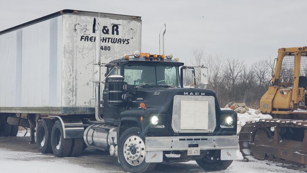

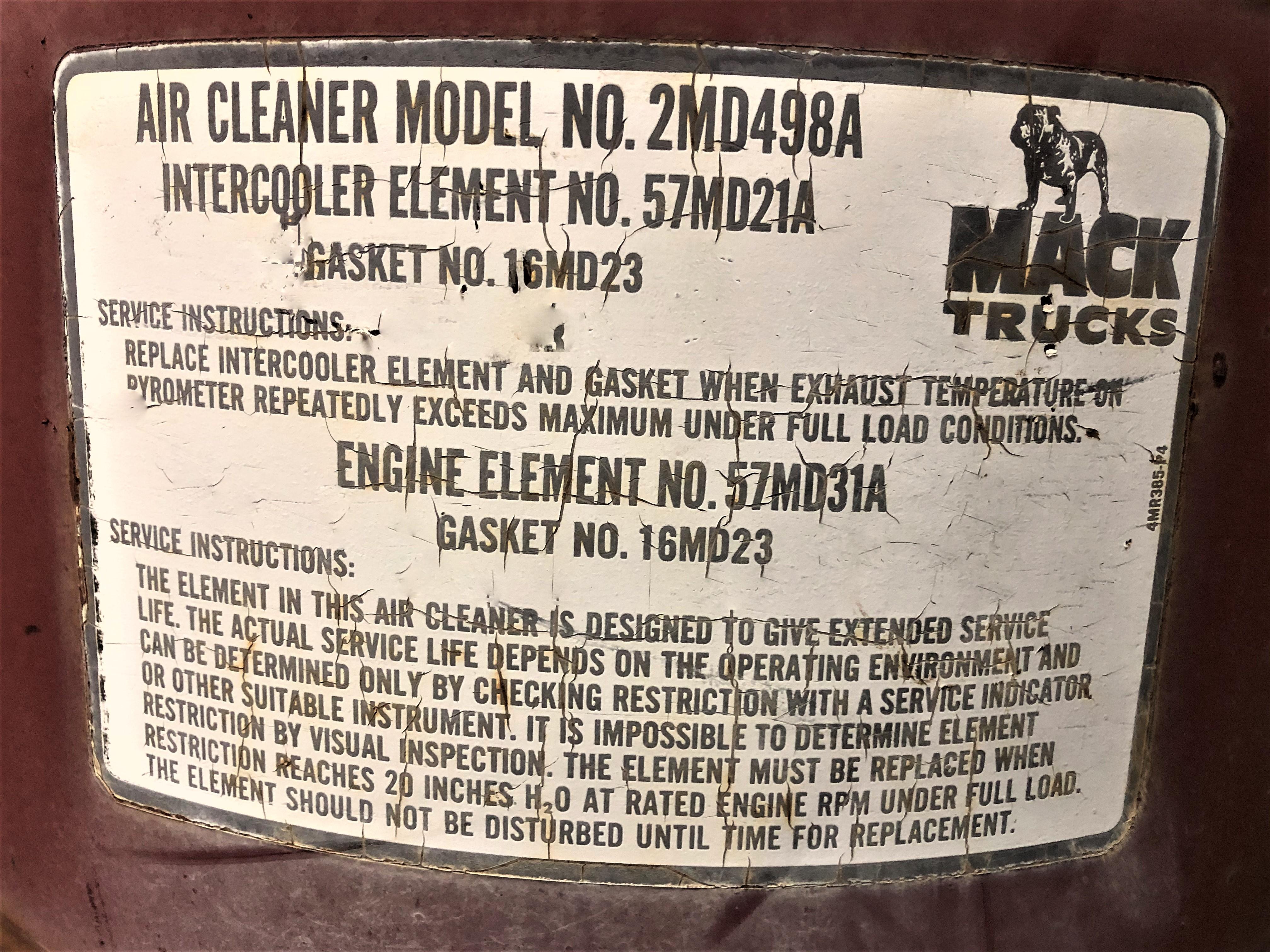

Looking for the correct part numbers for the air filters that go in a Donaldson twin outlet housing . it has a upper and lower filter and I would like to replace them but I cant see a part number on the ones in the truck.  Also is there a radial seal upgrade to the standard original style?
The Truck Vin is a RS78632474LST its a 77 Mack with a tip turbine engine/ duel outlet housing

No problem Trent,  I am reproducing just about every decal for the truck inside and out made up. If your interested in a new air cleaner decal let me know. They were only a few bucks to have reproduced and look perfect. Mack/Volvo 🤢 no longer stocks or supplies them which I am sure your aware.
I'd be interested in some of the decals myself. Probably one, or two for the air cleaner housing but I don't know about the dash decals as of yet. Some were long gone prior to my acquisition(s). I looked all over my shop spares for the decal you asked about earlier, but had nothing available.
