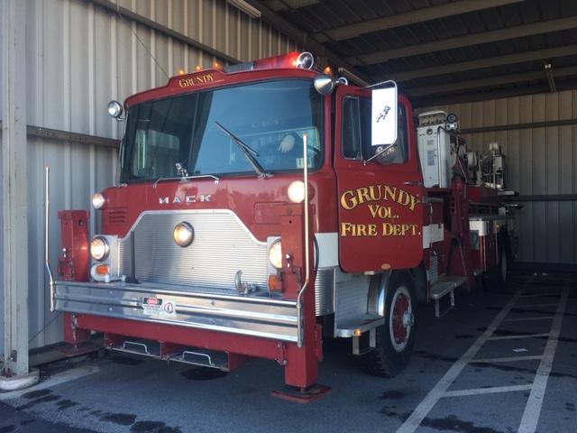

Hi all,
My search for a CF Aerialscope finally yielded one at a reasonable price. The truck just came out of service from a fire department that was looking for a new truck with taller ladder. My Mack is in pretty decent shape, but she's definitely been around the block since being delivered to the FDNY in 1973. I sent an e-mail to the Mack Museum, but I was curious if anyone had an info about my Mack - VIN is CF611FAP1557.
My other question is...how do you fly the bucket? I used to volunteer and went through an aerial operators course, but I don't have the manual for the Baker scope and don't want to guess about how to send power to the hydraulics, etc.
