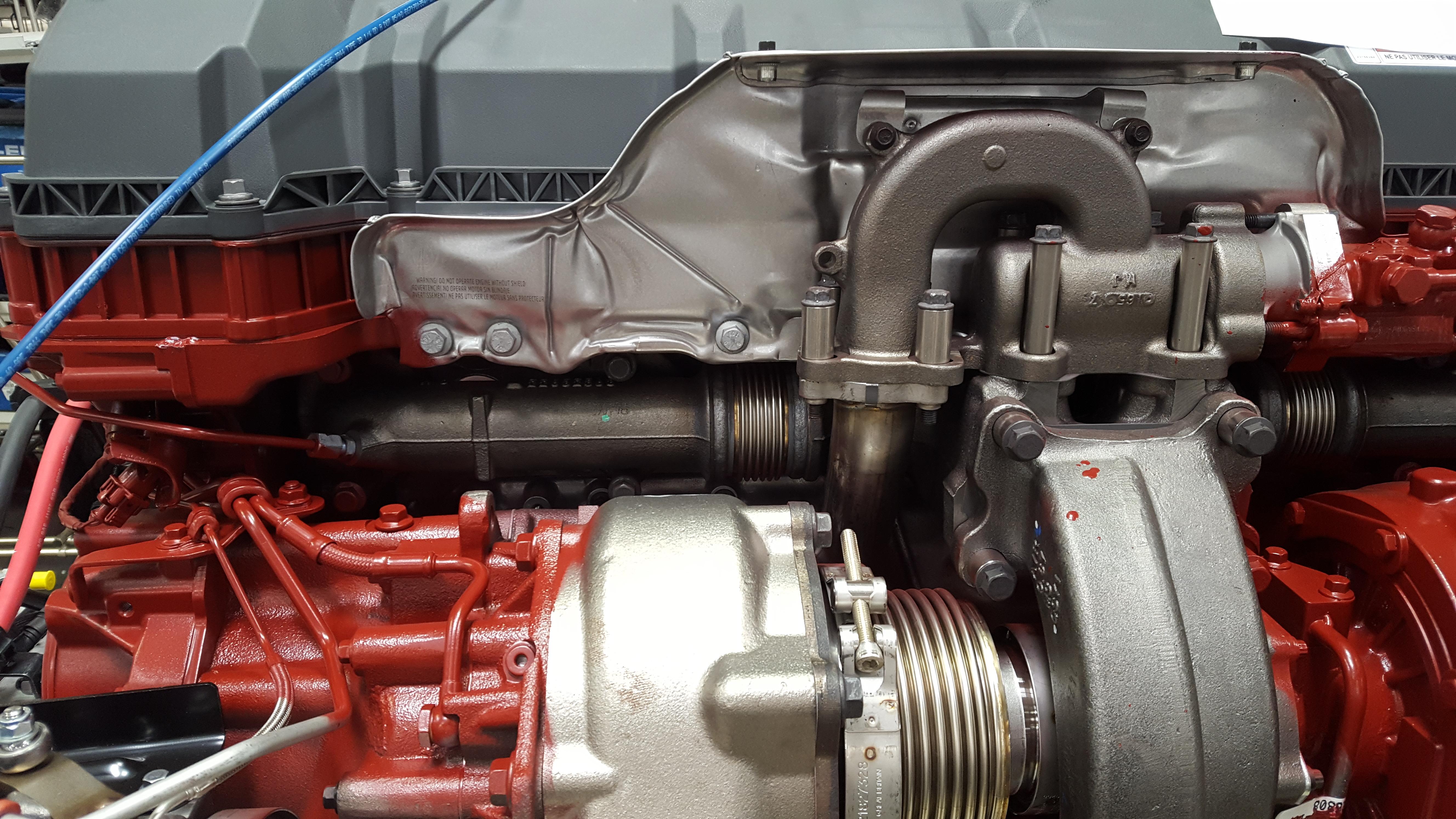

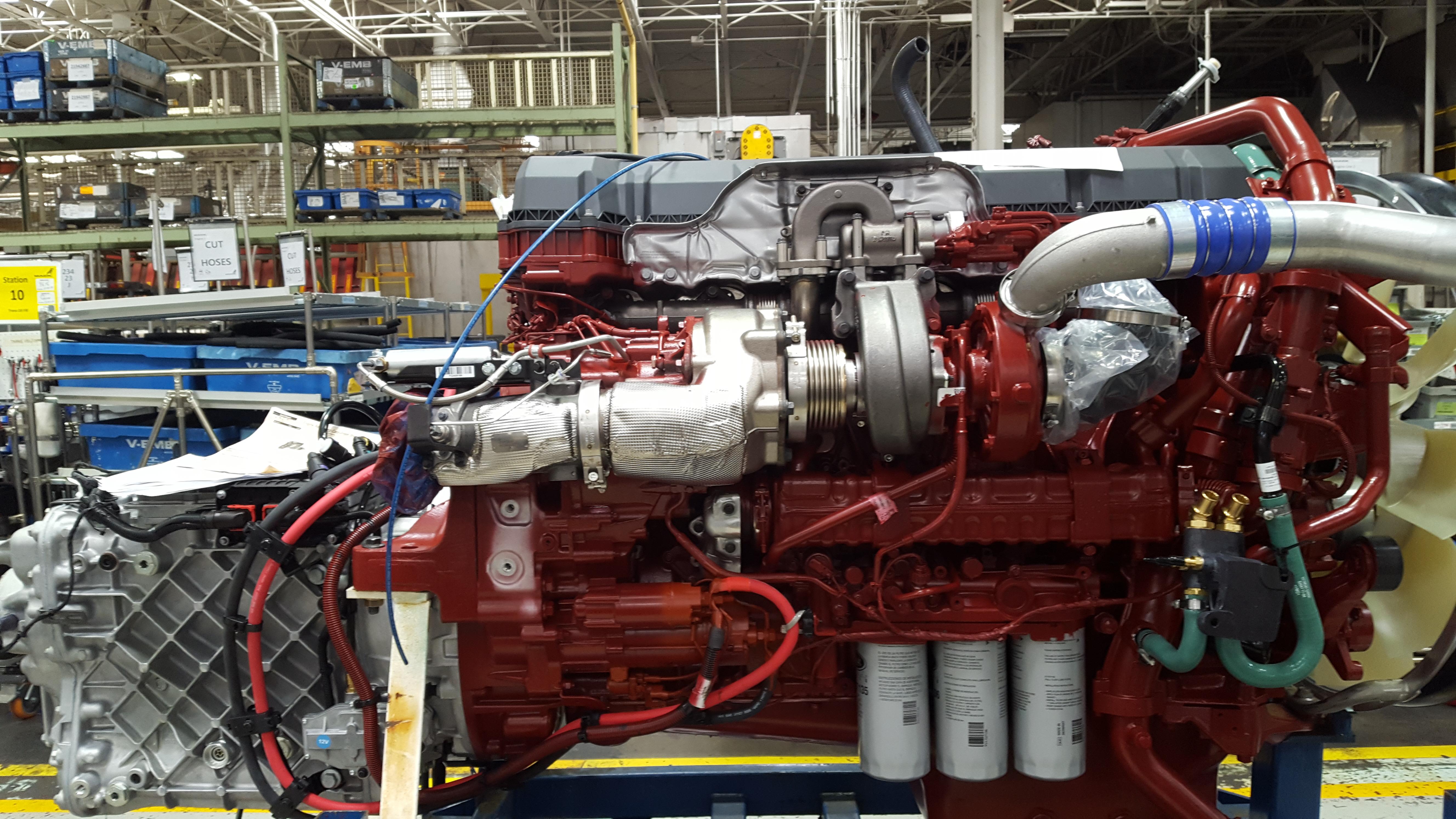

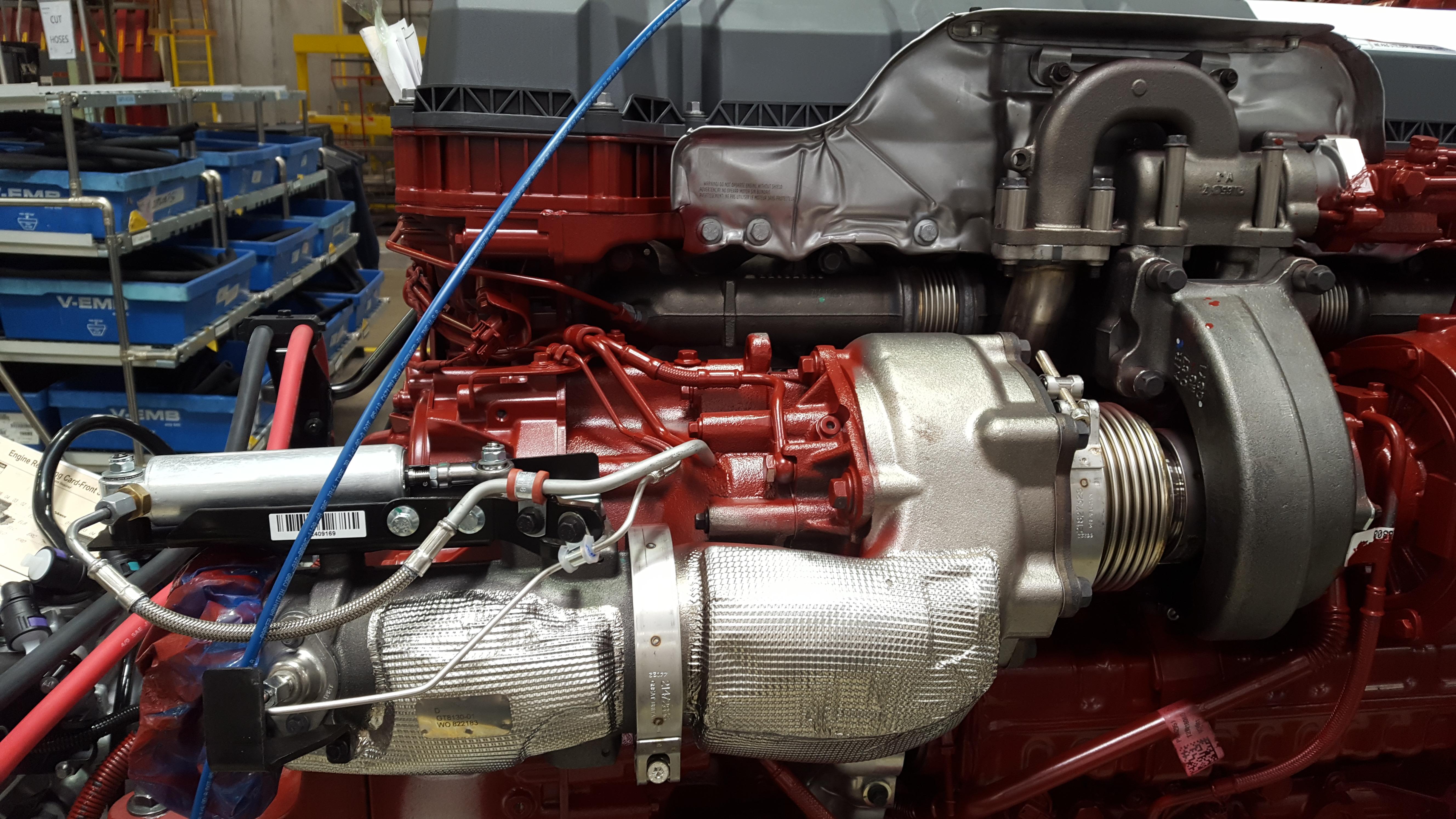

I was able to get some pictures of the only MP8HE engine coming down the grooming line at the Macungie plant on Saturday. For those that don't know, this is the engine option where the wasted heat energy from the turbo has a drive coupling back to the timing gears, producing more power and torque to the flywheel.

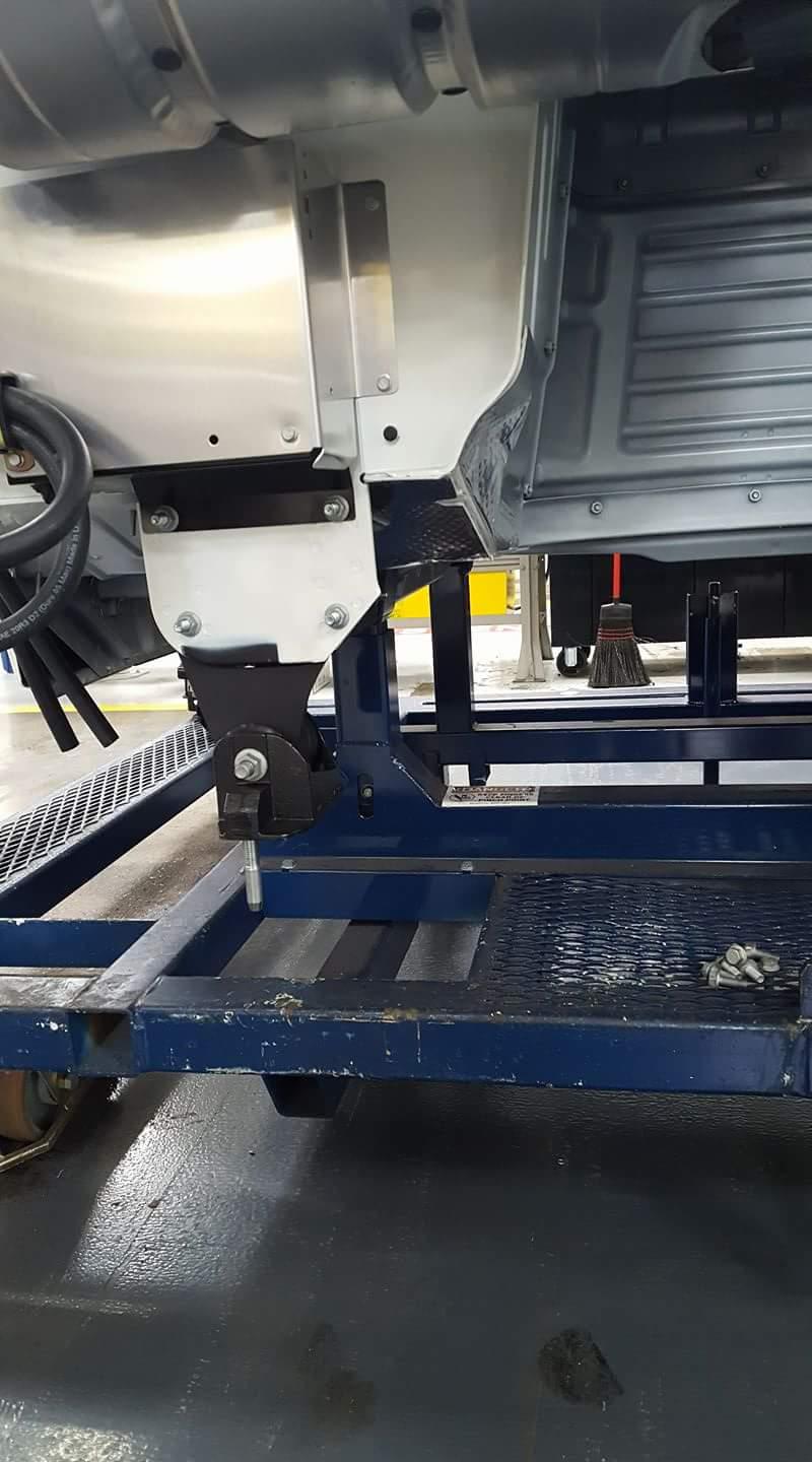

They had to redesign the cab mounts and shave the RS cab mount plate just to get this thing under the cab.
I will let time and the marketplace determine if this engine option is a success or not.  I'm not looking forward to having to work on it when the time comes. The Volvo version which I've only seen 2 in use so far, has a little more room to work on.

I like IT:rolleyes:! Get rid of the piece of crap bolted to the back of the turbo And now you got an EGR Valve that's easily  accessible you can actually see what your working on Beauty ! :rolleyes: Oh you say you can only buy it with the crap behind the turbo? Dam!
  • Haha 1
what's old is new again.....
power recovery turbines were used by Curtiss Wright on their radial aircraft engine the R-3350... used primarily on the Douglas DC-7 and Lockheed Super Constellation airliners, three PRT's used exhaust flow to transfer power to the crankshaft raising power from about 2800hp up to 3500hp.... recent adaptations in air racing with nitrous has seen 4500hp...
and no EGR valve...!!!
