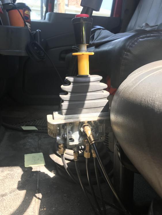

Looks like I might make the change, got to see if it makes a difference.  Anyone that has one as loud as mine will understand and hopefully it'll work and help out some other guy down the road.  The air operated hoist control is new to me, I've always had the cable. Is there anything I should know or look for, or is it a just a bad idea for a tri axle dump truck?  Any info would be a help.  Thanks

Good morning, I appreciate your suggestion. I've tried putting rubber everywhere imaginable. Put rubber o rings in between the pin connection at cable and PTO, thick rubber on and around the cable bracket and in between cable and bracket. I also put extra sound deadening material on the inside of my control tower.  I've been desperate to eliminate this problem.  lol  I think the only way to help with the cable would be to have some type of plastic connection between PTO and cable. Even then sound travels  through hard plastic fairly well.  Installing air shift next week with polyethylene lines, the quietest way to go.

Hello, I ended up selling that truck.  The air control made a huge difference but the noise was still there.  It's like that with most Allison's.  Have a friend that just bought a new Pete with the Allison 4700 and it does the same thing.  Some are just worse than others and I've seen some that make very little to no noise.  Good luck!
