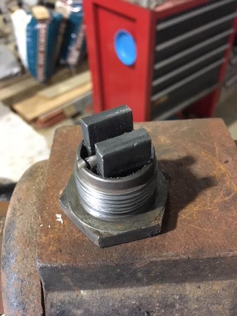

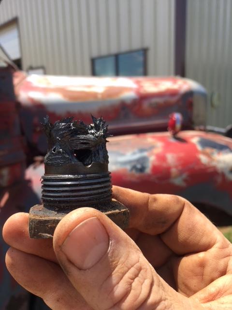

I drained the transmission and compound unit oil from my 1964 B61 5 speed.  1.5 pints of  clean red oil came out.  I can only guess why a prior owner or technician would do that.  The oil looked unused.  The magnetic plug showed signs of use as the photos show.  The Mack operator's manual specifies SAE 140 Straight Mineral Oil where the ambient temperature is above 50 F.   My local NAPA store carries a SAE 90 Mineral Oil but not the 140.  I can get SAE 140 Mineral Oil online and maybe from a local oil supplier.  I read online that the EP additives are not good for the yellow metals in the transmission so I'm staying away from that.
