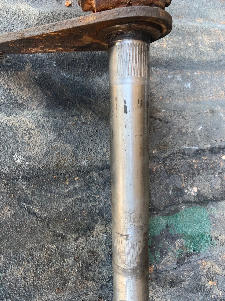

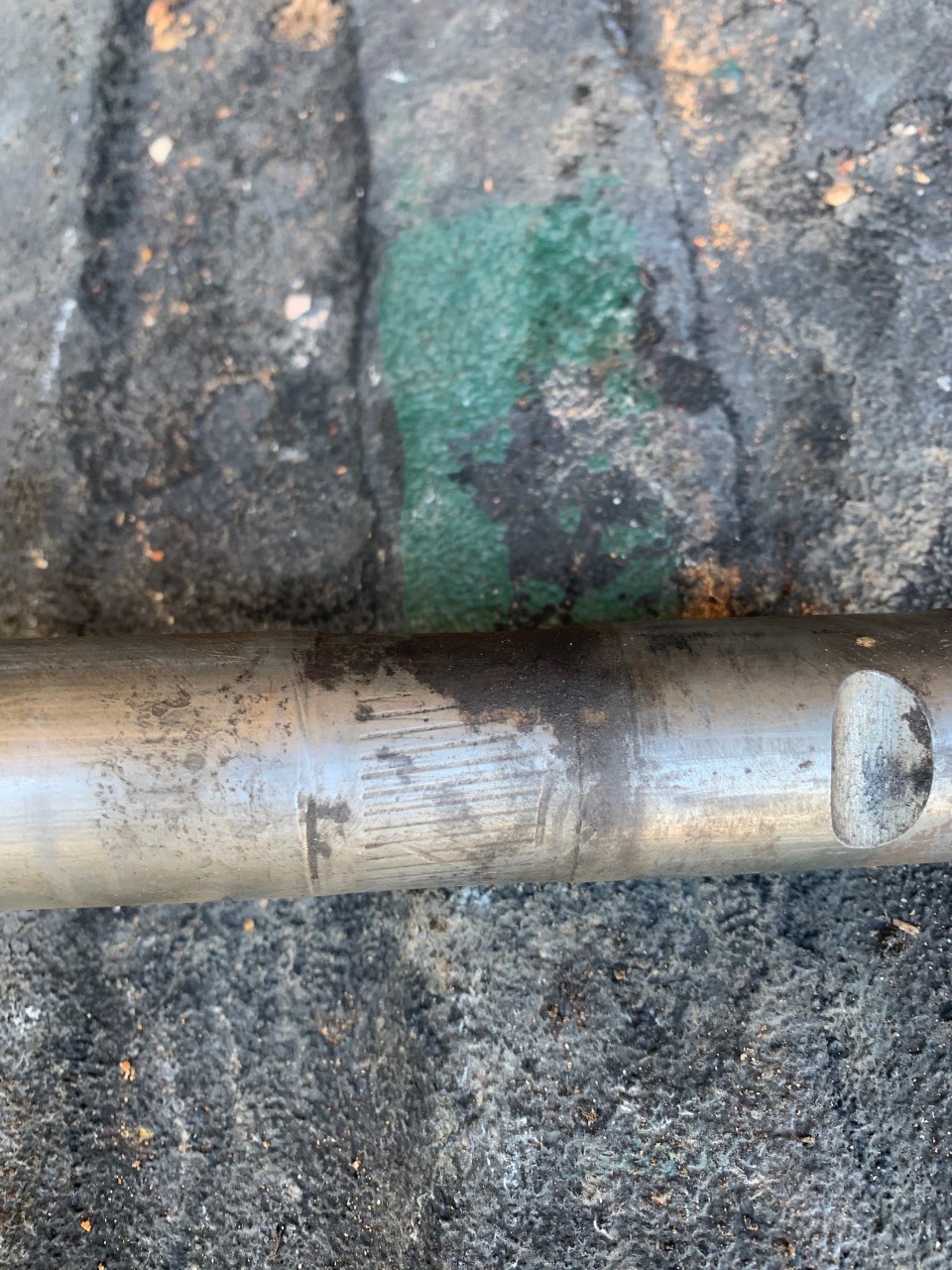

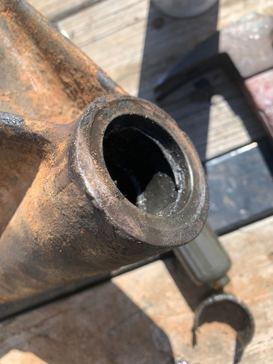

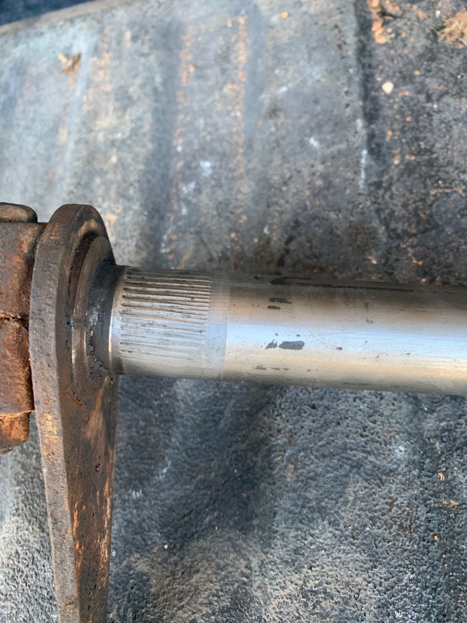

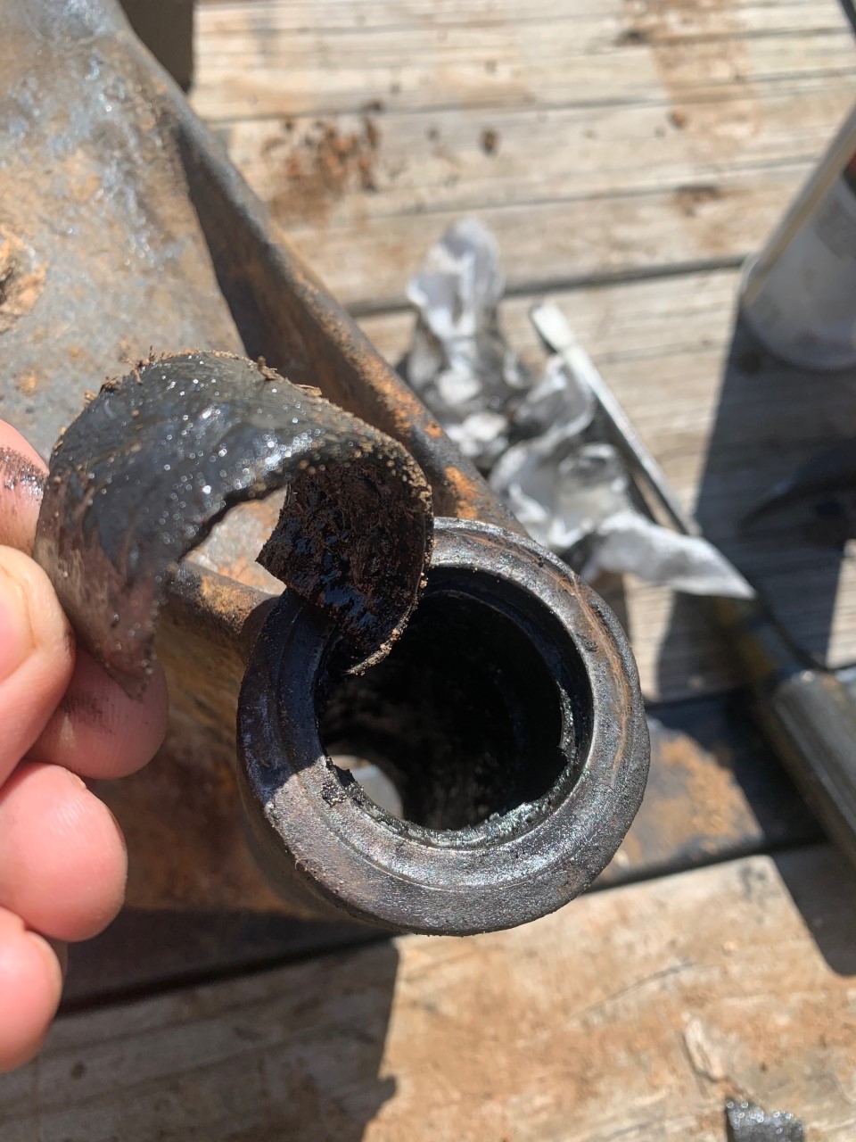

  1. Thank you Dave and Rob for the great ideas. I checked the bores where the two needle bearings sit, and the bores are in better shape then I first thought. The housing bore and the bearing surfaces are not exactly aligned. Meaning the bearing bores are not in the middle of the housing bore. Line boring the housing sounds interesting. I'll take that housing with me when I drop off an AMC 304 V8 for machining, and see what the shop says about the clutch pedal shaft bore. I can ask about building up and hardening the clutch pedal shaft too. I found a company in BC Canada, Dendoff, that will make the 2QK2360B springs new for me at a reasonable price. I don't think my old springs are worth much from a rebuilding standpoint. Either of you ever buy new rubber pads that hold the springs in the front hanger assembly? If so, then let me know where you got them. Thanks again, Earl
  2. If I was near PA, then I would bring the assembly by for some work. I don't have a lathe, yet. It's been on my mind to get one. I finally removed the two broken cab mount bolts (1/2"-13) from the hanger yesterday. I need to punch out the remaining bearing shell today. The clutch shaft is definitely marred. The shaft bore is a bigger concern. It looks like the bearings have worn their way into the bore similar to how the leaf spring pin bushings wore into their bore. I'll know more when I get the remaining bearing shell out and get an unobstructed view. I'll check into the 660 bronze bushing idea. I've been thinking bushings could be the best fix for a shaft and bore in this condition. Definitely not fussy Just looking for an adequate fix for now.
  3. Anybody know the part number for the two needle bearings that support the clutch pedal shaft on a B61? The clutch pedal shaft sits in the driver side springhanger. The bore in the spring hander is 1.5" and the clutch pedal shaft is 1.25" in diameter. The bearing looks to be about 1" in width. The needles are about .900" in length. Anybody replaced these bearings or fixed a situation where the bearings are gone? The clutch pedal end bearing shell had worn through one side, so it came out with a screwdriver. The clutch end of the springhanger is where I pulled out the needles in the photo. The inner bearing shell is gone but the outer shell is stuck in the bore but good. Thanks. I searched by the sizes I reported and vxb.com has a SCE2020 that is 1.25 x 1.5 x 1.25 that might work.

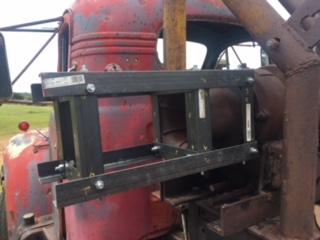

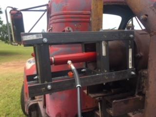

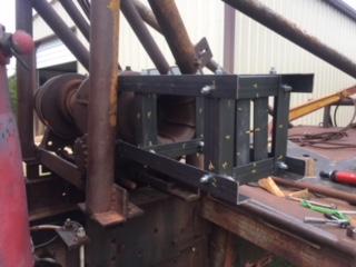

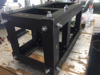

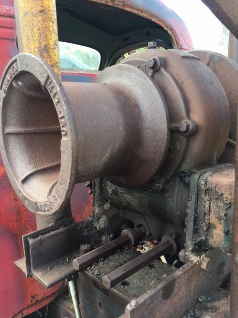

  10. This M9-18B Braden winch hasn't seen service in decades. The seals are leaking and I need to get to the winch internals. The capstans are in the way and will not come off using heat or light-duty pulling. I built a puller out of 2" x 2" x 1/8" angle iron. The push point was made of 2" x 2" x 3/16" angle iron because the 1/8" iron bent. I used a 10 ton porta-power hydraulic ram and it took most of its power to remove the driver side capstan. Here are a few pics and a short video. Notice the loud popping as the capstan hops off the shaft. The passenger side capstan came off with about 1/2 the effort. IMG_7230.MOV

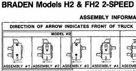

  11. I'm looking for a Braden H2 vertical mount hanger bearing with the input and output shafts on the same side. The speed shifter can be on either side of the gear box frame. The one that I have has the yoke and the sprocket welded to the bearing shafts and the case has been broken and welded back together. Thanks

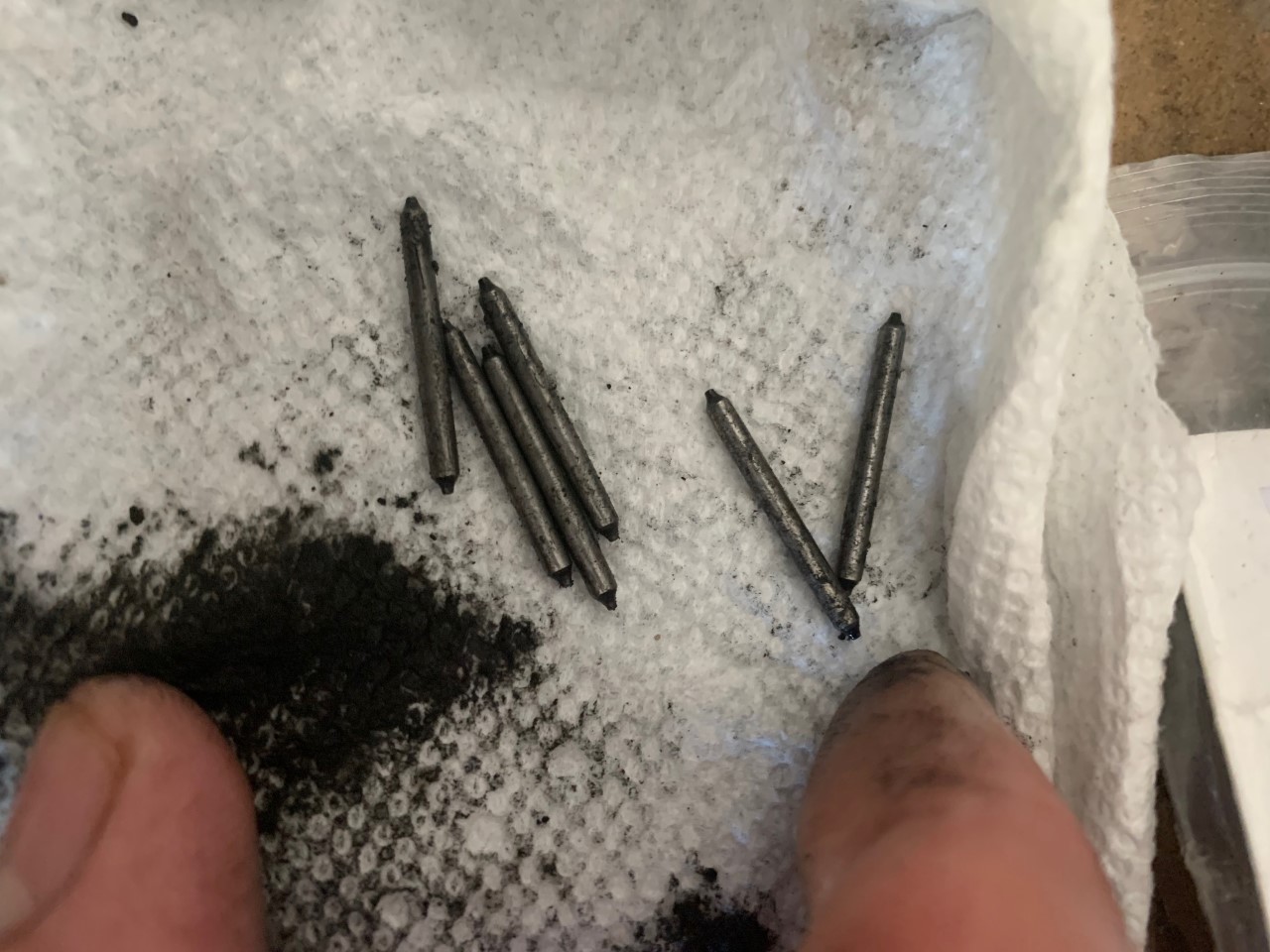

  15. I drained the transmission and compound unit oil from my 1964 B61 5 speed. 1.5 pints of clean red oil came out. I can only guess why a prior owner or technician would do that. The oil looked unused. The magnetic plug showed signs of use as the photos show. The Mack operator's manual specifies SAE 140 Straight Mineral Oil where the ambient temperature is above 50 F. My local NAPA store carries a SAE 90 Mineral Oil but not the 140. I can get SAE 140 Mineral Oil online and maybe from a local oil supplier. I read online that the EP additives are not good for the yellow metals in the transmission so I'm staying away from that. Is there a modern gear oil that is as good as the mineral oil Mack specified back in the 60's? Thanks

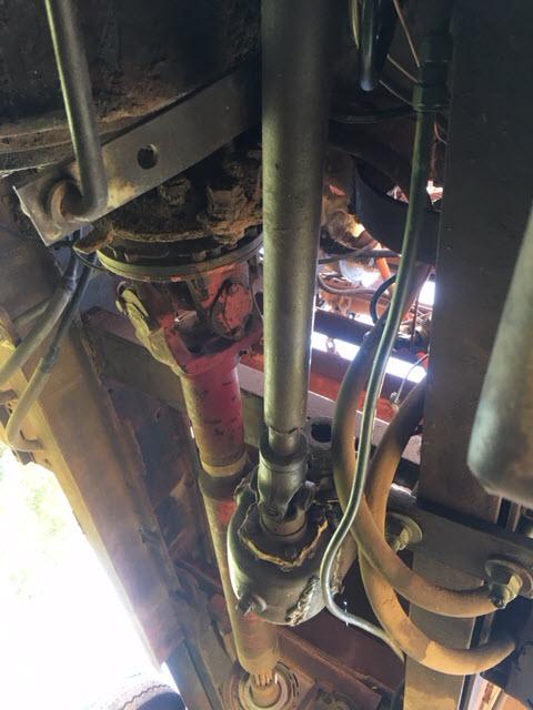

  19. I finally got back to town and got a little quality time with the B61. The compound shifter linkage has been cleaned and reassembled and it shifts like butter. There was a piece of steel between the rear clevis and the transmission housing that was keeping the rail from traveling backwards. I assume the piece of steel fell through the hole for the series-parallel switch or the hole for the PTO shifter. Here is a photo of some of what I found in the dirt packed around the compound shifter linkage. Now to get the passenger door to open. Thanks again for the advice.

  21. Thanks Rob. I pulled the floorboard to get better access. I need to get to the treadle lines anyway. This project is part mechanical and part archaeological dig. I wonder quite a bit if this truck was ever parked in an West Texas river for a time. It has dirt everywhere. I think this truck spent much of its time in the West Texas oil fields, but it is hard to imagine even 50 years in West Texas could accumulate this much dirt. The compound shifter is removed. The Lo-Split, inside rail, is stuck inside the shifter and doesn't move. I have it soaking in diesel. I used the fine oxide sandpaper to clean the rust off as best I can. The Hi-Split, outside rail, came out of the shifter fairly easily. Is there any way to tell if the Lo-Split on the transmission will move without reinstalling the compound stick assembly. I'm not sure how much force is needed to make it move, but given the size of the shift stick, it could take more force than can be applied without the stick. That is an ancient empty pack of Marlboro Lights in the third photo. It is between the transmission and the Lo-Split linkage.
