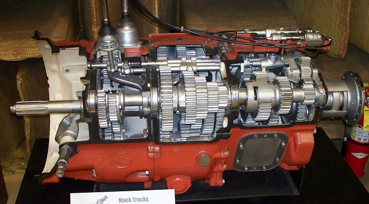

One for sale in the classifieds.   Are they good?  I suppose it is only for dual disc clutch and can't work without a bellhousing change in my B?
Classified listed as twin stick but has "B" on the case and that is suppose to be air shift?
Larry
The "B" is indeed for the version with the dash mounted air shift switch for the front compound to control low and direct.  The one pictured above has a stick for shifting between low and direct.  There is an interlock so low can only be used with first gear.
The other stick has the Mack Selectair valve for high, direct and reverse.
Good transmission.
With a few parts, changing some parts and some fab, it can be put into the race truck.
