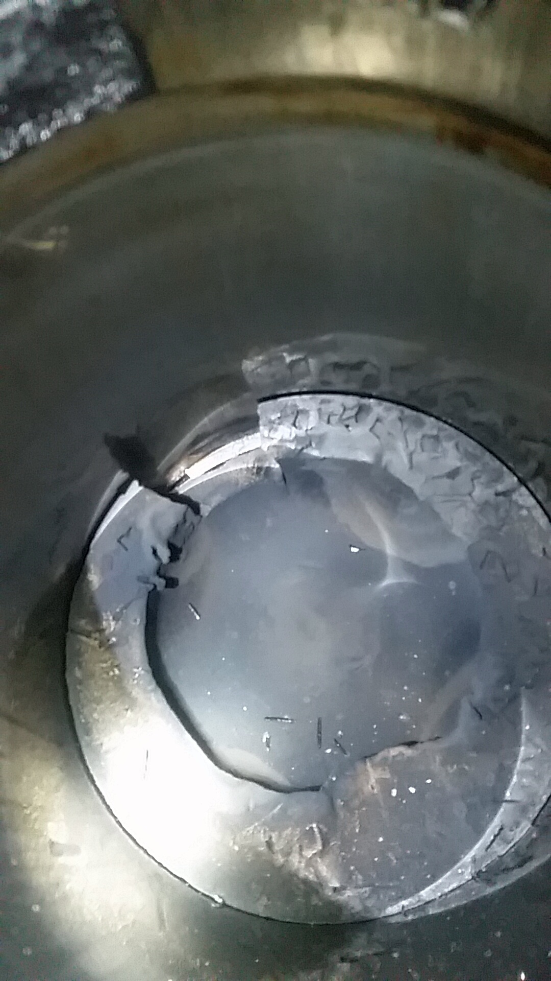

Hi all. Got our little MB torn apart with a confirmed cyl 4 blown head gasket. Sourced all the needed gaskets to do the job, but as the picture shows, I have more issues then just a head gasket. Once I source the pistons, (all are well cracked up) going to need the torque specs for the rod caps, I'd like to drop and check a main bearing while I have the pan off, so main bearing cap torque and I have a head torque procedure from 1973, but with the newer superceded gaskets, has the torque procedure been updated? Hoping someone can get help me out!

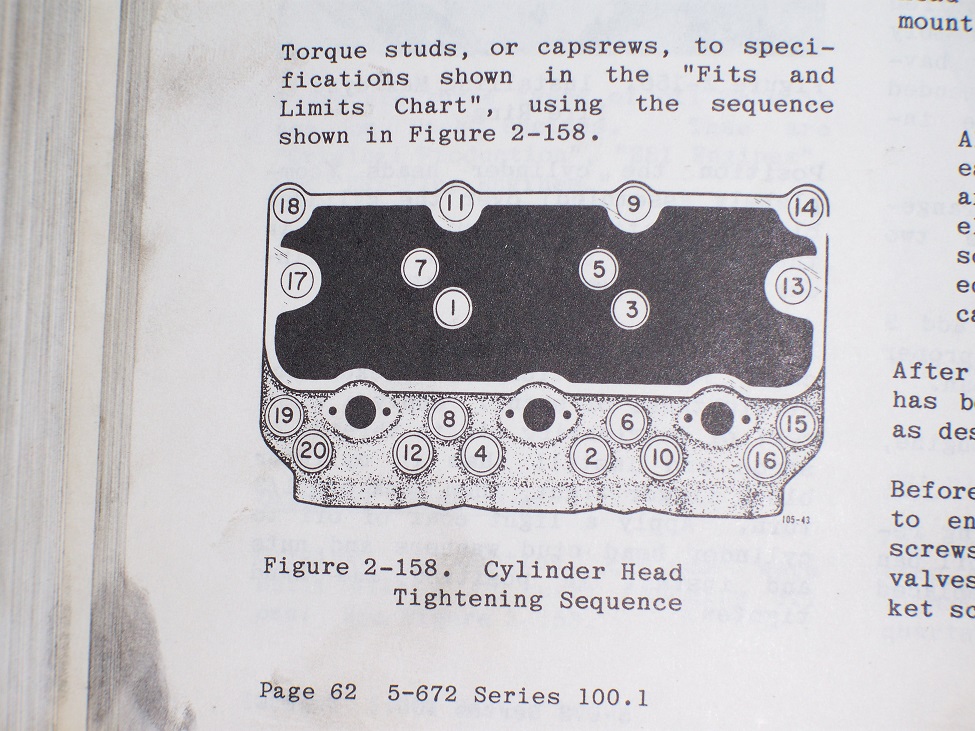

This is out of the 1977 Mack TS 442 book.  Sorry for such a bad view looking down the cylinders.
50, 100, 175 lbs on the head in three stages. 150 on the rod.  11/16 main cap 200 and 5/8 main cap 150.
