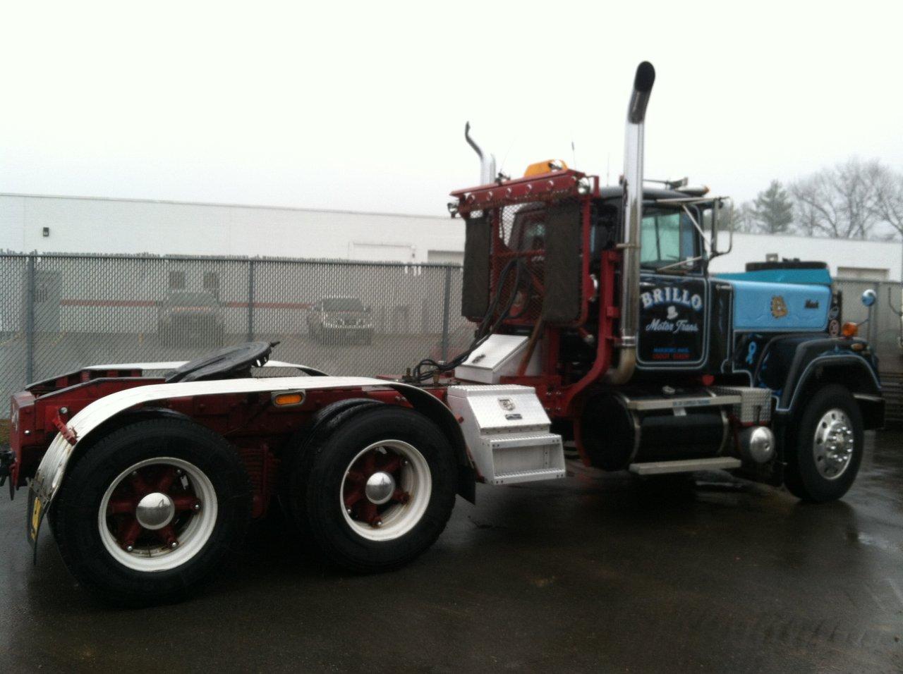

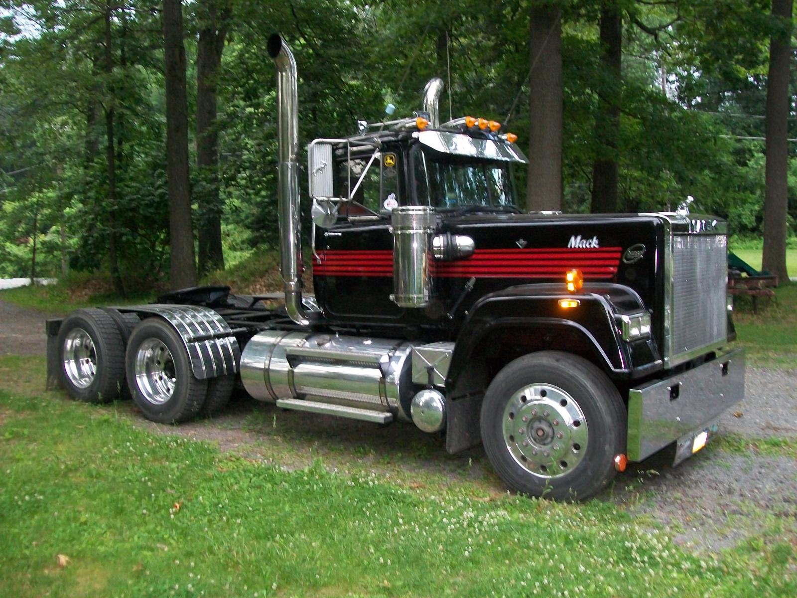

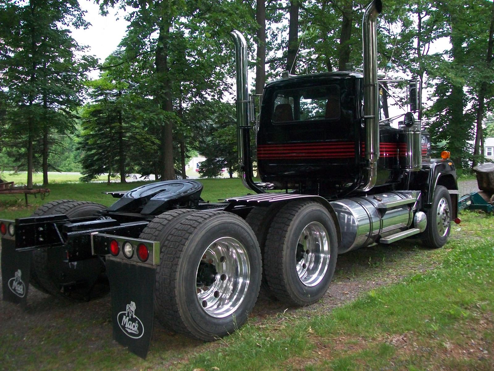

My truck has 7 reduced to 5 , no air ride , some pics to give you idea what it would look like
post-14252-0-20178800-1422055540_thumb.jpost-14252-0-77060200-1422055560_thumb.j
