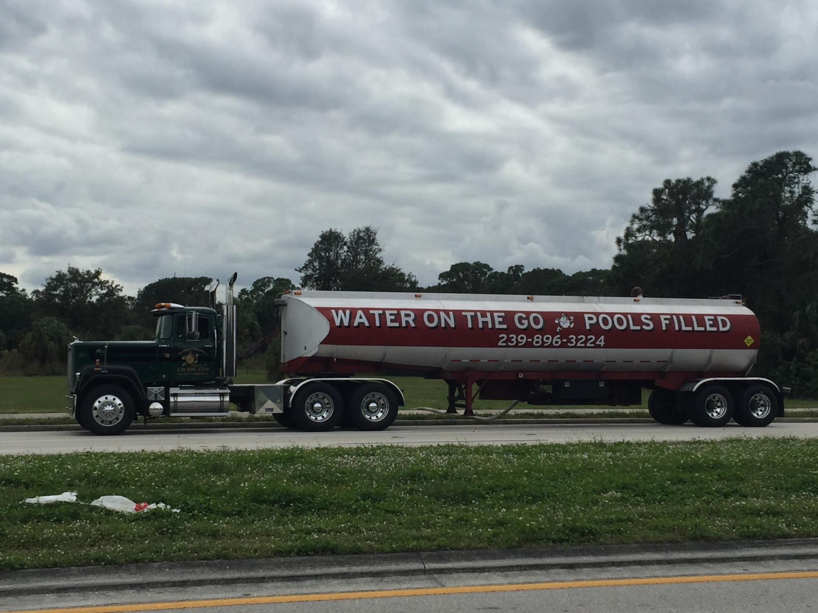

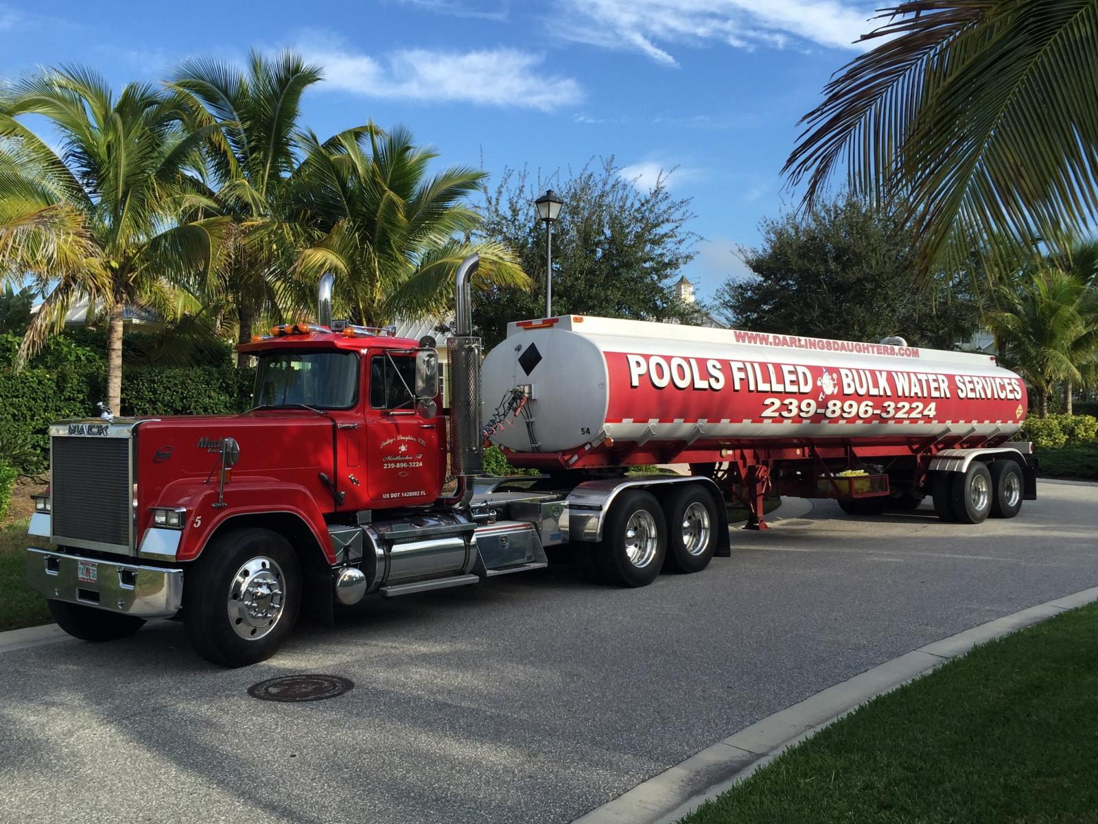

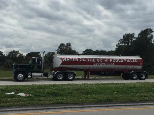

  11. Our 2 trucks working this week. Mine is the green one ( 88 superliner E6 pulling a 1970 fruehauf tanker) my dads is the red one (88 Superliner E6 pulling a 1977 Allied tanker)

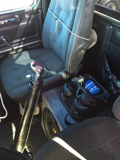

  15. Here is a picture of the sub in the middle with my old drivers seat beside it. I have a seats low ride seat in it now as you can see in the pictures in the first post.
  16. dds92780, the sub is a 12 inch subwoofer that I made a box for. its sitting on the floor with it slightly tapered up in the front and the amp is mounted on the back. The rears are 4.64 and with the 9 speed it does 75 mph on the top end. Gets 6 mpg all day. As far as the tractor total weight Ive never weighted it by its self but I would guess around 17k lbs. the truck is great and Ive replaced all kinds of parts on it. Just recently Ive replaced the clutch 2 weeks ago with a brand new one. I wouldn't be afraid to drive this truck anywhere! The truck came with no outside air cleaner. Some superliners did and some didn't.
