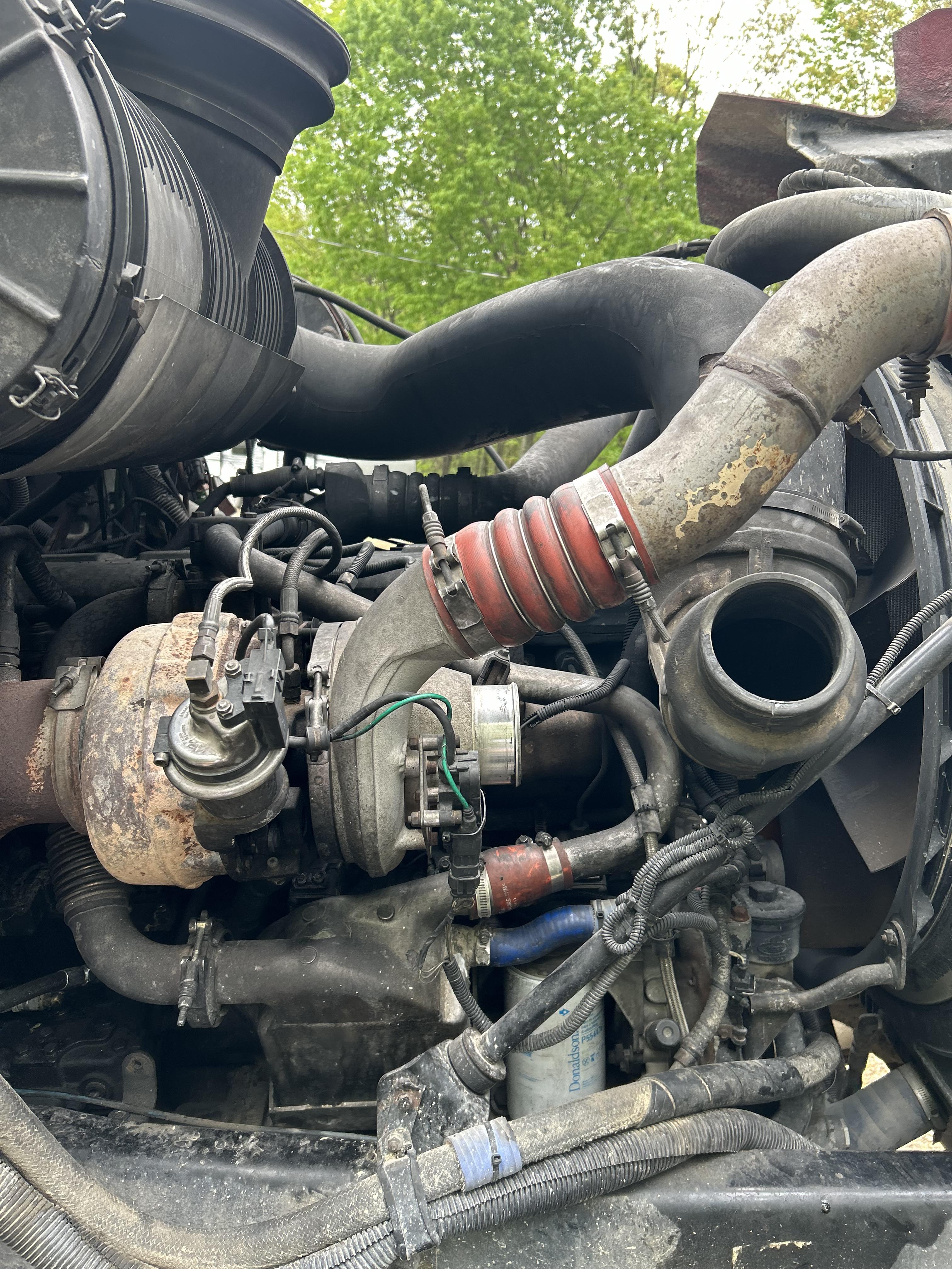

That vgt filter that has been removed doesn’t that filter the oil out of the air that runs to the actuator on the turbo or am I way off
It protects the "Control Valve" from "coking."
Buddy, its a filter,,  it filters all the bad stuff from the VGT actualter..  oil, dirt, what ever..  Yours is the first one I have seen with it removed..  and Ive worked on a lot of them,,,
Ya that’s what I thought I can show you how they rerouted the air lines around it my thoughts on all this was hienz ran down all the turbo info and prices I’m grateful I got good pics from you on what it’s supposed to look like now I can put the diagrams to the pics and make some sense of things.. so my options at this point are new compressor because I honestly believe that all the oil in the airlines is causing a lot of the problems granted the damage is done but if I run clean air start replacing air lines get that filter I’ll have to get the whole set up only thing still on the block are the holes where it was that could prevent further damage to the vgt and everything else that requires air to operate correctly and might prolong the turbo shittin on me for a little longer until I can swing a new turbo so far I’m down around 9000 suspension tires brakes steering gear box
I cut the (new) suspension off an old hawker truck about in a field took 6 hrs took 6.5  to 7 days to get bad off and out good on .. am I not clear on what that fitter does am I just missing the boat ? It stops oil and shit from getting in the actuator on the turbo ?

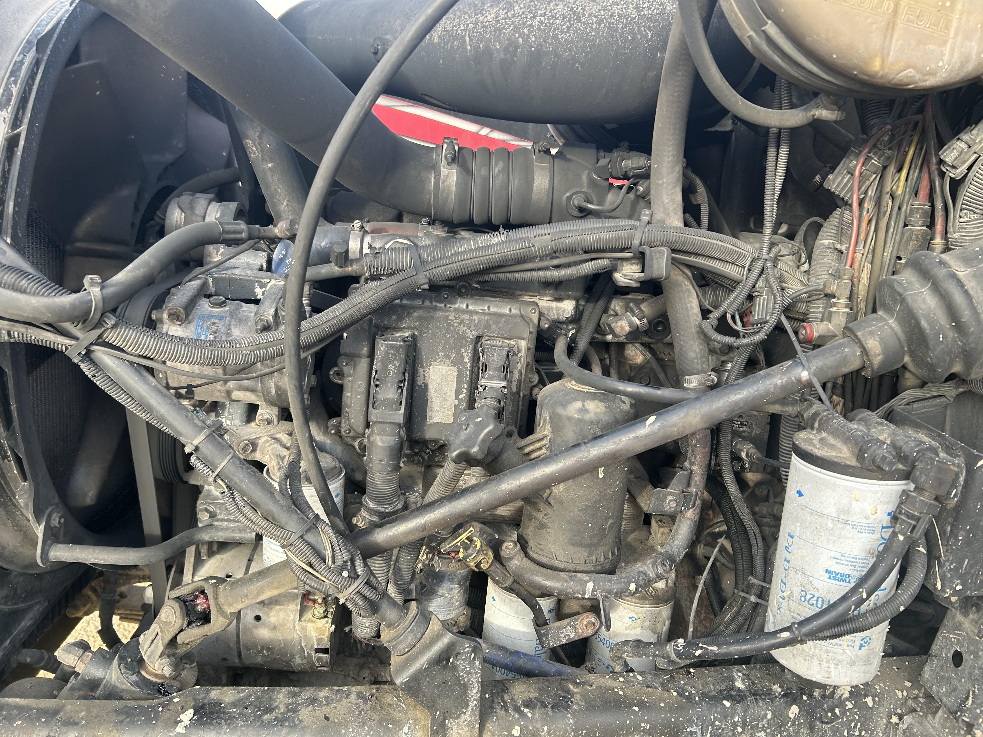

Your not the only one that hasn’t seen one I had said a day or so ago the guy that works on all the trucks where I’m leased on hadn’t ever seen one either all those superdumps are like 07 08 newest is a 22 some have mp8 in them not sure about the rest I can’t see diagram control valve is the one with the silver barrel on top that feeds the actuator on the turbo correct? When they removed that they just looped the airlines around thru this I’ll send pic and down the frame somewhere haven’t found its destination yet control Valve is tucked behind steering arm see the valve with the red hose coming out the top red deal on the front of it they just made a loop from control valve to that and out agin towards back of IMG_5336.thumb.jpeg.a5b13468a40e775e30bc4352bc6e7dec.jpeg
I didn't think to look yesterday, was focused on the turbo, but your truck did have a VGT filter, same spot that I sent pictures of before. Interesting someone would remove it. I definitely agree in fixing smaller items first and saving the turbo for later, if it works fine enough there's no use in going that much in the hole.
