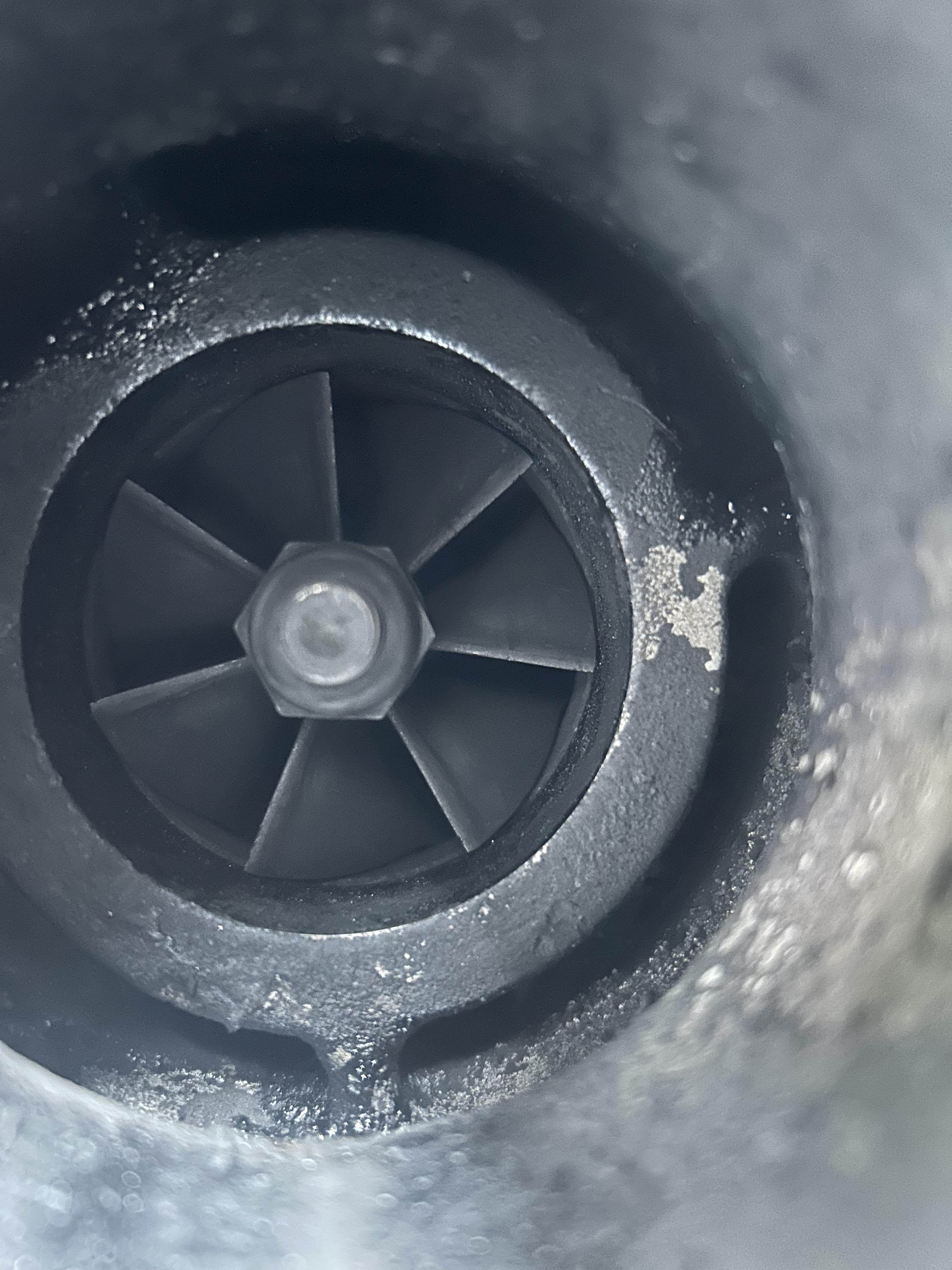

This turbo has no nozzle It has variable vanes! Check to make sure it is stroking! Yes it can still be electrical! You still may have to free up the shaft and pin! Make sure it hits the stops top and bottom!

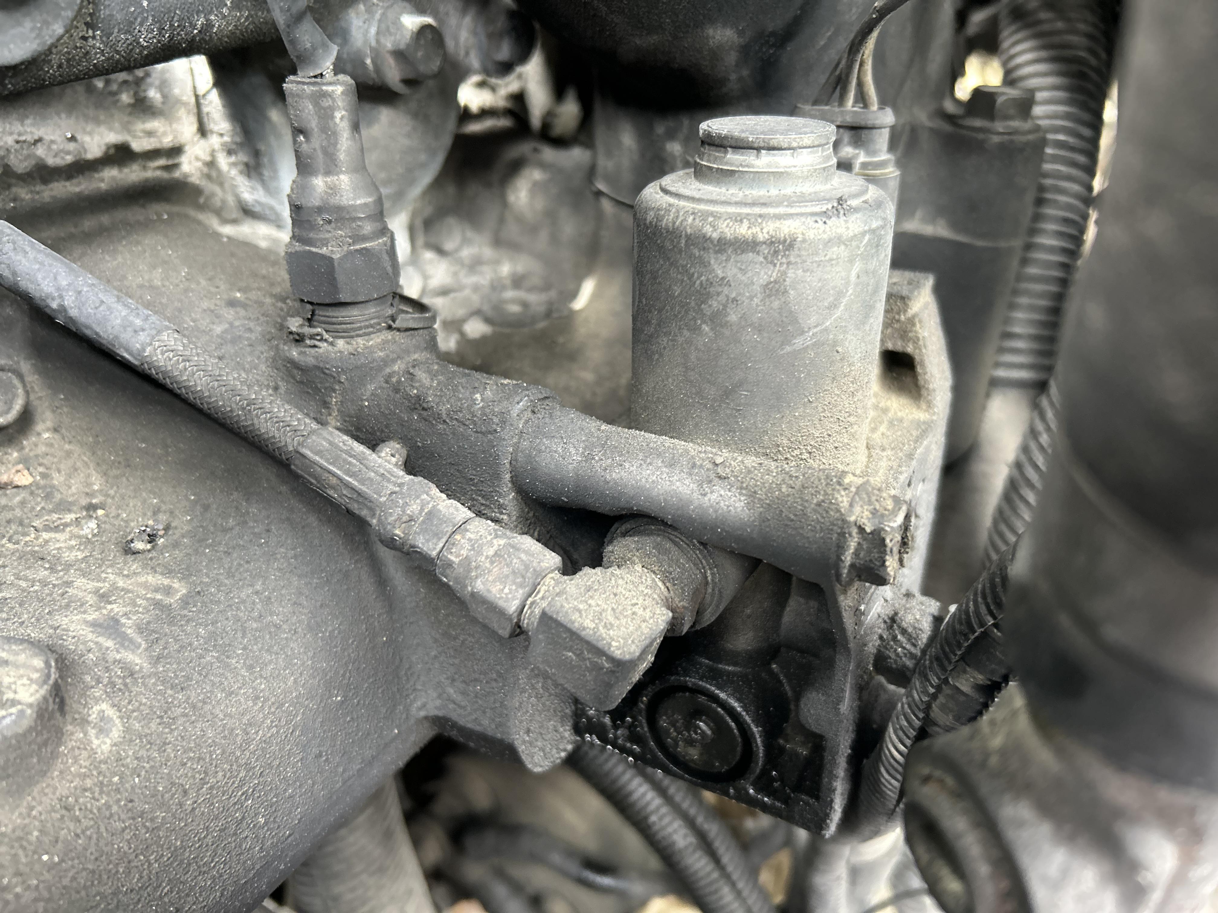

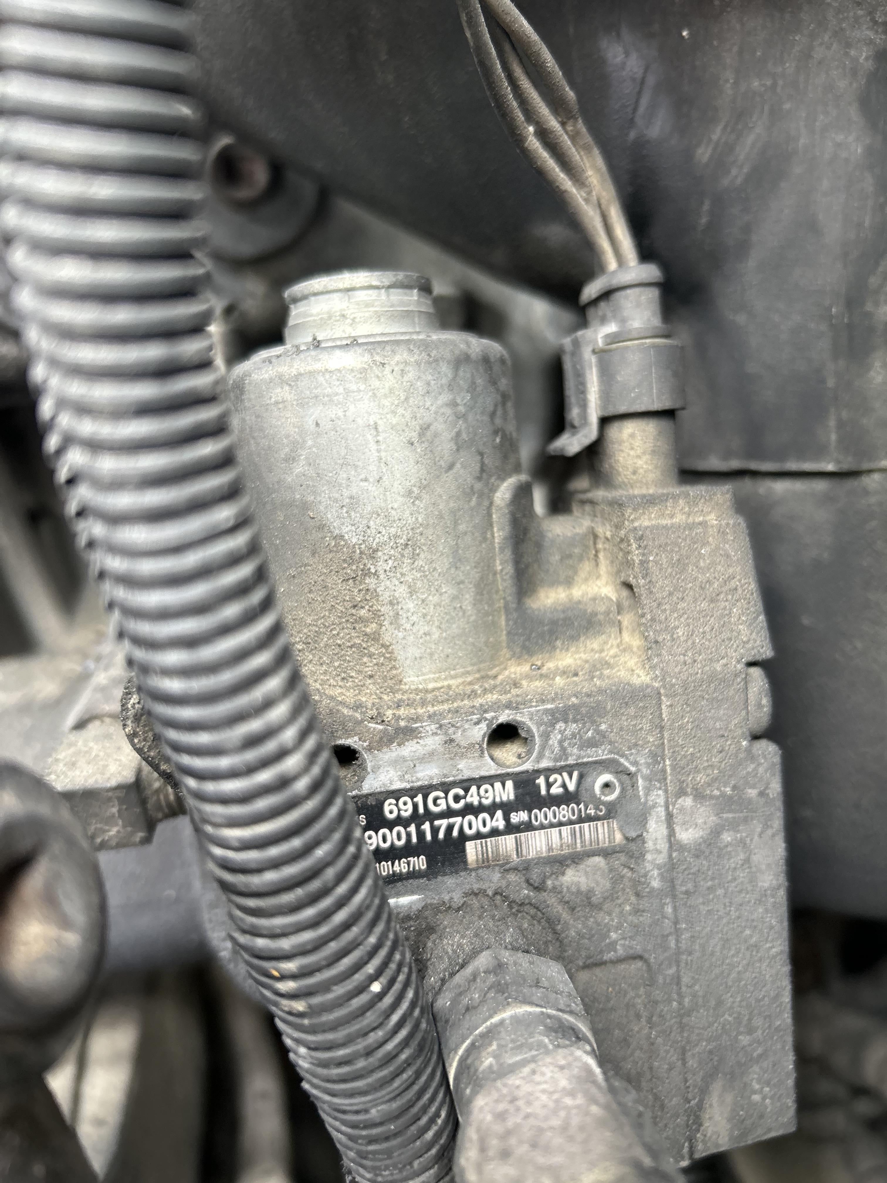

So if I’m right about the vgt it has the silver little barrel on top air lines running into it on drivers side it has a diaphragm on the front facing headlights that direction anyway … ther is oil coming out of that diaphragm seals are shit on the compressor I’ve takin it apart cleaned it whole nine but I’m wondering if that oil in the air lines isn’t affecting the way the vgt is functioning ??? IMG_5318.thumb.jpeg.a134c0198cd97602e60d23e2423a4882.jpeg

Follow the plastic line that leads to that controler back down the VGT filter should be directly below it near the oil pan!  also  There should be a valve on the fire wall to shut it off to change that filter!
