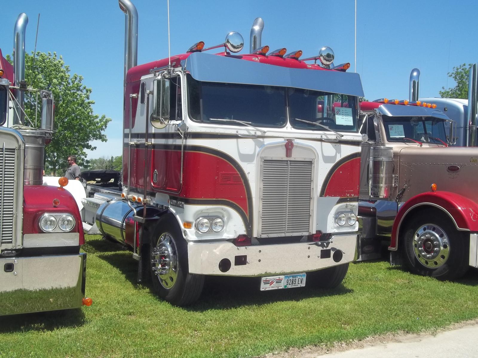

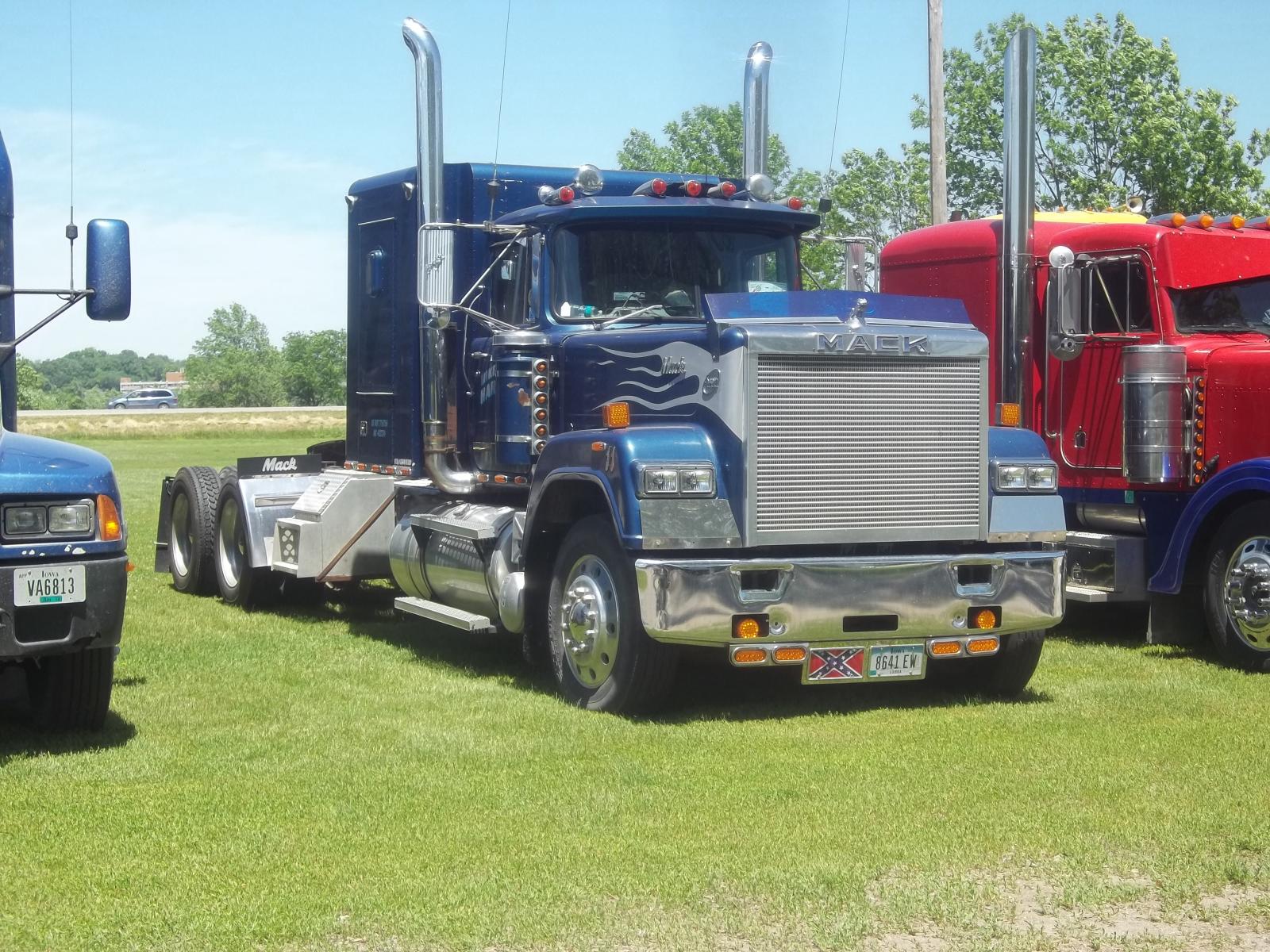

Those dual stacks sure make the cruise liner look better and meaner!
yeah,but they were a pain in the ass from the word go. Had to refab a RH bracket into a LH one.robbing the bracket off the donor truck was a fight all the way. Also both brackets had to be modified from having the muffler "cradle" to straight pipe mounts,then fabbing up the pipe and elbows,getting everything to fit,started out piping the 4 in off the turbo into a 5 in T,but that didn't leave enough clearance,so had to go with a 4 in Y,then step up to 5 in,then 6 in to the elbows. Had to drop the LH tank to drill 2 holes for the bracket . Ended up breaking 2 of the 3 straps,of course these were a size that Volvo has made NLA,so we had to fix the old ones . Then had to notch the cab back for the LH elbow. Got everything all put together,and the kid had measured wrong,stacks were 14 ft., so had to take them back off and trim them, but they are on there now and they do look good,nothing looks cobbled and sounds better for sure.

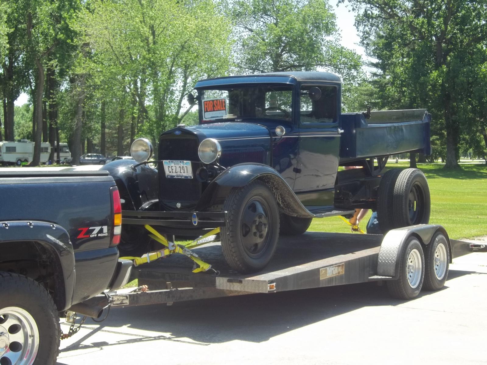

I like that small Ford dump.
It too reminds me the trucks produced here in Russia on the Ford's plant.

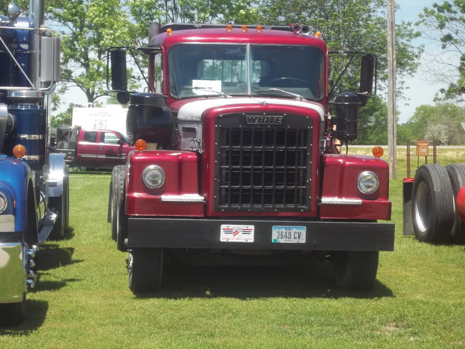

Thanks for sharing the photos. That KB International is much larger than any KB-series I have seen in person. KB-15? KB-18?
It's a custom job. The chassis is from a IH Westcoaster,which he had previously owned,sold,and went thru 2 other owners. The last owner took the cab and sheet metal off it and put on a newer Pete frame . Dave found out about it and bought the remains back. He then took an old KB6 that was one of his Dad's old trucks and combined the 2. The hood was stretched and grille shell widened and modified. It has a NTA380 that had powered the Westcoaster,7 speed main and 4 speed Brownie,and Freightliner air ride.It will scoot right down the road. The owner is a pretty cool old guy, At one time,he had a '75 Cruiseliner,that was one of Mack's show trucks at the International Trucking Show in CA when new,it was KT Cummins powered.
