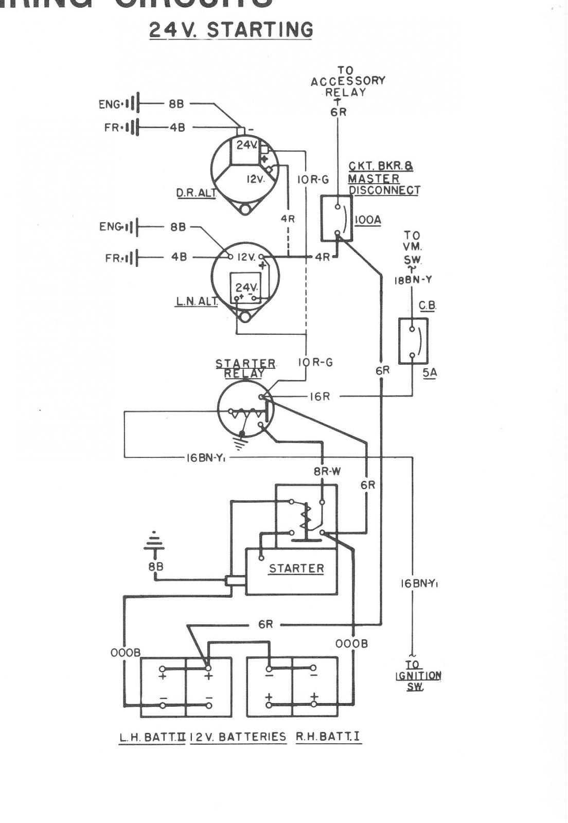

On the MH there is a box above the drivers tire with the master kill switch and the starter solenoid. Mine is 24 volt cause it has an E9. Would anyone have a diagram I can get a copy of. I need to rewire it, or can I just some how leave it out and convert it to 12 volt?

I just did mu superliner in august 24 to 12 was fairly easy needed a 12v starter and volt meter had borrowed a shop book from the construction co. that I used to work for and it had all mack elec. combomations listed on one schematic, if you can get to a dealer you should be able to copy what you need.

anyway, to answer your question on modifying here are some basics but not everything....
adjust interconnections between batts
change starter motor to 12V by replacing it..
the alternator will need to be configured to supply only from 12V stud, or replaced.
24V start needs less amps and usually has smaller cable but drawing shows Mack has installed same 000 cable on both types, saved you some money.
the MH electrical system manual can be found on ebay, given your need it may be a good investment before you start ripping the truck apart.
I have attached 24V info from the Mack manual to help you find your problem, if you have a 24V system.... if you have 12V I should be able to put the drawing on my scanner

post-10384-0-94419300-1384578969_thumb.j

With respect, that's not accurate. 24-volt starting was standard with E9 V-8 powered Mack Trucks, and for a very good reason. You want the "kick" of 24 volt starting, the preference worldwide, for turning over a 16 liter engine, particularly in cold conditions.
You are doing yourself a disservice if you change an E9-powered Mack truck's starting system over from 24 to 12 volts.
Call Watts Mack with your truck's unique model and serial number (located on the vehicle identification plate) and allow them to order you the correct part.
Note the E9 engine options below, and note 1.
