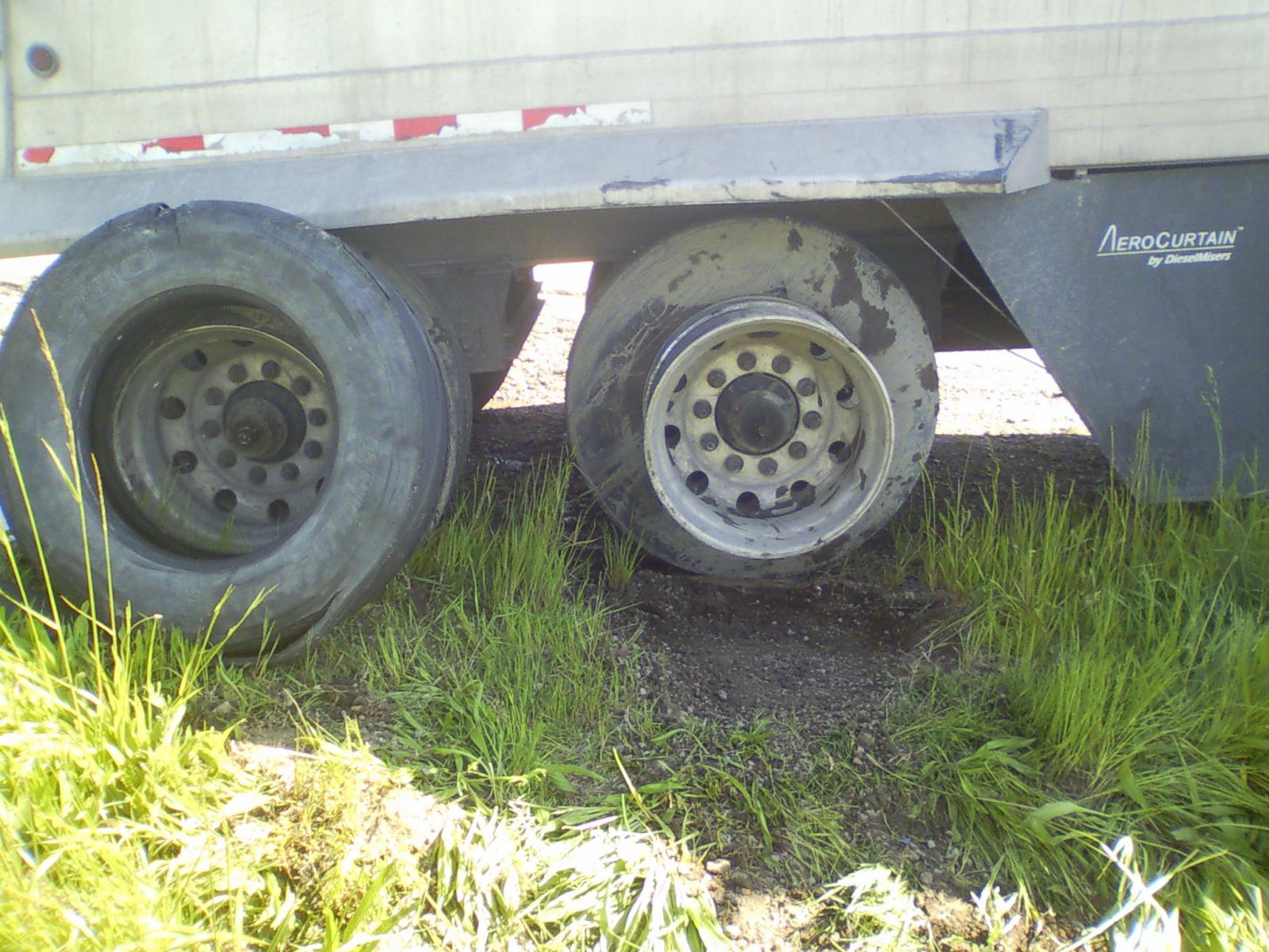

...blowed a danged trailer tire. Last time it was the front right inside...and it tore the heck out of the side skirt brackets & cables when it came apart. Limped 'er on up the road about 2 miles to the next get-off and found an old vacant gas station to wait for a service truck to bring me a new tire. While I waited, I removed the side skirt on that side (since it broke the weld on the rear bracket and sheared a cable) and stowed it on my catwalk for the ride to the shop (where they handed me a new bracket and cable and sent me on my way to put it all back together myself....)
Today, it was the front right outside tire that failed in spectacular fashion. I was going to limp on up the road to the next exit, but a section of tread was still hanging on flapping around, so I had to pull off onto the shoulder. I pulled the pair of 30" tire spoons out of my side box and removed the tire. Tossed it up on the catwalk with a chain to secure it and I got the heck off the shoulder. I HATE sitting on the side of a busy highway, and I won't hang out there any longer than absolutely necessary.

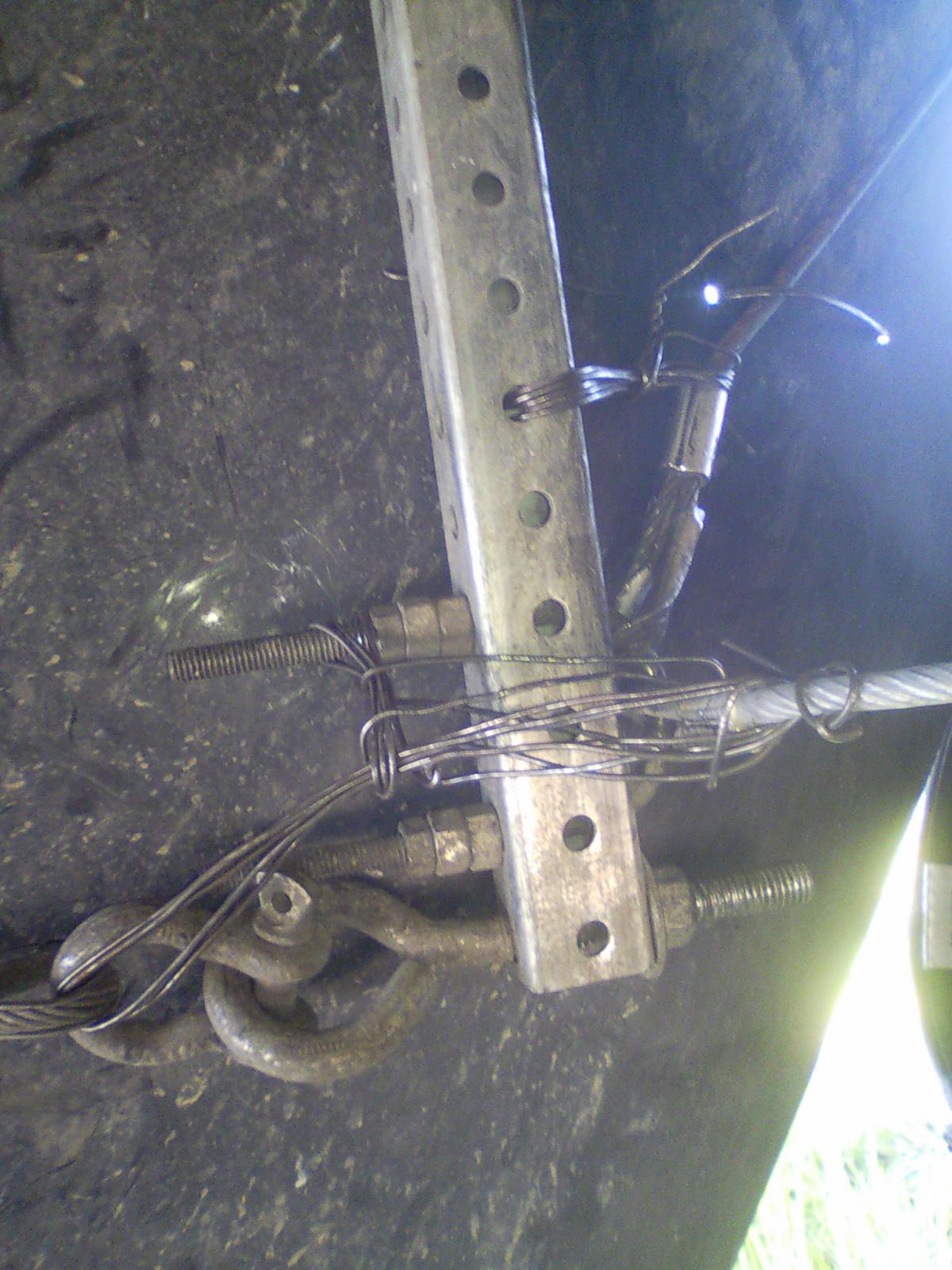

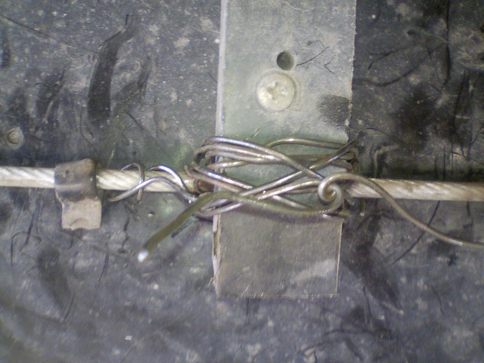

When I got up the road to the next exit, I crossed the road and found a wide spot on the shoulder of the get-on ramp to sit and wait (there really wasn't anything else there at that exit....just a seldom traveled state highway....might have had 3 cars drive by during my hour long wait). This time, though, it didn't obliterate anything on the side skirt...just stretched a couple cables and knocked some of the clamps holding the side skirt to the supports....nothing a little bailing wire couldn't fix.

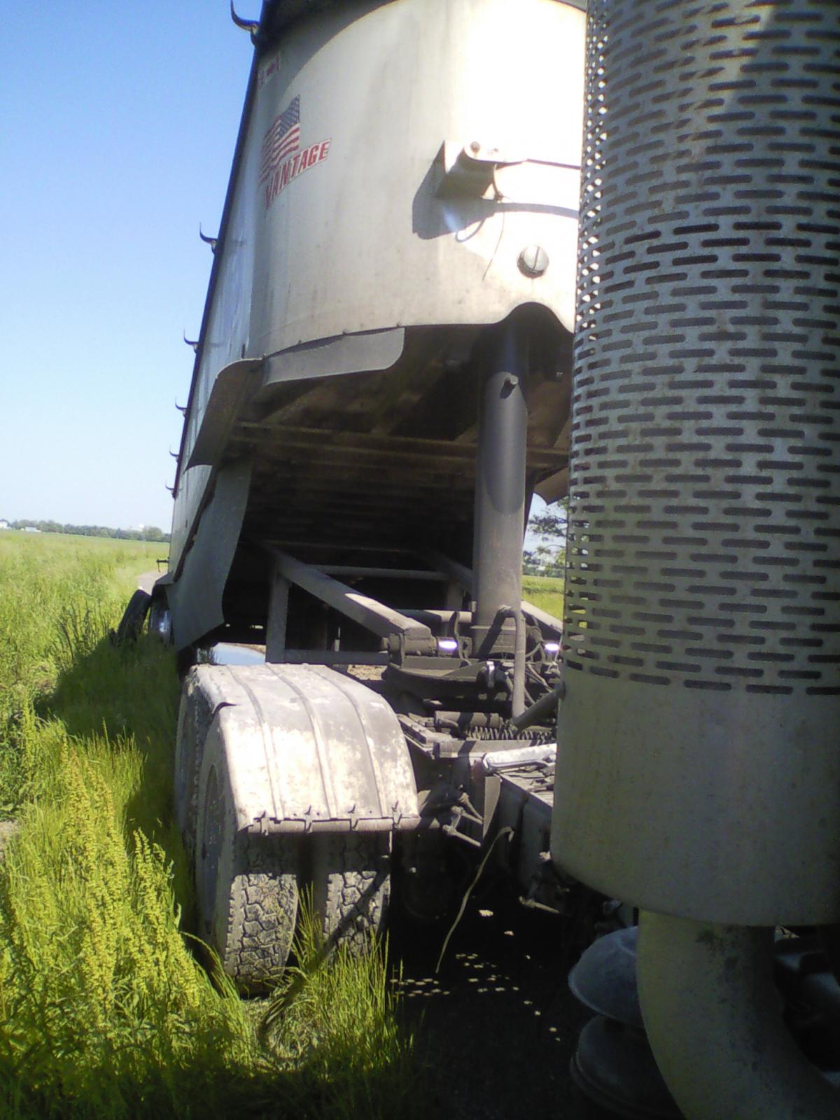

One of the benefits of having a frameless dump trailer....no need for a jack if the blown tire is on that front axle. Heck, I was surprised the tire guy even removed the rim to mount the new tire...I would have just slipped the new tire on, aired it up, and been done with it.
