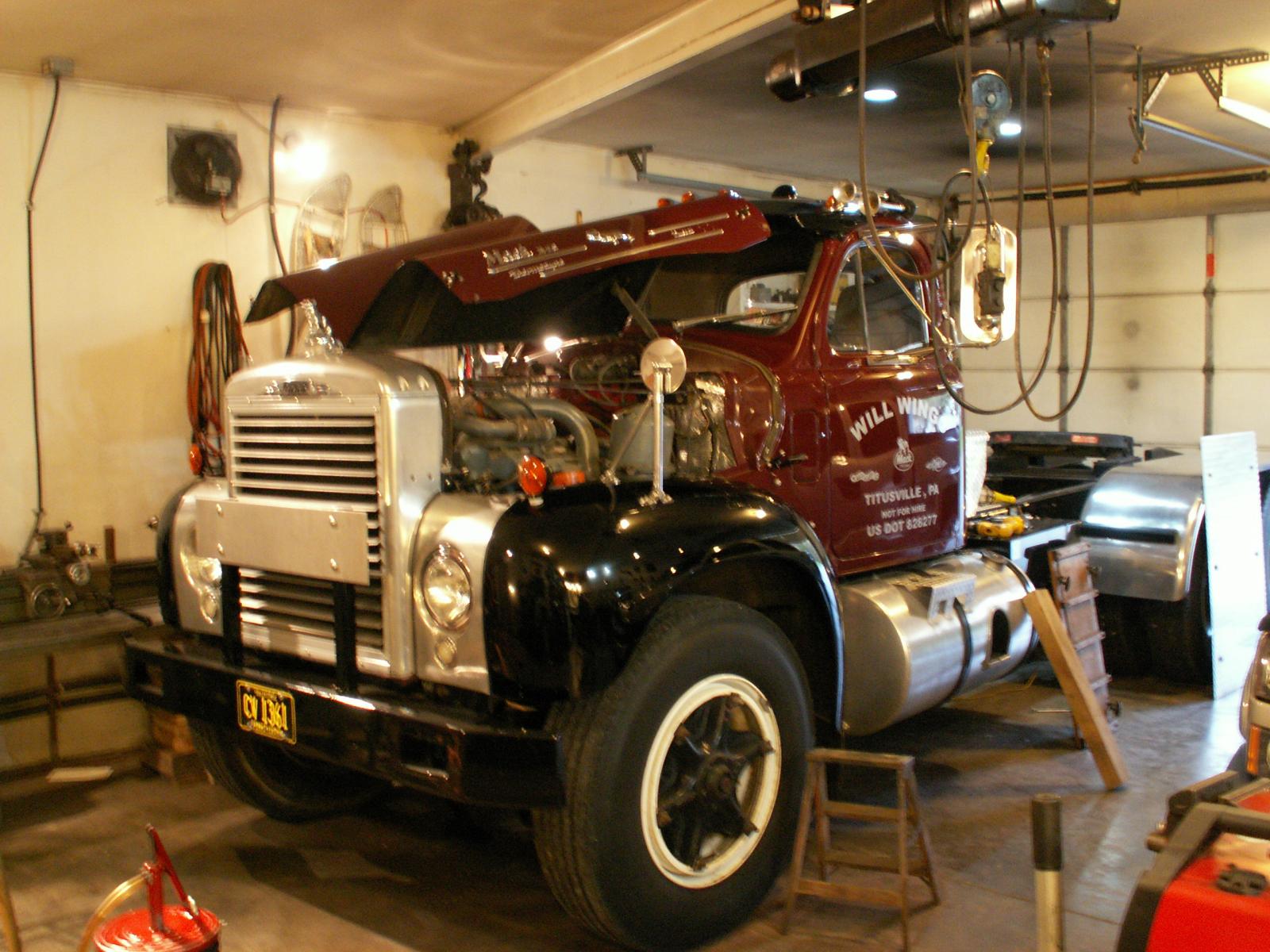

Mighty nice looking B you have there. Why do you have to send a oil sample off?
mike
The oil analysis tells you if your engine/transmission/rears are making metal and how much and even what type, eg..bearing metal, gear metal, etc...alerts you to problems before they become expensive problems
The kick stand is for me-- I'm 5' 15" and still can't reach from the ground over that fender to the bottom of the lubrafiner to open the drain cock.
I will post a copy of the oil results when it back- Monday or Tuesday.
