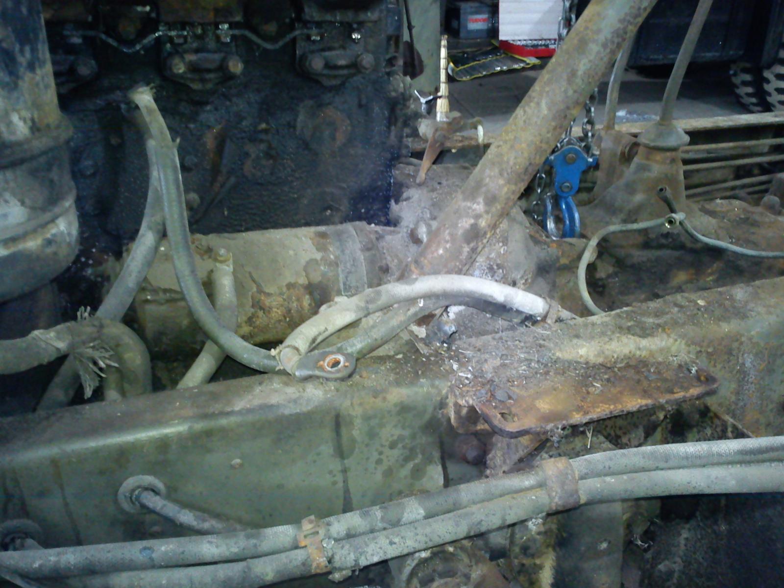

There should be a serial # tag inside the passenger door on the seat base,if this is missing,the number is also stamped on the frame, right side within the back 18 inches or so of the frame rail.As long as the frame hasn't been chopped off of the 5th wheel isn't covering it up,that's where to look.I have seen it stamped on the left side in the same location on some of the older L's,also. it should read something like LJT2D1234,or LJSW1234.
Good luck and keep us posted.
Hubs look 20's so I suppose it's of light series so might be LFSW.
Mike, correct me if I think wrong way.
By the word, NR chassis has number at the front of left rail, behind and a bit in front of Pitman arm's shaft.
Haven't heared about the same location on L-models, frames look mostly similar.
By the word, NR cassis has number at the front of left rail, behind and a bit in front of Pitman arm's shaft.
That's good to know,I'll have to check some of my L models to see if it's stamped there too.Only place I've ever looked on those has been at the rear.I always thought that it was a poor place to stamp the number as frame modifcations often covered or removed the number.
I also surprized when learned L's have it at rear.
You can see the number stamped right above the cable if make the pic large.
Sorry, haven't found a better one in 'puter.
As far as I know all NR's had it this place, NM I have also got it stamped there, although it has another frame design of uppered front end to clear front drive axle.
