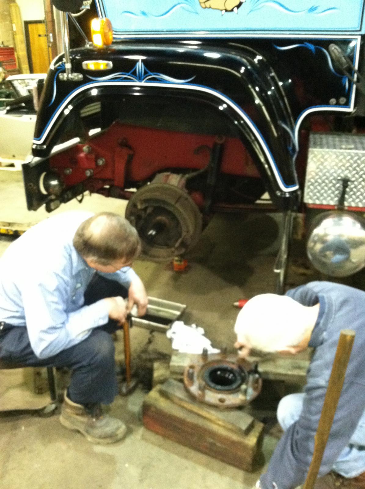

Have an 89 Superliner RW753, we where working on the front this weekend and had pulled the drum to replace studs fro front wheel. So as we where inspecting things we thought the brakes looked to good on the front, so I climbed in hit brake and low and behold they did not move. Went under the truck and pulled lines off valve under bumper put air to line to the cam and the shoes moved. So now we need to reace lines back and find where the issue starts. Any help appreciated in sending us in the right direction
